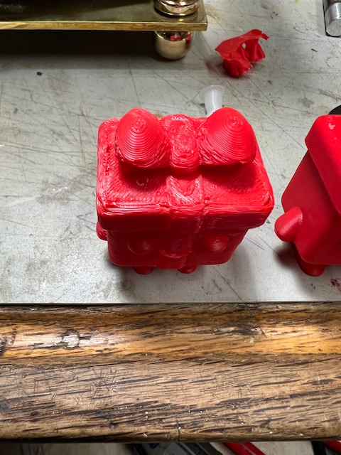

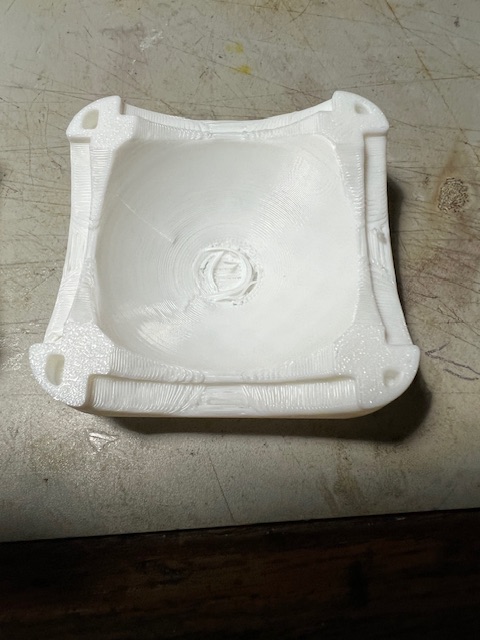

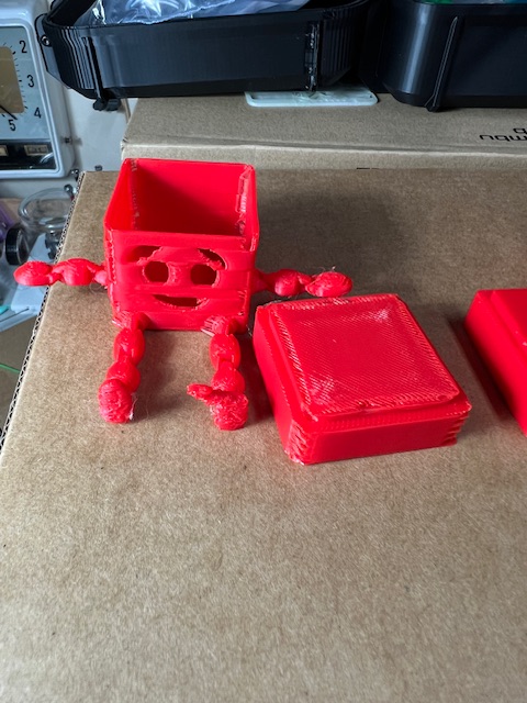

Hello, For 6 months it printed well. The print quality is poor but only when I use the AMS. I had the original AMS that came with my P1S and it had poor print, it’s fine if I use the external filament. I purchase the AMS 2 pro and had the same issue, I replaced all the PTFE tubes from both AMS to the printer, I also replaced the filament buffer twice. I’ve checked to make sure my software is current. see the pictures for the quality of prints.

Using AMS
External but same spool as before print.
This model looks like it printed upside down (from the photo depiction), yet no obvious signs of support material being used.

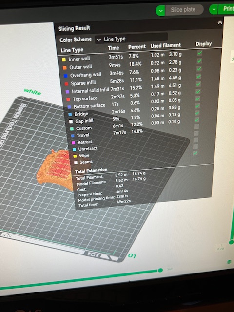

Can you share a screenshot from the Bambu Studio Preview tab, from under the build plate and show the “Line Type” view?
Uploading: image.jpg…
Here is the screen shot.
From under the build plate, scroll the view so it is upside down.
I still cannot see any support material.
If I am correct, this is the reason and not the printer or AMS.
Print on its side.
Use a brim.

This is using AMS
This is same spool but external.

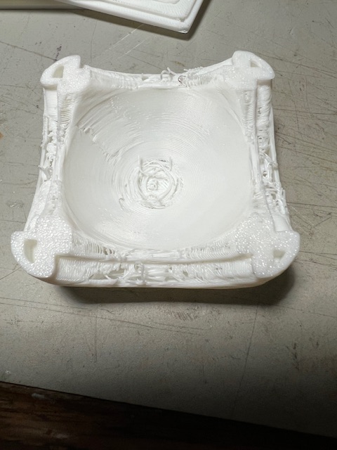

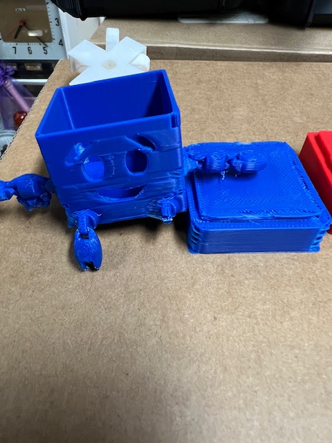

You should see when I use multiple colors, not good. That print was with a brand new AMS 2 pro that I bought last week.
The original AMS print was no better for the few weeks before. I did have months of great prints when I first bought my P1S with AMS

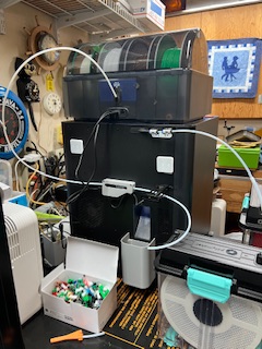

Have you made sure there are no kinks in the PTFE tube, that the PTFE tube has a clear path with decent curves to travel through?
Have you moved the spool to a different slot, purely for testing reasons.
If this truly is an AMS issue, rather than external spool, and two different AMS units of different types, it can’t be an AMS issue (as two AMS units are not going to have the same mechanical problem), it must be a placement issue.
If the AMS is up against a wall, it may affect the travel of the filament through the PTFE tube.
The logic I am working on is there is something making it difficult for the filament to get from the AMS to the printer.

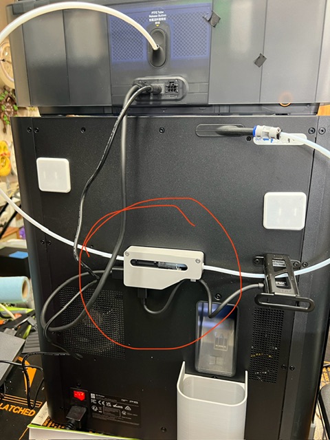

If after checking these things and it still persists, share a photo of the printer and AMS together.
I cannot upload my video, I’m using an iPhone.

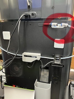

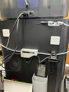

Have you tried without the additional coupler you have on the inlet and go straight into the inlet?
That’s quite the feed loop. You might want to shorten that ptfe from the AMS to the buffer, and Malc is correct, bail on the extra coupler.
I think you should invest in the 4way splitter or print one. That’s a wild setup.
Thank you for the help, I shortened the PTFE tube coming out of the AMS and removed the extra tubing piece that is connecting to the back of the printer.

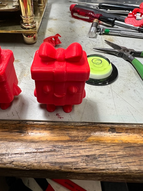

Print using AMS
Print using external printer.
Same Bambu labs PLA, both dried in Polymaker.

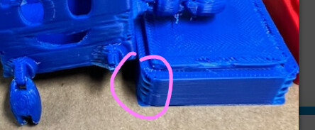

This repeated corner defect is also very curious
Nothing obvious to me, but part of that almost looks like it’s heat/cool is way out of whack, but enabling AMS doesn’t really effect that.

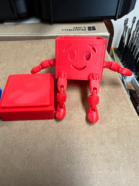

Hello Johnfcooley, I just did one of the prints AMS and external here is the prints
AMS
Non AMS

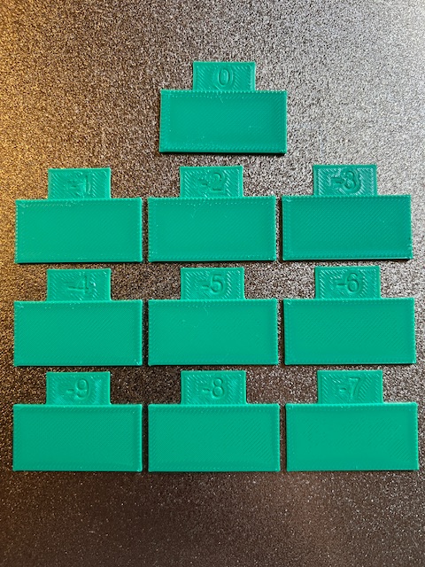

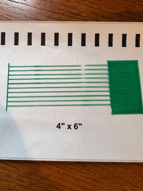

Thanks for the post, I’m not very tech on 3d printing. I did the flow rate on my machine using the AMS 2 but the prints look exactly the same, none look better or worse than the other.
I thought that was weird.
I did another calibration that I did notice a different and inputted the setting that looked the best.
And I updated the value. I’m going to do a print and see how it looks with the new values.
I’ve updated the values as best as I could with the test prints. Since I did that it is working correctly with the AMS 2 Pro. I’m leaving it as it’s finally working.
