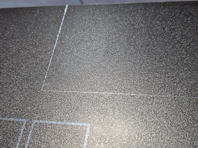

Possible bug on H2D HOME button - can damage PEI
Okay, to make a long story short:
I was doing some maintenance on the H2D and trying to resolve my first layer print quality issues - which I posted in another post/topic here.
The scenario,
  1. Using the touchscreen - moved the toolhead to the max -Y position. By chance, I had placed the tool head above the air filter near the right side.
  2. I raised the bed to the maximum Z position so I can clean underneath and verify that some screws are not loose. The tool head is tucked away above the air filter area.
  3. Done cleaning and pressed HOME on the touchpad and this is the problem:
  4. The bed did not move and remained at max Z height position.
  5. The tool head moved out of the air filter area along the +Y and then moved X, back to -Y.
  6. I quickly unplugged the unit.
  7. My PEI plate has a deep scratch. Luckily, the print head is not damaged or bent.
  8. So watch out when pressing the HOME button, make sure to move down that bed manually first.
    I submitted a ticket with Bambu, and they gotta put something in the firmware to prevent the HOME button from moving the toolhead along X and Y without moving the bed down first.
Here is the picture of the mark - hard to capture after I washed it, hoping it was a superficial scratch…
I think it has happened various times across multiple of my bambu machines… I don’t think they are going to fix it (but I do hope that at least they try to).
My suggestion is that, whenever you do home or other operations, make sure that the plate is empty and you leave some space for it to go up and down… Because you can’t trust the machine to do that unfortunately.
This is one of the scenarios where it happens. I’ve reported it so many times that I’ve stopped submitting tickets altogether.
Support also told me they wouldn’t fix it and showed no concern for customers’ damaged build plates. If you open a ticket, they’ll ask you to reproduce the issue on video—so be prepared to risk another build plate.

A quick and disappointing update on this “bug”…
  1. Bambulab tech support implies this is by design and that the problem resulted from user error.
  2. I replied that I completely disagree. The HOME function implies the printer will revert back to its home position regardless of its current state unless there are abnormal obstructions or abnormal behavior. Instead, the HOME function will unconditionally initiate a return to the home function without any checking.
This reckless implementation will result in many accidental damage with the fault inadvertantly being pushed back to the end user with certain damage to the build plate, potential damage to the hothead, potential damage to the toolhead, and potential damage to the heatbed.
As an analogy, I have flown drones from different brands the funciton RTH (Return To Home). The device will safely ascend to the preprogrammed high by the user and initiate a return. Should there be obstacles, the drone will stop or go around the obstacle when it can. What Bambulab support is saying is similar to this but the device will initiate movement without checking, and the responsiblity of the end user to position the device in the optimal position. This does not sit right with me.
I will wait for their response and hope to hear a more reasonable and practical answer. I will seriously rethink my personal and business investments with Bambulab at home and at the print farm and seriously consider switching to a different manufacturer if need be.
Mind you, I never asked or expect any freebies or replacements. This is more in response to what I feel is a strange and unreasonable response.
In closing, please take extra precaution when using the device. Aside from this issue, I do not know what other inconsistencies to expect.

When the stepper motors have been released for some reason, the printer cannot for 100% know where it is.
You will notice a warning, every time you move an axis. It then proposes to home the printer, but you can also ignore the warning.
To home the printer it needs to find the XY zero first so that it knows where the center of the build plate is when it zeroes the Z axis.
It cannot start with Z because it has no clue where it is. Bringing Z up at the current location is giving the risk that the nozzle is missing the build plate entirely and you might damage a lot more than a build plate.
They could introduce a motion that first lowers the bed a couple of mm to prevent your issue, but when the build plate would be already at the bottom, that might damage the Z belt, although they could do that motion with a very low current on the steppers so nothing would be damaged.
You are probably one of the few people that raises the bed above the nozzle tip and executed a homing from that position. Something BBL developers didn’t anticipate.
Let’s hope they will adjust the homing motion in the next firmware update to fix this.
In the meantime they could have been a bit more tolerant and at least replace the build plate and possibly the nozzle in your case.
This is a learning experience for BBL also.

It’s impossible to do with current bambu hardwares
That’s disappointing to hear actually…
What do you mean?
They can’t run the Z-axis stepper at low current?
It might not have sensor-less homing, but the stepper driver should be able to run a couple of mm down in low current and when it would reach the bottom, it would skip steps instead of damaging something.
I would say that a simple end stop sensor of any kind could have been added to guard the lower position of the bed, but in my opinion the homing process could be improved with firmware also.
It doesnt solve the XY damage, but for adjusting the Z first a simple limit switch would prevent issues. When I was building CNC routers these were very easy to incorporate, Im surprised the H2D doesnt have them.
This is what I mean!
They don’t lower the bed first because there is no sensor (limit switch, hall sensor, etc.) to detect the bottom limit.
This is purely cost saving. Because it needs a sensor, wiring, an interface on the board to connect to and additional labor to assemble it.
It also adds an additional point of failure, which then becomes the responsibility of the manufacturer.

It needs a physical Z limit switch I think. OP’s problem is caused by that.
Bambu uses the loadcell on toolhead instead of on bed. So the only way that the bed can know where it is, is to, touch the nozzle first. Either going slowly up or down would fail in this case. Z is very hard to do sensorless detection due to extra weight.
I think this is a design flaw caused by the lack of physical switches, nothing too much can be done with the current hardware. If it goes up too much it hits the nozzle, if it goes down too much it hits the bottom.
My suggestion as a user? Always make sure that the bed is in a reasonable place before doing home…
