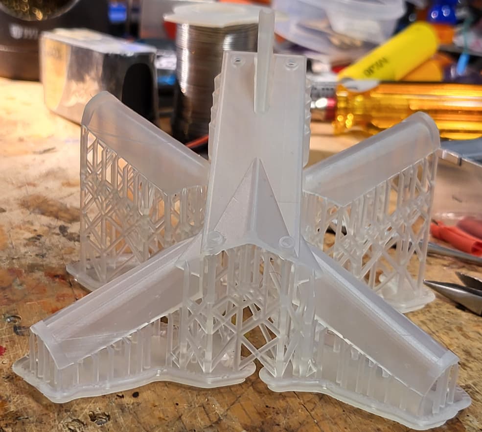

Those supports are for a resin printer. They will definitely not work for FDM. You have to get rid of them. You can orient the print vertically. The reason it’s tilted like it is, is because for SLA printing you do not orient the model orthogonally with the build plate. SLA is opposite of FDM, the prints come out better when they’re at an angle that minimizes how much of the model is in contact with the bottom of the resin tray (because after the laser shoots the resin, it has to be separated from the bottom of the tray so the next layer can be printed, and a large surface area is a large separation force, and that can distort the print).
I’ve had a SLA printer in my arsenal since 2015.
Look similar? :slight_smile:
That’s a canopy for a small FPV racing quadcopter, AKA a “drone”.
Looks horrifying, but the supports all come to a small point before they contact the print. They mostly pull right off. It’s actually a pretty satisfying process, ripping them off. Kind of like the satisfaction you get from popping bubble wrap. :slight_smile:
