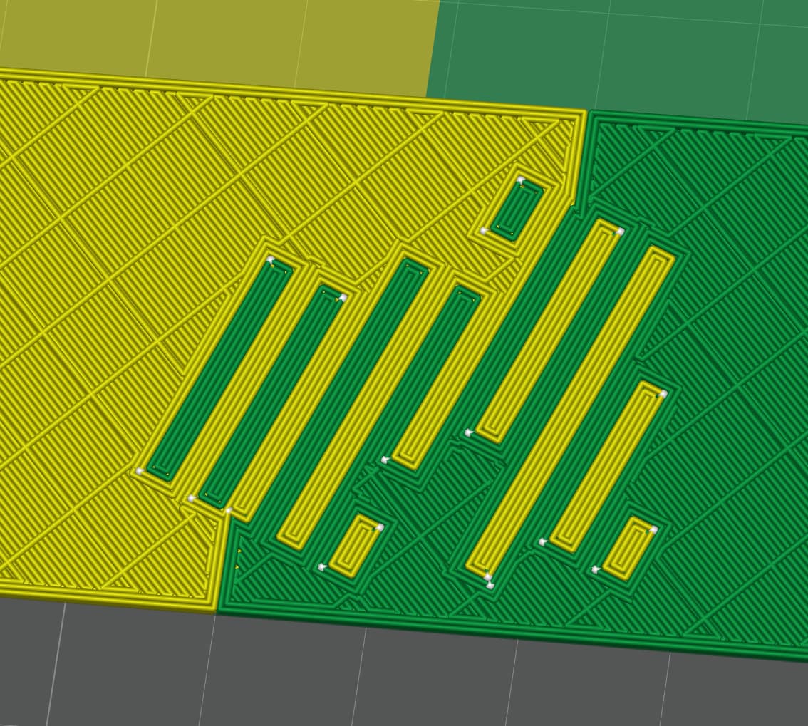

Did you look into the “Beam Interlocking” option under the advanced settings?
Even this question was for Avarax - I understood from the manual that “Beam Interlocking” is used, when you add two object and you connect them.
I was adding one object and simply used the color painter to be able to print it full bed size.
I’ll give it a try!

I tried Beam Interlocking and it’s a good solution for this issue.
It’s buggy at some layers and I haven’t figured out why only some layers are affected, especially considering in the area where the two filaments touch the object is simply square but besides these issues it’s helpful.
(buggy area in the screenshot where some parts simply won’t interlock anything at all but I guess this all can be fixed by tuning the settings and the filament transition)
Personally I would set the angle to 45 degrees relative to the split plane.
The default 22.5 is possibly chosen to have a proper interlock at most common situations.
