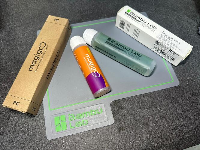

One thing about adhesives…
And before anyone comments on the photo :grinning_face_with_smiling_eyes:, those glues were actually out because I was printing some PC-ABS parts the other day.
Personally, I try not to use glue unless I actually need it. If the filament is dry, the build plate is clean, and the profile is dialed in, most materials print just fine.
That said, if I see a part with a large footprint, sharp corners, or a print that is going to run for many hours, I’ll usually apply an adhesive from the start. Losing a 15- or 20-hour print because a corner lifts is a lot more frustrating than spending 30 seconds applying some glue.
Usually I prefer to run a few test prints first and see what the material wants rather than adding extra variables right away.
