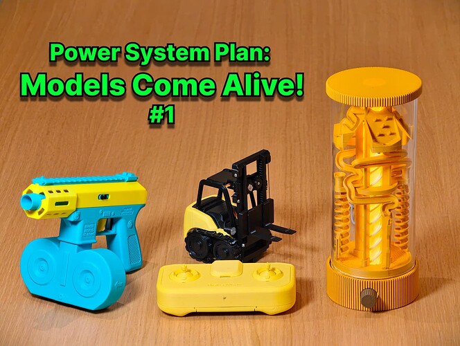

When you design your model car, you might want LED lights to blink or change colors. This makes it more playful. At the same time, you may also want to steer the car precisely. To make these effects happen, we need to properly combine the matching electronic components. However, facing many different power sources, you may find it difficult to decide.
How can you map your desired function requirements to power supply requirements? To answer this, we have launched the Power System Plan: Models Come Alive! Series. We hope this series helps you quickly find the right components, avoiding trial-and-error and wasted time.
In Part 1, we will discuss these two topics together.
