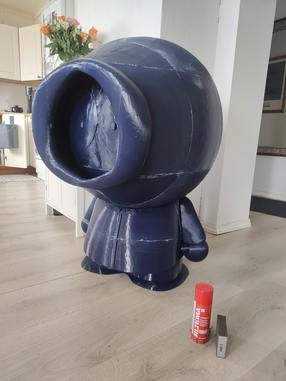

My H2D is on a non heated room at 10C and I never monitor anything, like press print and let the printer deal with the preheat. Isnt the same in the P2S? Why are you manually waiting?
I printed this giant statue in ABS, no warping
There is a setting under safety options that you need to uncheck about the heatbed.
This way it will stay at the required temperature, for as long as you let it
