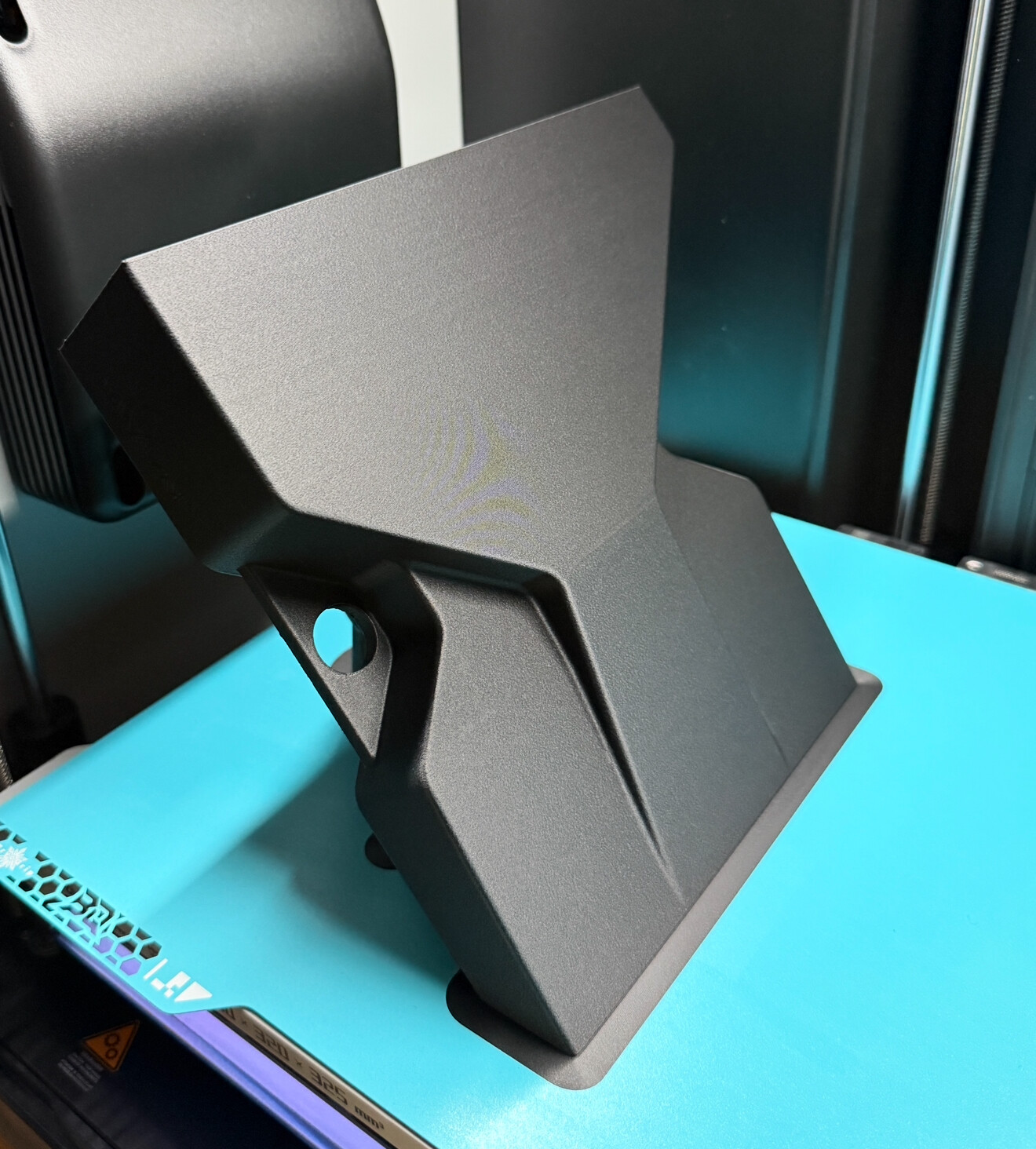

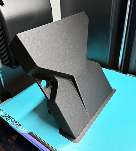

I just finished a 20hr and a 10hr PPA-CF print using the HF 0.4 hot end. Worked great!

I print 100% of my CF filamments with a 0.4 nozzle , petg-cf, PA CF, PET CF. No issues. I have a roll of ppa cf that I will be testing out soon.
It won’t let me upload the images I have. I guess there’s a 10 megapixel limit. Cropping didn’t work lol. I’ll get some pictures when I get home from work later.
What build plate did you use, and did you use any glue or adhesive?

Anyway, I used the Biqu glacier plate @90°c and a layer of Bambu liquid glue.

That looks really good. Was that with Bambu PPA CF and default settings?
what a wonderful beautiful print

This is SirayaTech PPA-CF. I did start with the Bambu PPS-CF profile but changed a couple things.
Temp is at 300°c
I changed the cooling overhang threshold to 25% and left the overhang fan speed alone at 40%. Default is 0% & 40%, so it forces 40% cooling on all outer walls no matter what. With it at 25% instead of 0%, it only cools the outer wall layers that overhang 25% or more from the previous layer line.
I want to say I changed the min layer time too, but I can’t remember if I did or not. I’d have to check

Wow that came out perfect…
Heck yea it did! lol. I decided to reprint the top portion with this filament too since the eSun pa-cf warped a little bit.
