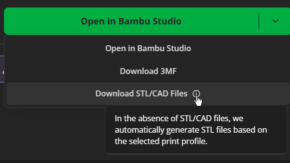

Prevent .3MF files from overriding all settings?
.3mf is not exclusive to Bambu as far as I know. Sadly people also upload those on printables with no .stl as an option.
But I get your point that it is an helpful file format for own projects or in companies. But for a 3d model sharing platform it seems a bit usless with all the different printer out there and bambu studio really could make it possible to ignore this settings.
Yes, they could, and should. As well as prohibit uploads without the raw model.

Of course, the other option would be for MakerWorld to allow downloading geometry files only instead of full fledged 3mf project files. We ain’t a mass producing printing farm with standarized machines, we’re end consumers lmao.

The whole point in using a Studio/Makerworld .3mf is to have ALL the settings for a successful print. If you only want geometry, download the .stl or .step file. Or download the .3mf and be prepared to review all the settings.
If you click on the small „cube with +“ symbol in the slicer prepare tab you can add the .3mf file and it will ask if you want load geometry only.
