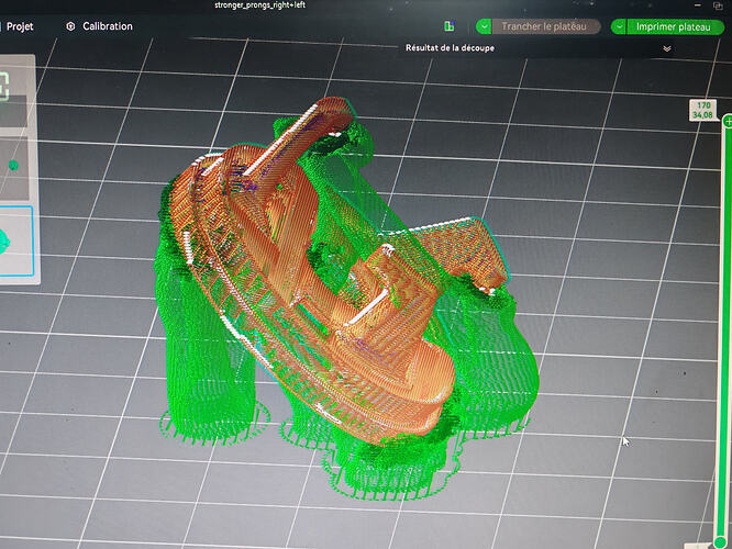

I’m experiencing a display issue in the Preview tab since version 2.4.0 of Bambu Studio on Windows 10.
Description
The sliced preview becomes very difficult to read:
Important
Version comparison
v2.3.1 → OK (normal display) :
v2.4.0 and later → issue present :
Tests performed
Different models → same result
Slicing settings unchanged
The issue appears immediately after updating
Questions
Thanks in advance for your help!

As mentioned in my issue description, I’m using an older version (2.3.1) because I don’t have a choice: all versions since 2.4 have this bug (I test each one as soon as it’s released!).
And as also stated, all files show the same display issue.

I found two open issues for this problem on GitHub, but no indication that anyone is trying to fix it.
The only suggested workaround is to disable “Enable advanced G-code viewer” in Preferences.
