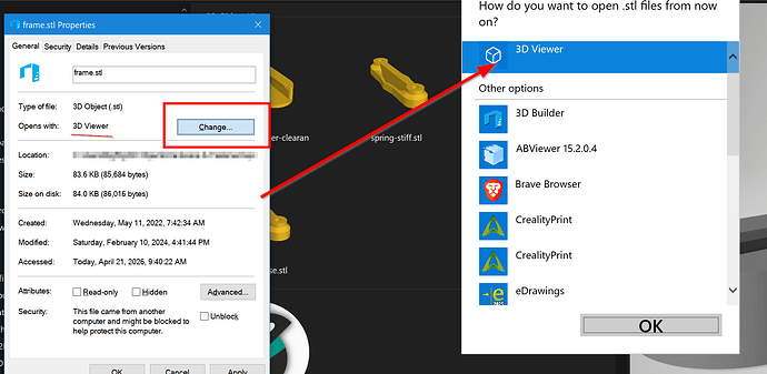

Right-click the file and open Properties, or select it and press Alt+Enter. Then click Change and assign the file type to a program that can display it. It does not need to be 3D Viewer. Bambu Studio, OrcaSlicer, or any other program with a built-in model viewer should work.
In my example below, the 3MF files were not showing thumbnails. That was because I had recently cleared the thumbnail cache during Disk Cleanup. Before taking this screenshot, I reassigned STL files to Windows 3D Builder. Not every system has that installed, and it may no longer be available from the Microsoft Store.
I then switched the association back to 3D Viewer, which also provides a preview animation for STL files. That extra feature is optional. The important part is simply assigning the file type to a compatible viewer.

Hi, thanks for your reply. I tested your solution but it only works for STL files. It is still useful for 3MF files. It doesn’t work, or rather, it doesn’t show the preview on the icon, but in the preview pane this is still inconvenient because the previews on the icon are convenient for finding the file immediately. Thanks anyway. I’m attaching an image of the folder. Bye.
