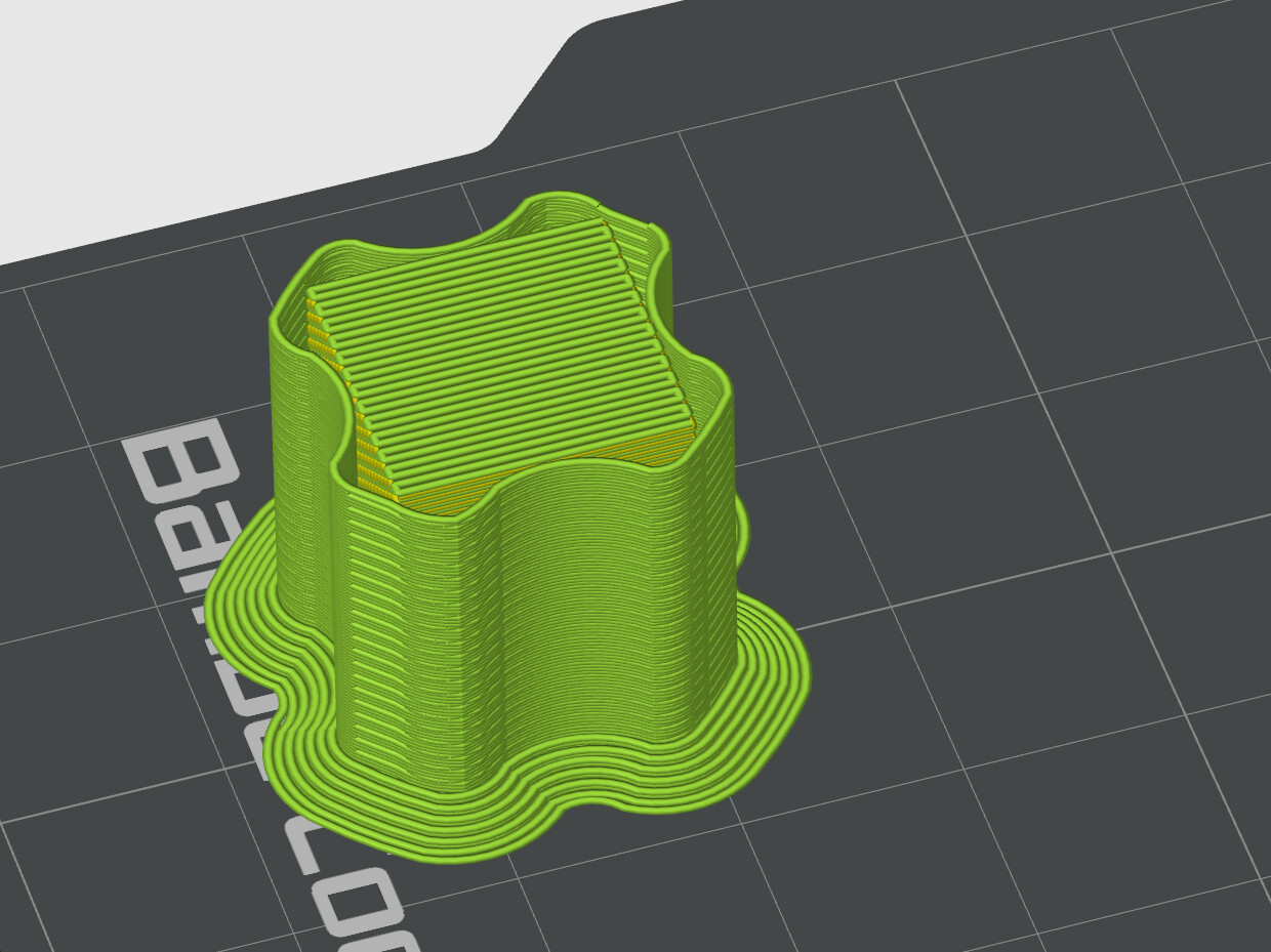

Prime Tower is big with Vortek printing
I just wish Bambu Studio allow us to adjust the prime tower shape more narrow or rectangular than just a big square takes up a lot of space for prints. Currently, the parameters in “Others” tap is very limited how much I can reduce overall size.

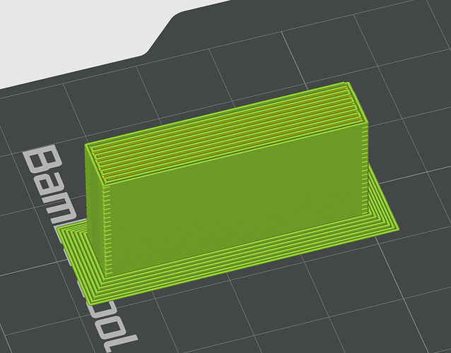

However, there is already one option available: changing the form to narrow rectangular: The option is called rib walls - or, to be precise, turn them off.
Okay, changing that naturally has advantages and disadvantages. I’ll link to the wiki at the end for anyone who wants to read up on it.

Well, I also know why Bambu does this. We discussed the Prime Tower topic just last week, looking up old statements and GitHub projects. ‘Because otherwise the Prime Tower could collapse’ - in other words, because the one-click and print mentality takes over.
If you turn off that ribbed wall option then you can set a width for the tower. Reducing the width just makes it longer (“deeper”) though. Reducing the “Infill Gap” setting will also make it a bit smaller (lowest is 100% though). I think the latter setting corresponds to the Orca “Wipe tower purge lines spacing” option.
I believe to reduce the overall size on a more macro level one would need to reduce the amount of material used for priming (somehow)…?

However, OP if your filament is very dry and you have dialed your settings right, the traditional wipe tower works just as good. Rib wall is sort of like a solution for wrong problem to be honest, but i can’t blame bambu for doing that.
