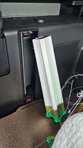

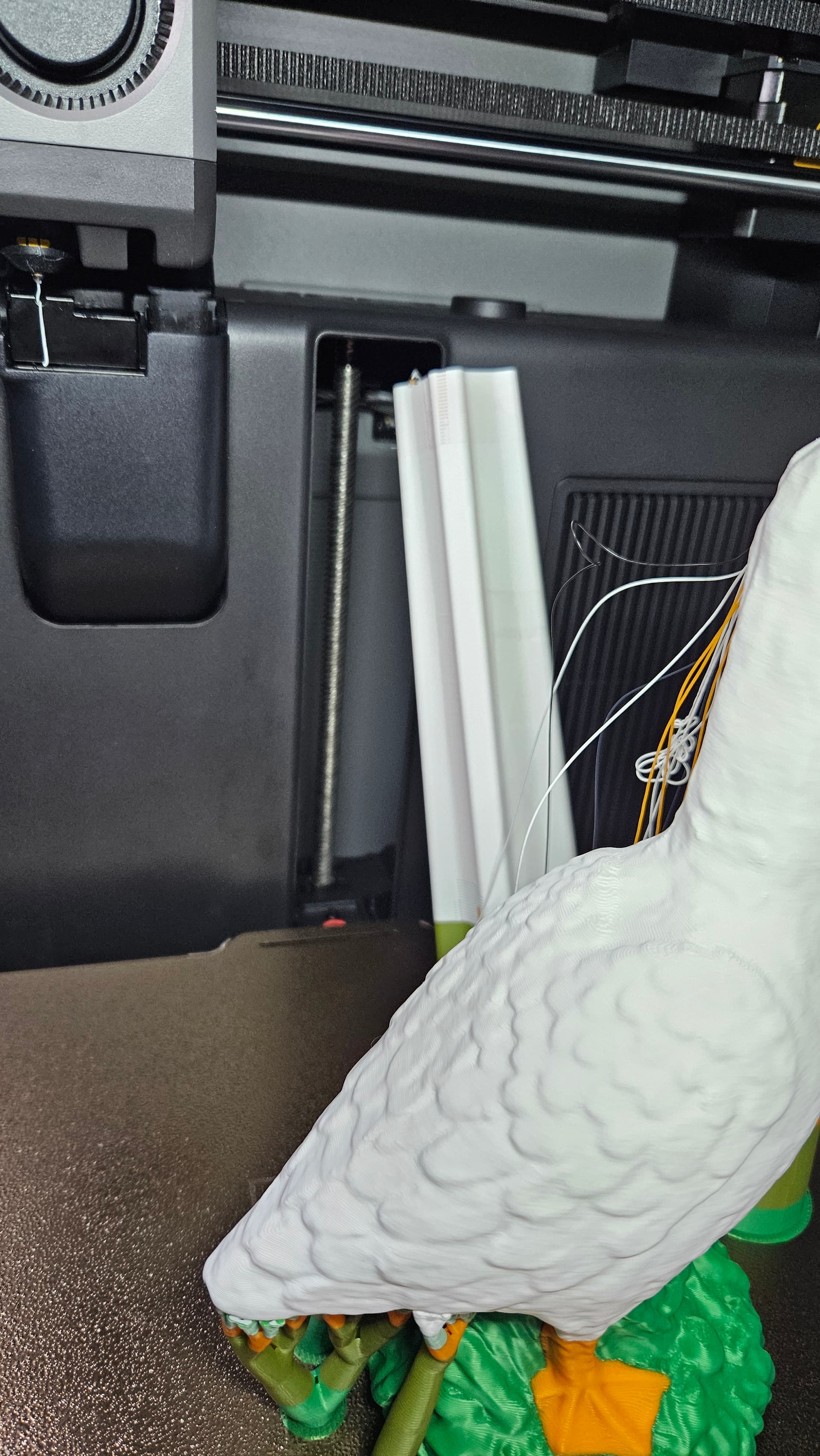

I am not sure why this keeps happening. It seems with tall models like this one, the prime tower is being knocked down. Anyone have any ideas on why this is happening? I washed my build plate the other day, so I would doubt it would be that.
It did finish the model, so I guess that is a plus.

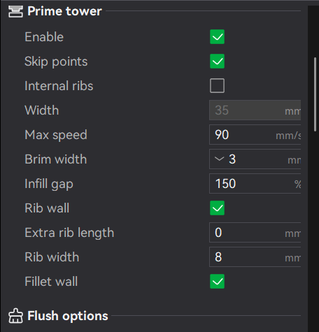

  • …and then, of course, the usual settings for the last 5% of success: Larger brim - also for the Prime Tower - it’s really tiny on yours. Optimize settings, etc.
Towers, and taller prints, get knocked over because filament blobs are being deposited on the top of the print. When the nozzle comes around on the next layer, it hits the blob and that knocks the print over.
You need to dry your filament and calibrate flow and PA better, so there’s no excess filament building up on the nozzle.

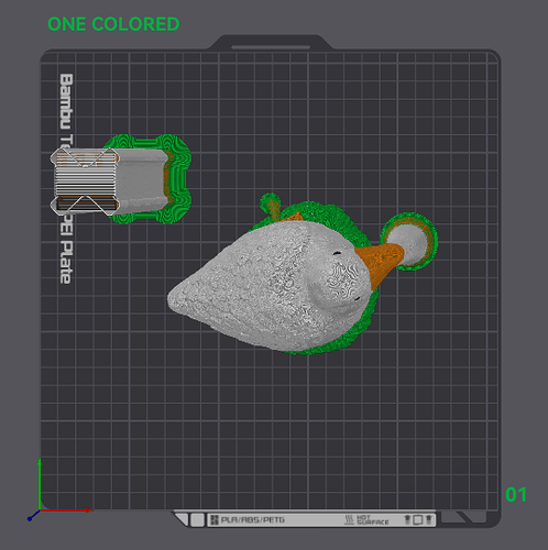

The reasons could be numerous , play about with the settings and its positioning in the slicer
your image looks to be a little to close when compared to the default placement on the top left of the plate

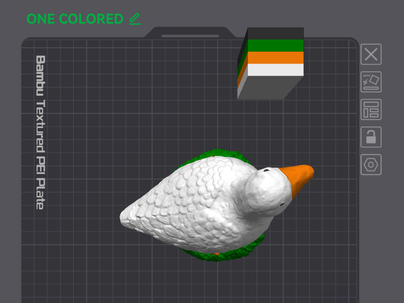

Wait, the placement is on the top left of the plate by the purge chute? I do not think I have ever seen it slice like that before.
Yes (A1) but it can be positioned in a user defined place
Prime tower | Bambu Lab Wiki
Would this placement be alright, or should I move it to a different area?
Where does it place it by default , ?
Right here.
Then i (personally) would reorientate the model and position it in a more centralized position (beak facing the bottom of the plate) i didnt realize that was the p series default
which flush into setting do you use ?
I am currently using flush into supports.
Flush into infil maybe better , because supports end with the beak ?and that big peak on top of the prime tower could be being caused by a lack of support to flush into ? (thinking out loud)
I know I’m repeating myself, but… There are really only two reasons why something might get knocked over during printing.
  1. Parts with a tiny footprint can be pulled over by the drag of the extruding filament if the flow isn’t quite high enough. But usually, if it’s a taller part, the print surface just deflects a little and the remaining layers turn in to a swirly mess.
  2. Flow/PA/Temp not calibrated well enough causes excess filament to build up on the nozzle until a blob gets deposited on the print top layer, and the next time the nozzle gets there it hits the lump.
If flow parameters are properly tuned, there is very little force exerted on print during extrusion and stuff won’t get knocked over. Trying to get the print to stick to the build plate better will potentially help, but it’s really a band-aide and not the root-cause fix, which is tuning extrusion to make sure the nozzle won’t be able to exert any significant force on the print while it’s doing its thing…
