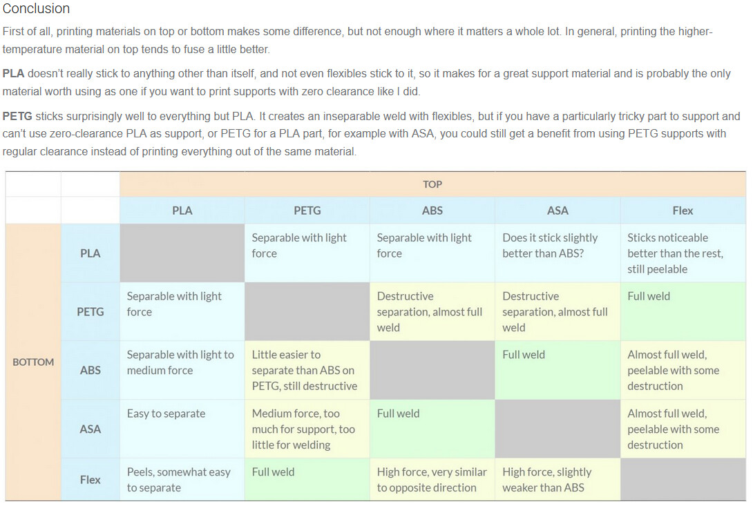

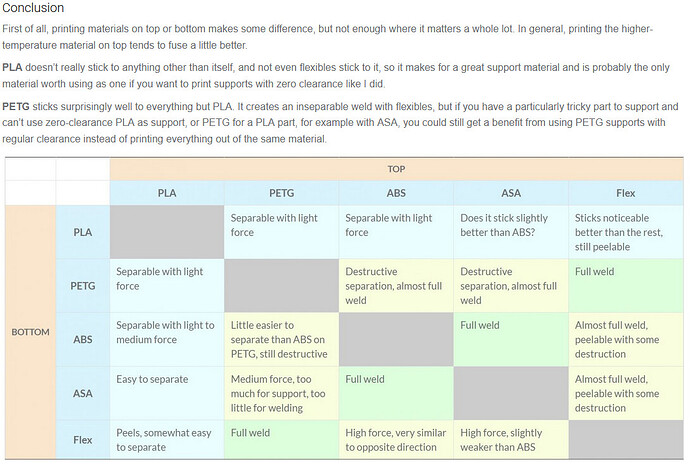

toms3d.org (Thomas Sanladerer): Try these filament combinations for Multi-Material and Supports! (also timestamp 4:48 in the youtube video):
PLA should not bond to ABS
