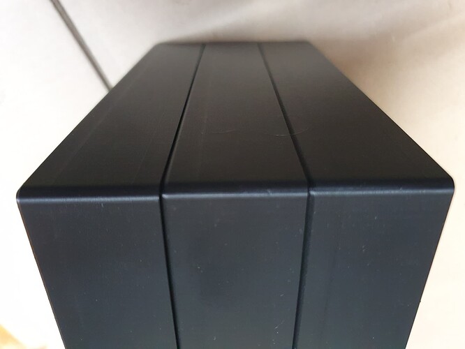

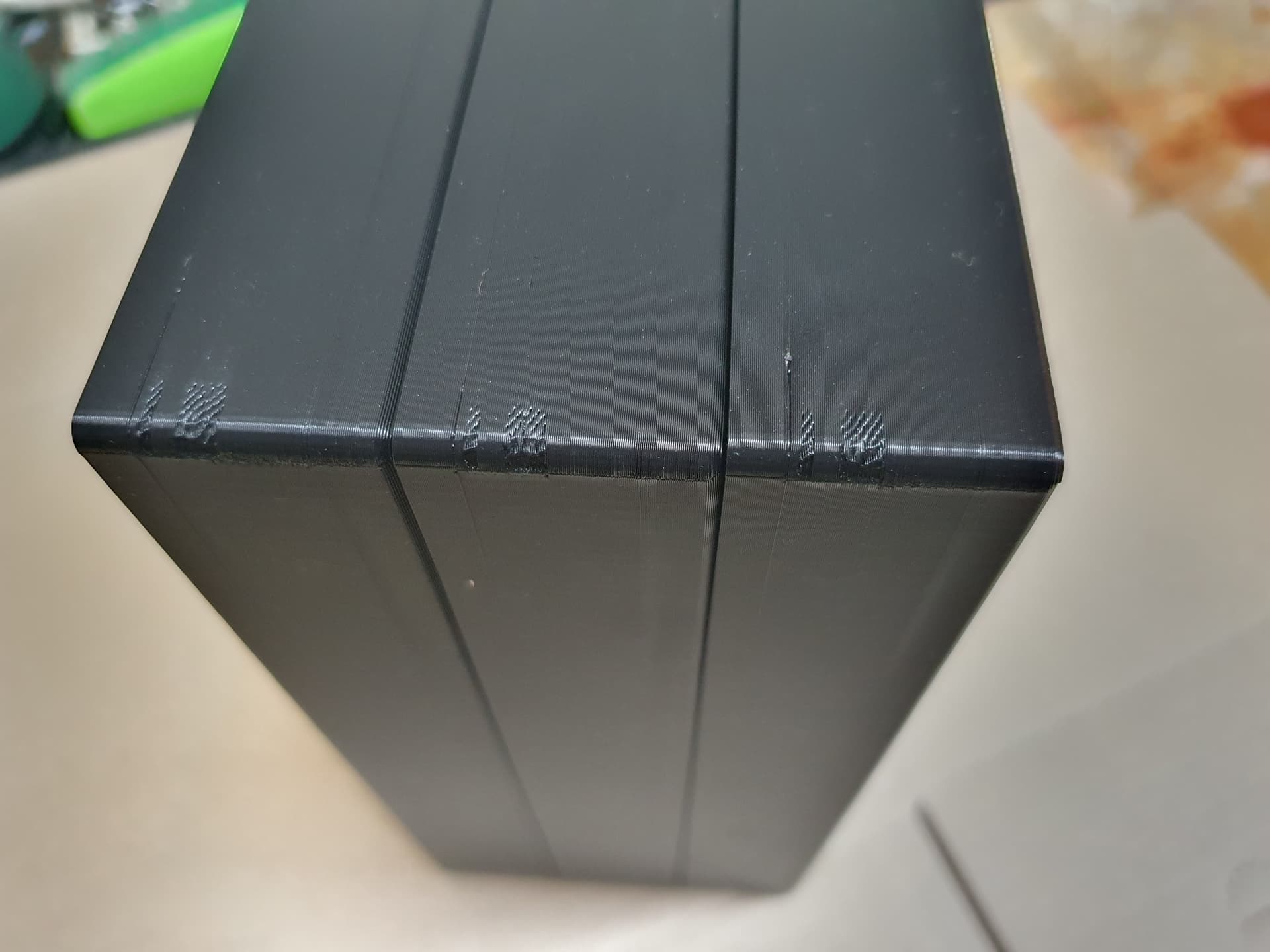

Hi there, I would really appreciate some help troubleshooting this issue that has come up for me.
The artifacts in the pictures are consistent on every print. Same patterns, in the same place. The strange part is that I’ve printed this part dozens of times prior to this without any issue and then this just started happening out of nowhere. The other strange thing is that I have two identical P1S printers and when printing this exact same file on the other printer I don’t get these artifacts.
I’ve run through the whole machine best I know how and inspected all the belts, lead screws, tensioned the belts, cleaned the rails, cleaned the nozzle, etc. Can’t find anything obviously wrong. Because the artifacts are pretty much identical every time I suspect it might be an issue with the file. It’s just odd that it prints fine on my other machine.
I’d be very grateful for any assistance tracking this down.
Had the same issue, It turned out to be a damaged nozzle (It was a stainless one and I printed abrasive filament with it). It was scratching the print and causing patterns exactly like that.
Interesting, thanks for the tip. This machine is pretty much brand new, I’d say less than 80 hours of printing at this stage and I’ve only printed PLA and PETG HF on this one. But I’ll swap the nozzle out anyway and see if this fixes it.

I would suggest cutting out this corner ( 5x5cm) to test this print.

cut a piece off and print it at an other position of your built plate.
cut also the hight a bit and you will see if it is caused by printers mechanic.
(belts, rods ,srews)
Sliced off the corner and printed in the exact same position and everything printed just fine. Re-sliced the file and tweaked a few settings including trying the inner/outer/inner order and moved the seams to a different location and it printed fine.
I’m still completely confused as to why this artifact appeared out of nowhere after many successful prints and was not present on my other machine.
But, it’s printing pretty clean now with a newly sliced file.
