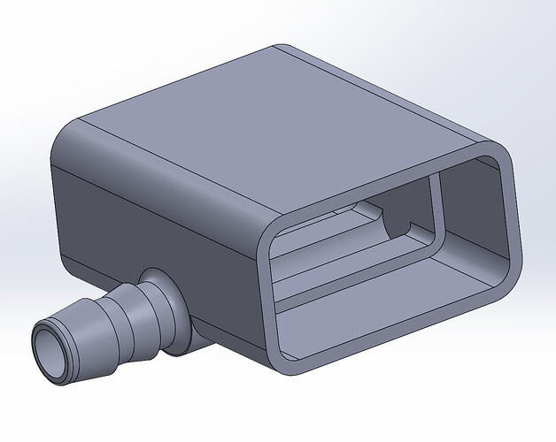

I would be interested in having some insight provided as to how you as a H2D user print this:
What rotation, settings for the print etc. My machine is using .04 Tungsten Hot Ends.
The desire is to have a print that is clean but also as solid as possible. The print does not need to be 100% solid, but fairly durable. Currently printing with Bambu ABS (Silver). I do have ABS Support material arriving today.
Please let me know should any additional information I may have forgotten be required.
I have tried modifying a couple settings only to have a spaghetti mess. So I set all settings back to “normal”. I can post a STL or STEP file should one be desired to experiment with.
Any help, input, critiques would be greatly appreciated. Thank you!
00_BL_Forum_Share.3MF (58.6 KB)
Can you post other views or the file?
I would place the bed either flat like this:
EDIT: w/ the design file uploaded, if you choose this orientation, use the top plane not the bottom plane, the bottom plane isn’t flat.
or with this face on the plate
in both situations, using supports to help the quickconnect hose thing.
You can also try 45 degree angles to make those internal shelves easier to do without direct support. Whatever you do, don’t print it with the tip oriented 90 degrees up in the air, imo, it will be very weak and you wil snap it off when you connect that hose and jiggle it once to make sure its secure.

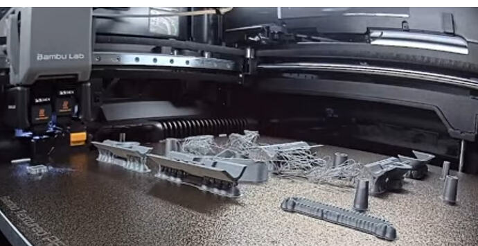

New attempt Failed…
I know I have to do better, but with no support present right now, Im grasping at straws.

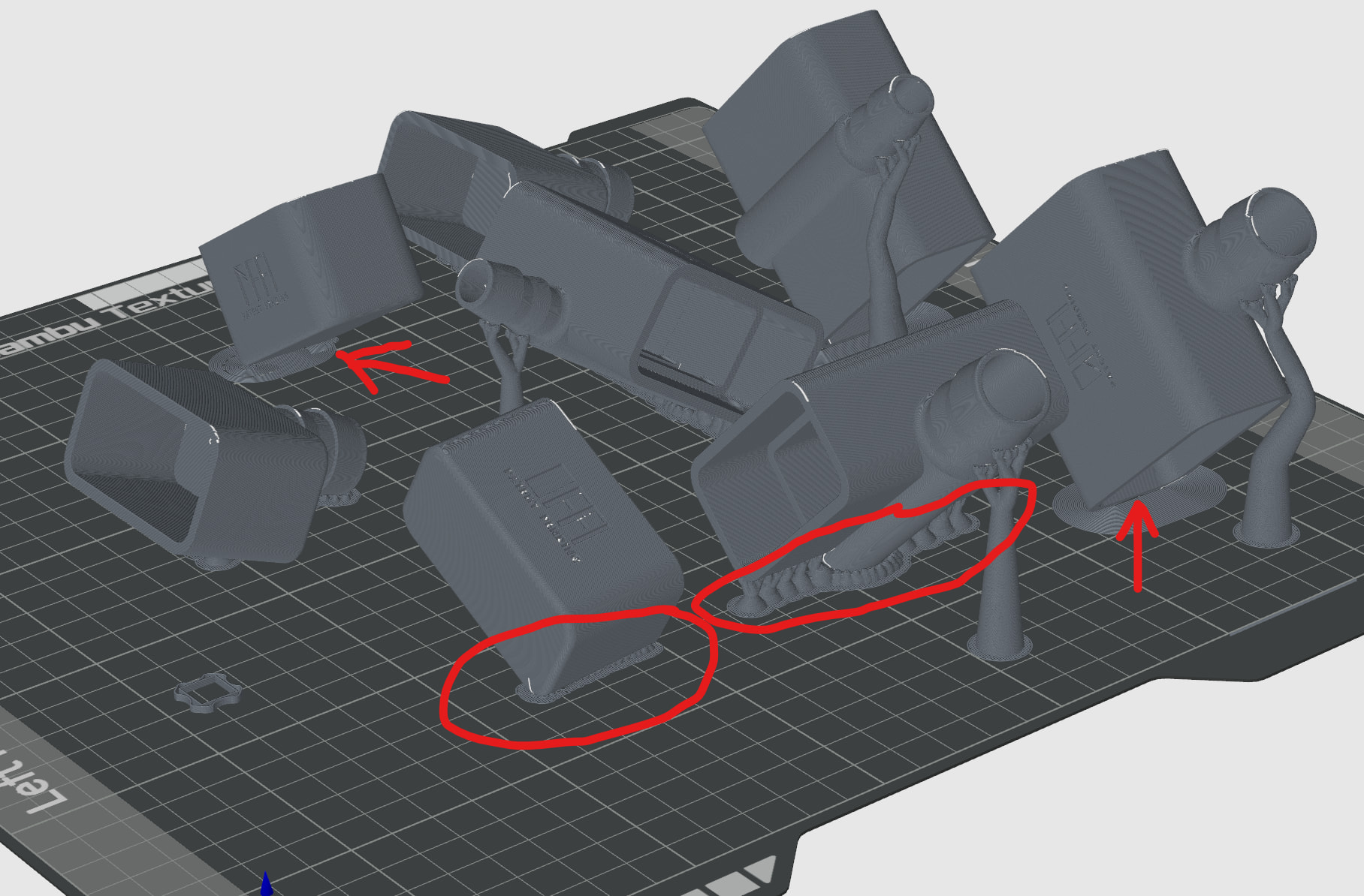

If you’re putting them up on their side like that, I would use the Support Painting tool to stick some more support on the thing.
This will help get it attached to the plate earlier
This is also a good candidate to design your own supports for, if you find this 45/60/etc angle produces the part you want.

Basicially a cup with a tube out the side.
Bottom of the cup on the bed, tube out the side, turn on supports.

What is really weird is the part closest to the camera, just seemed to stop printing all together. But the support was still printing it seems.

If youre running bambus default profiles, the machines accel and jerk are tuned very high to get very high speed prints, and the machine will physically rock back and forth. The machine DOES compensate for this in printing accuracy - but you know what doesn’t? Inertia of the object stuck on the plate. Go find a shoebox, hold it by your fingertips on the edge, and shake your hand around. Did it fall outta your grip?
So, to fix this, either slow down, or make supports [with the support painting tool first, you can do this in 3 seconds] that connect it further up.

UPDATE: The Bambu ABS Support Filament came in after this print (now failed) started. So, ideally should I run supports differently?
My intention is to make just the attach point layers ABS Support material.
