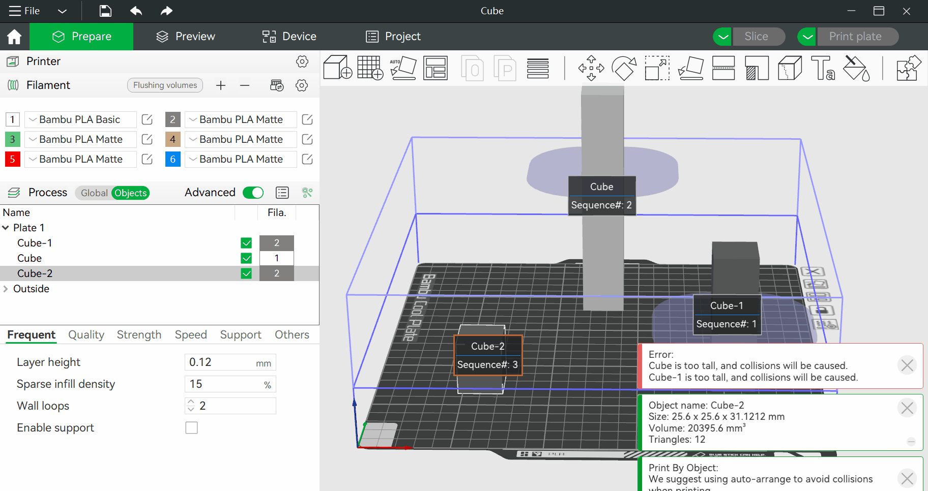

Print by object with 1 tall object
It would be nice if we could use print by object and have 1 of the objects be tall. It would just print the tall part last.
you can.
1 tall object in the front of the build plate.
but left and right of the tall object you cant have anything taller that the distance between the build plate and the x carriage.
Further to the back you can have normal prints
but stil not on the same plane in the x direction
Just make sure the print order is correct.
use "Ctrl+E " to turn on/off the label which includes the print sequence
Thanks! Never knew this was a thing
