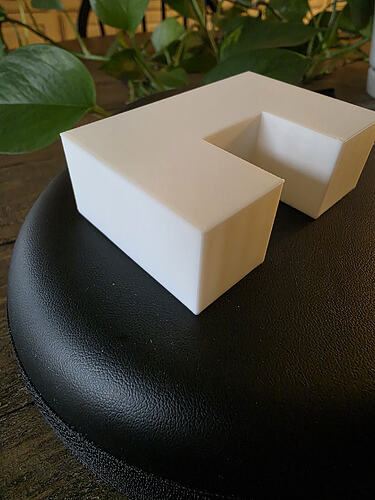

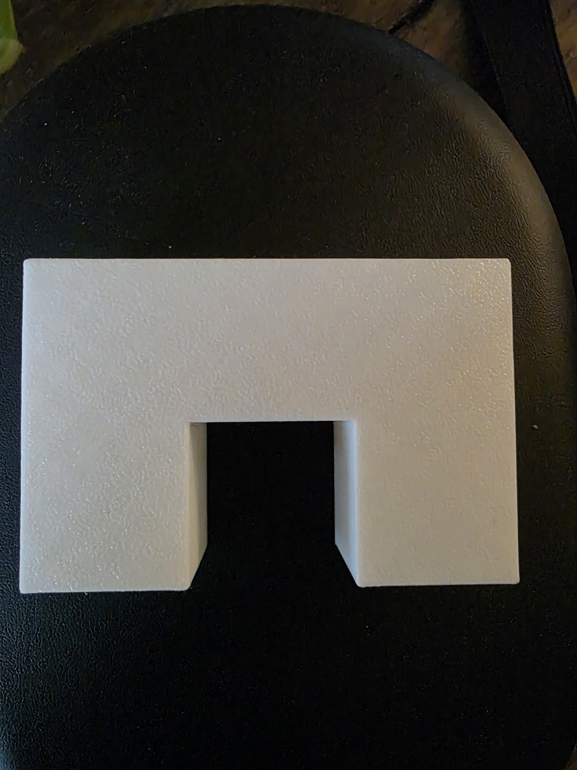

Hi,

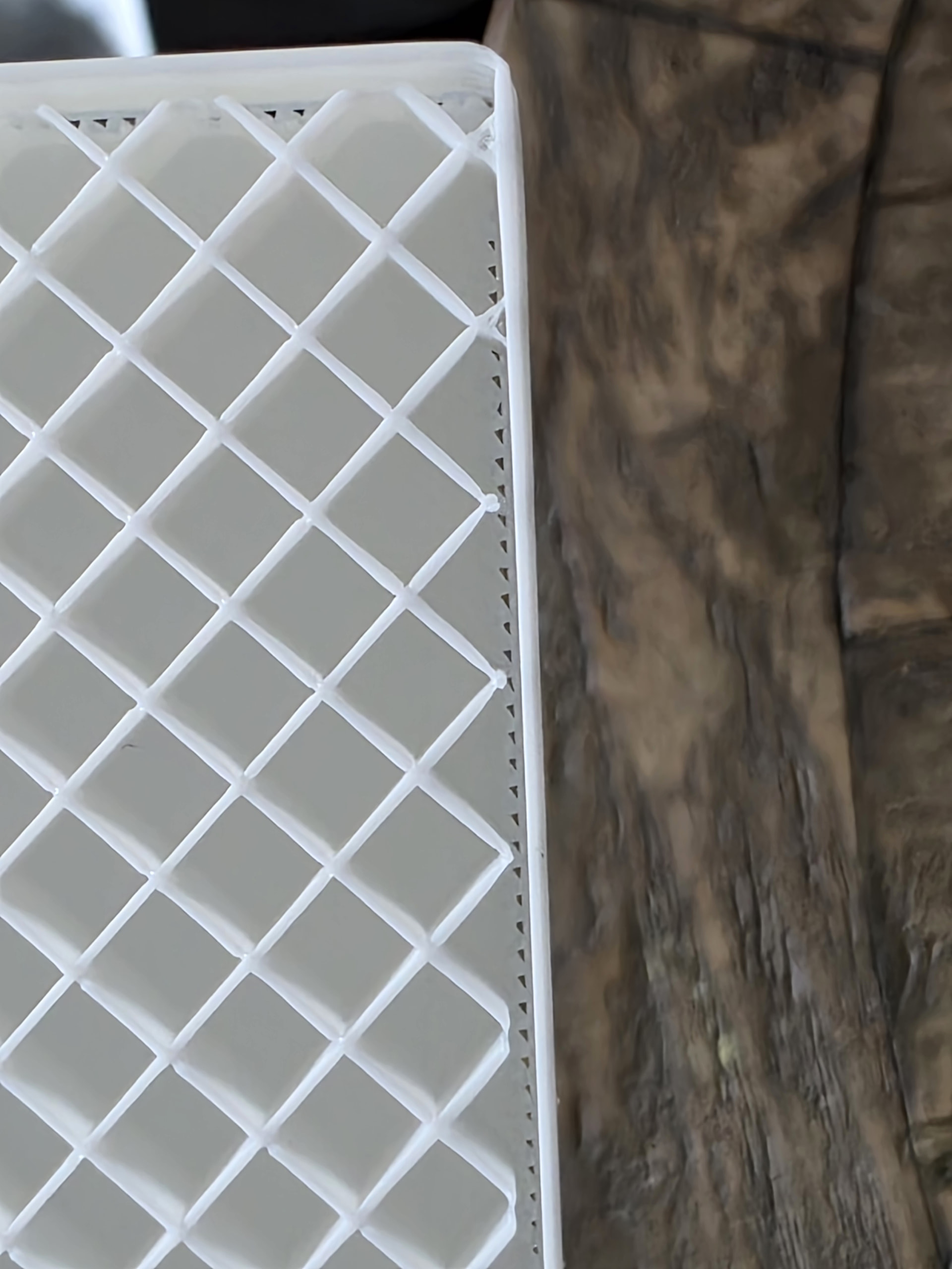

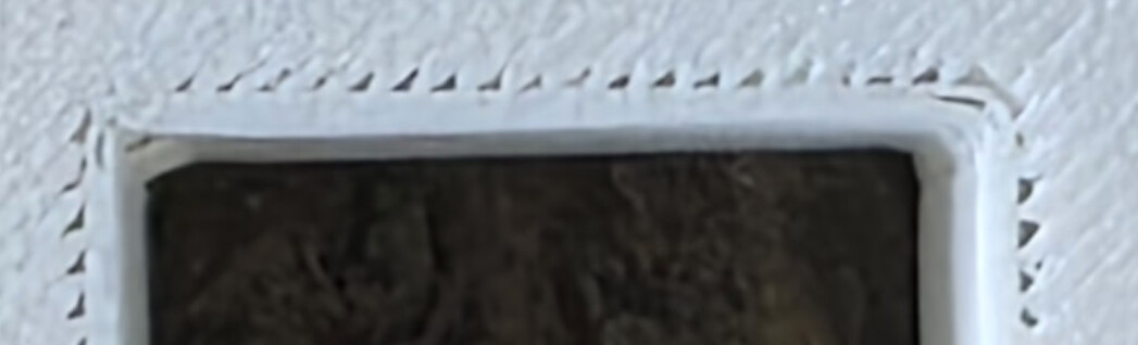

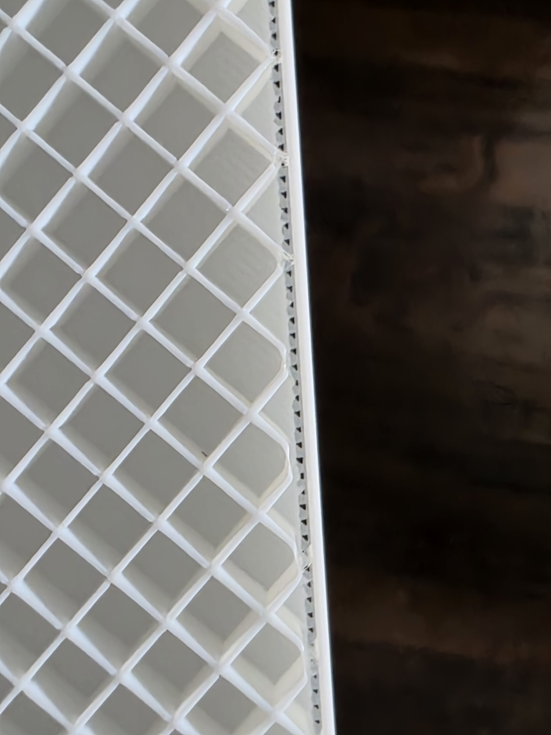

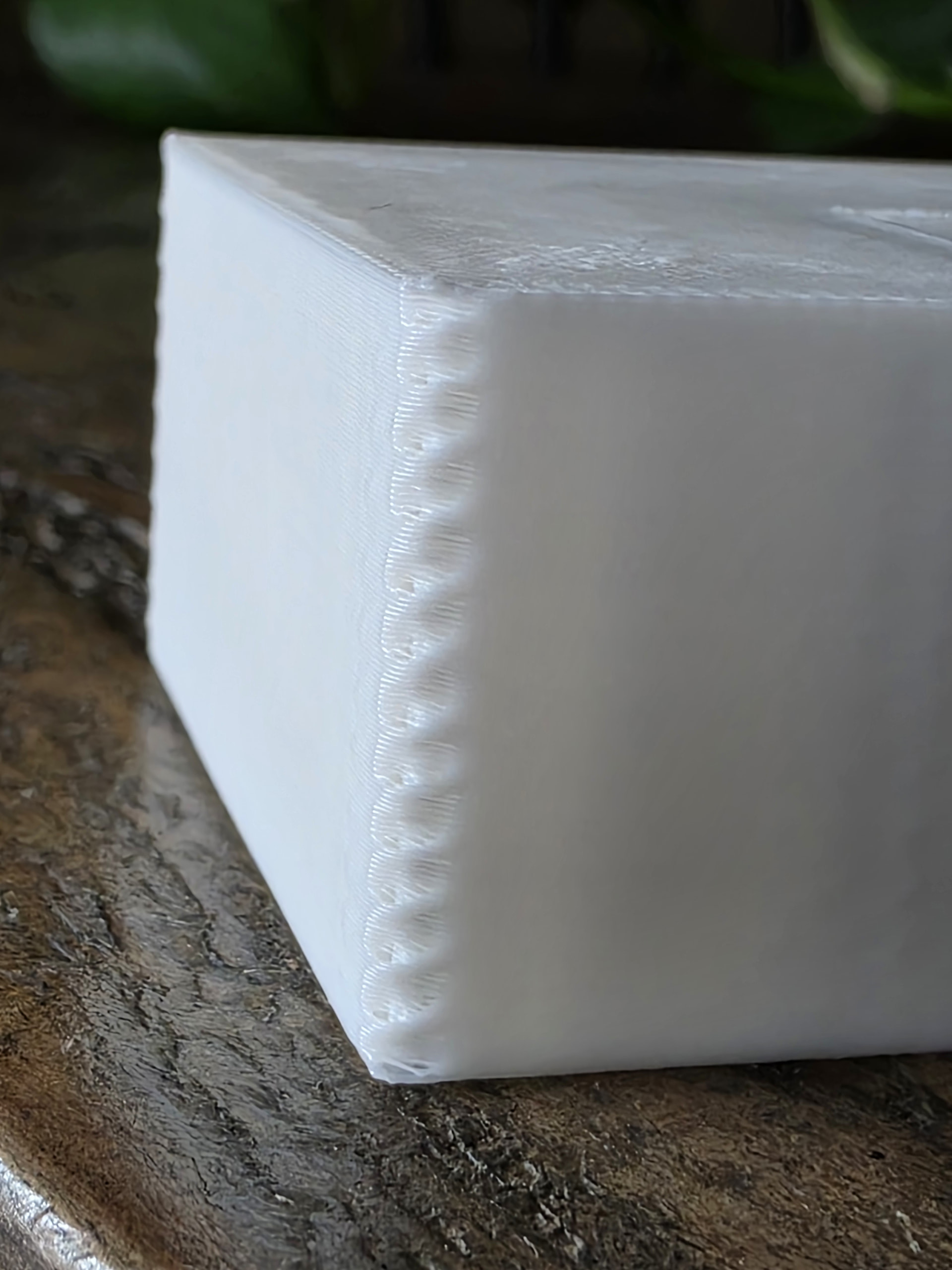

Pretty new to printing so I appreciate any information that would help…I have a P2s that initially printed without any issue. After a few months every print started to fail due to extreme stringing. I swapped the nozzle and that fixed the stringing, but now I am getting a consistent print error around corners (see pictures)…also it appears that the infill isn’t going all the way to the outer wall of the print (See pictures).
I was able to print this file prior to swapping the nozzle without the infill or corner error. Any input on how to fix this would be appreciated.
Thanks.

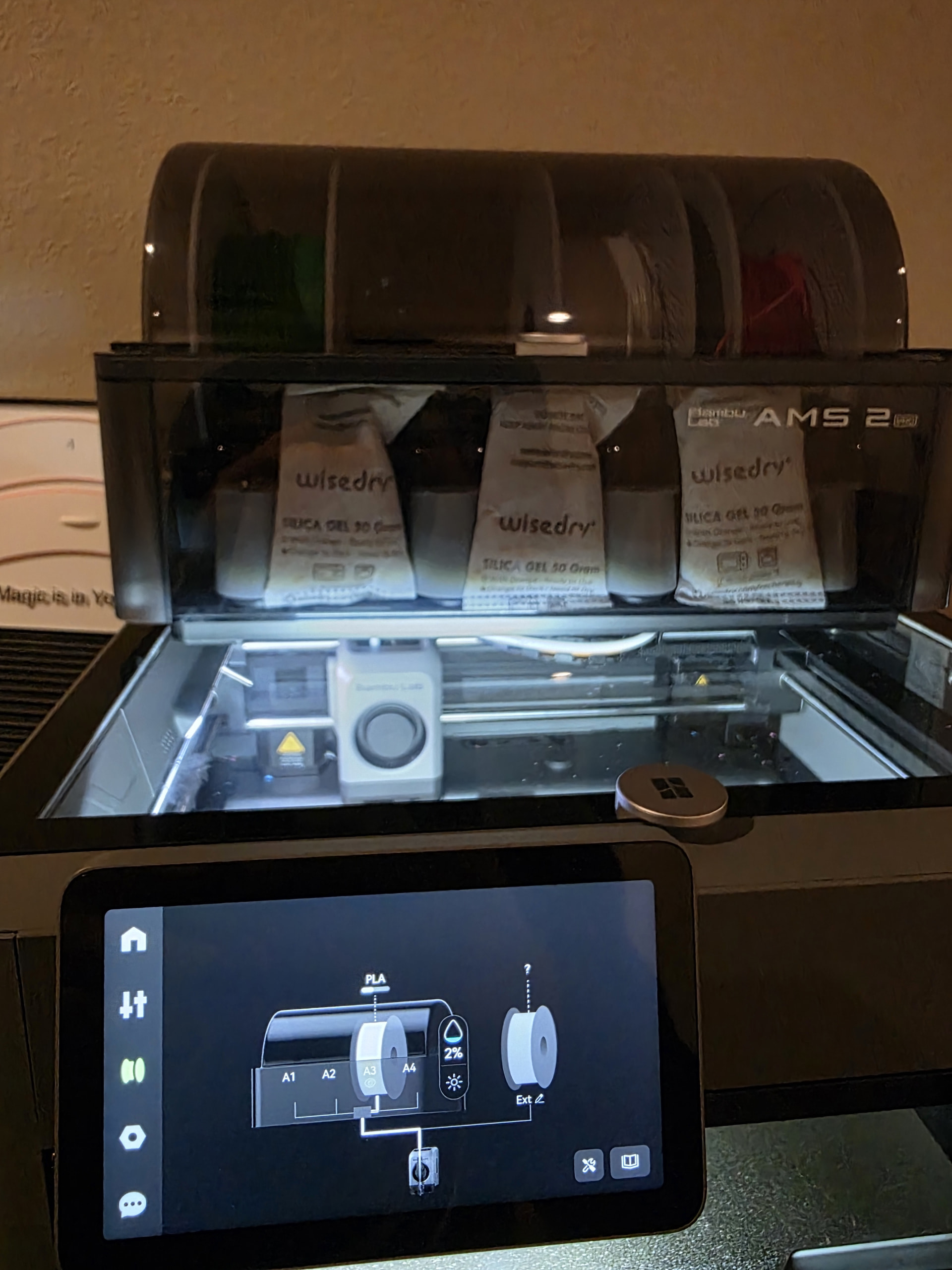

It in the AMS2 with silica packs.
What about when they’re not in the AMS 2 Pro?
Just based on “every print began to fail due to stringing” - and your timing comment, this really sounds like moisture issues.
@MZip is our dry filament expert, look through some of his posts to get an idea of what good dry filament practices look like.
When the stringing started I read that it could be moisture so I bought new PLA and had the same issue…the issue resolved itself after I swapped the nozzle. The print error I have now is with corners and infill not going all the way to the walls (see pictures above)…those errors have been since nozzle replacement.
An AMS2 with silica gel packs is a huge double-edge sword.
If you don’t monitor humidity carefully they can go from water scavenger to water source especially when the AMS2 is in drying mode.
What you want to do is take the silica gel and filament out of the AMS2 and see what humidity it can dry to empty. Read the AMS2 humidity value.
Put the silica gel back in and read the AMS2 humidity again once the beads have had a chance to warm up. If the humidity is now higher, it’s past time to regenerate the beads.
If the humidity goes up when you put the beads back in (no filament), the beads are actually crippling the performance of the AMS2. If the humidity drops from the no-bead and empty AMS2 when the beads are at drying temperature, then they are helping.

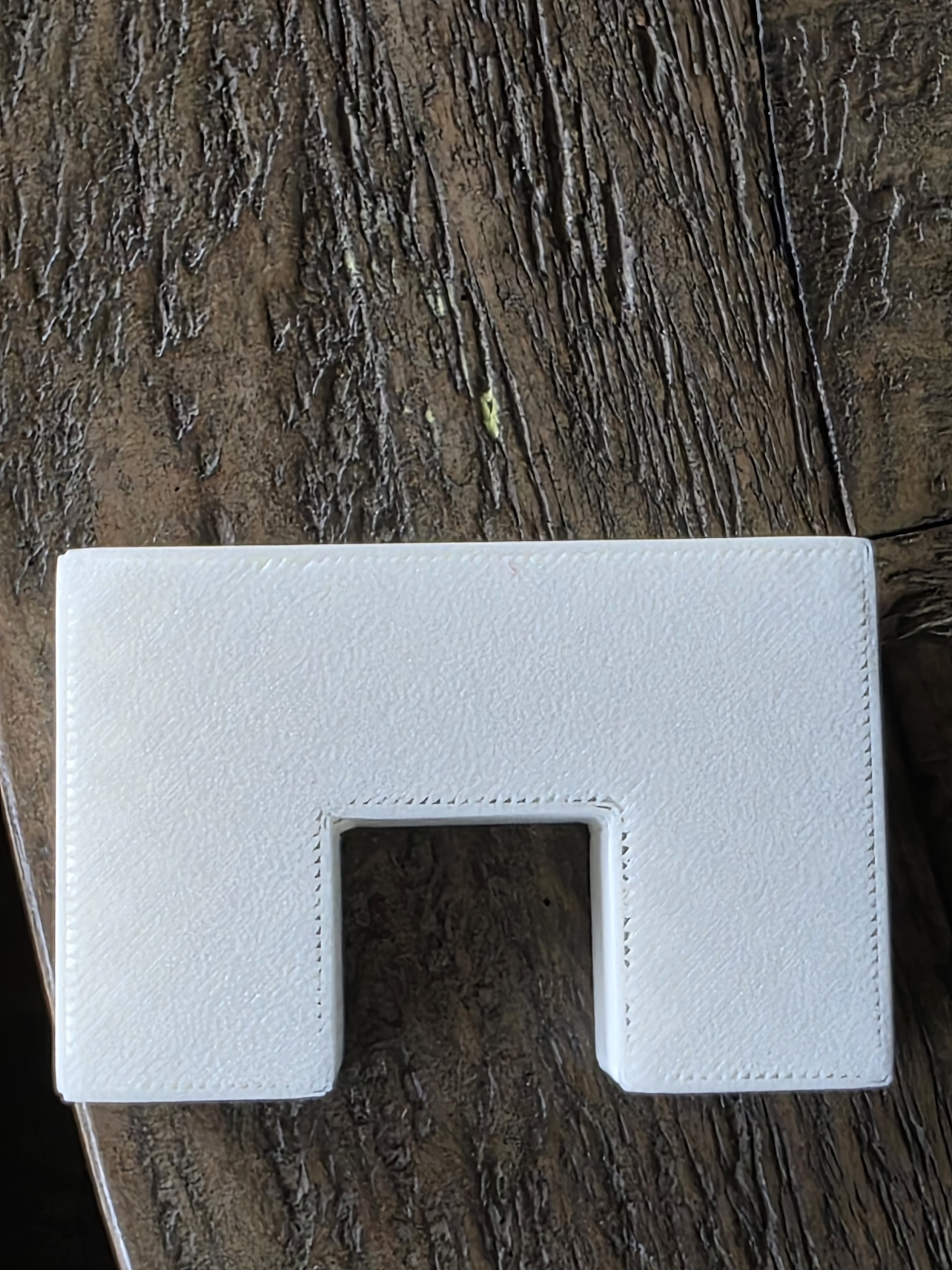

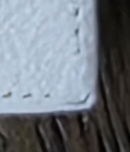

Your picture shows gaps along the bottom edges and corners, indicating that the pressure advance is incorrect.
Calibrate the filament, use the correct PA value, and then see if the upper layers still produce scalloped corners.

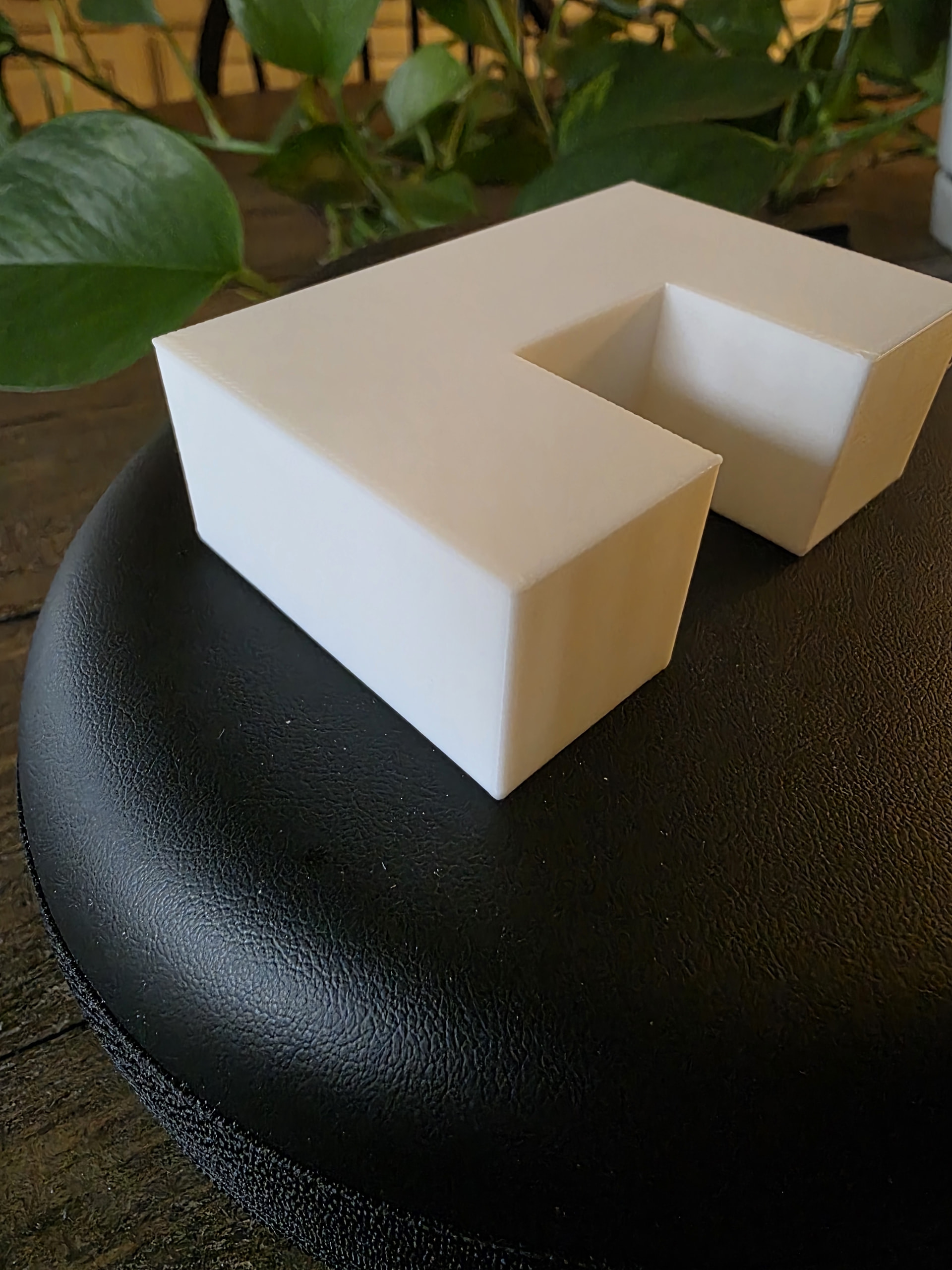

I adjusted the K value using a calibration test and it fixed the issue (see pictures)…Thank you for the help!
