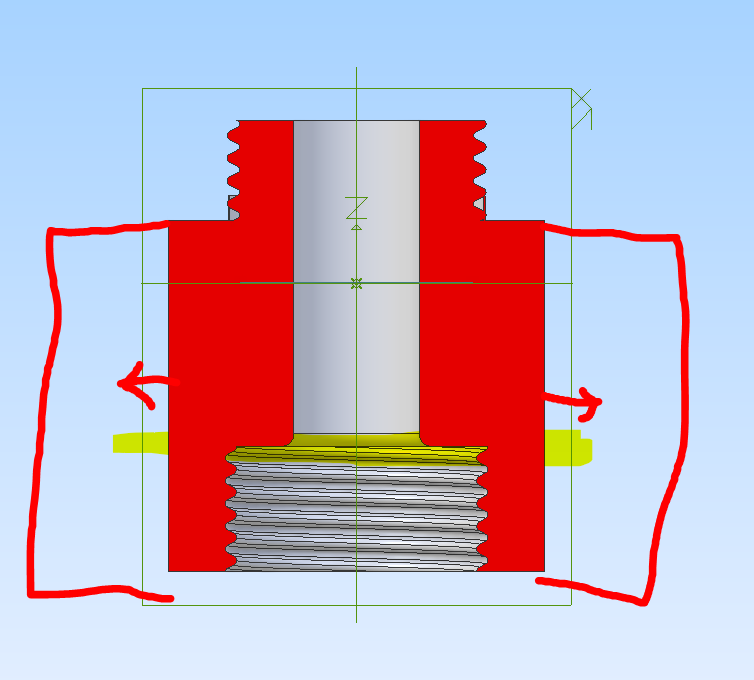

These days I rely on prints to do just about anything and find it rare when one fails. In this case it’s not from the printer or the filament but the design, possibly print settings and application.
Attached in a cross section of a male to female G1/2 coupler. I’m using it on a chiller so it sees low pressure water. the threads are not tapered so I’m relying on compressing rubber washers in the pocket where I marked it yellow. That’s also where it failed. its a simple failure, you lock the male threads down on to the washer and the part splits because it was printed 180 degrees from the photo. too little pressure and it leaks, too much pressure and the print splits.
I was on my third print and didn’t play with it anymore, but I think different filaments, % infill changes and print orientation might have help.

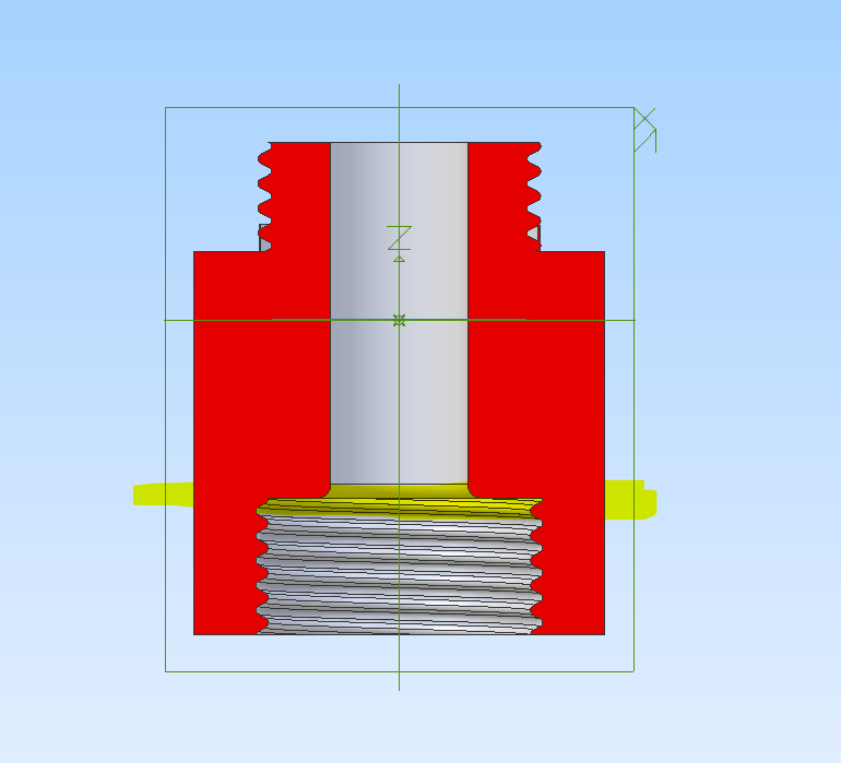

You could try printing it with 100% infill (if you haven’t done that) also reducing the part cooling and aux fan speeds can allow the entire part to stay warmer and thus bond together stronger. Beware that having the part and chamber become hotter can cause the PLA to deform and print poorly. Also you could change the CAD model so it looks more like this:
This would give it thicker and stronger walls so it won’t break as easily on the Z axis.

Some background. Using PTEG at 60% infill using some standard infill pattern. Coolant is RV antifreeze held between about 15 to 20 degrees C. A chiller for a laser.
Could have continued to play with it but I wouldn’t want it to fail some time in the future and leak coolant all over the machine. Thanks.
