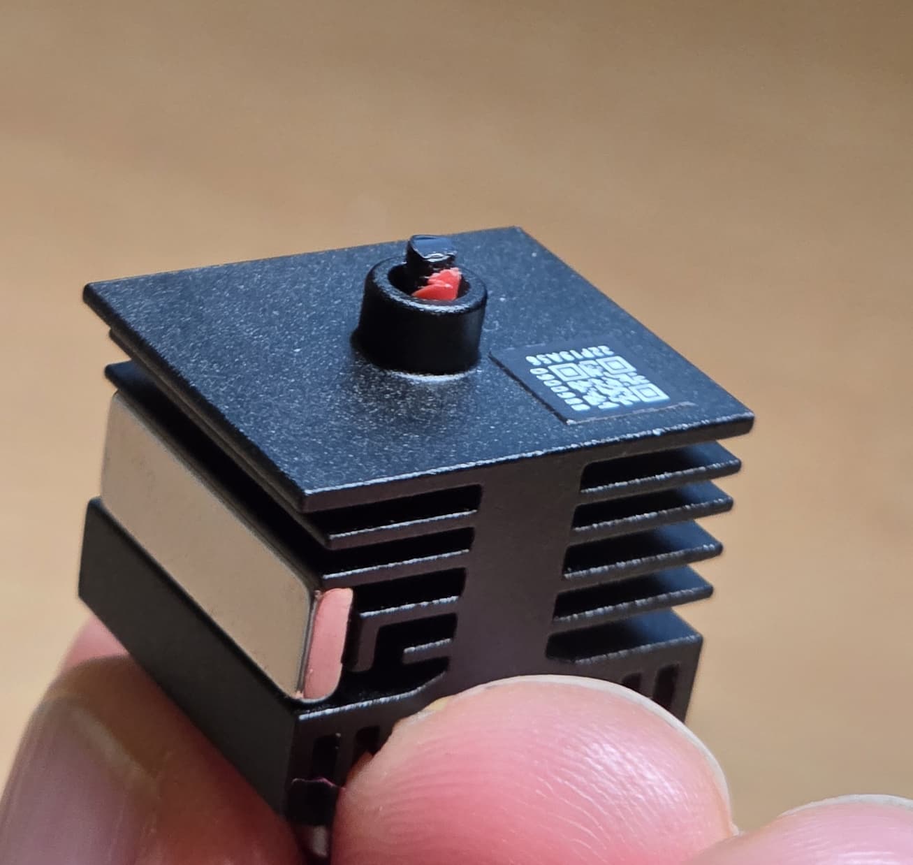

Has anyone experienced issues when printing with a 0.2mm nozzle? I was printing a multicolor model using ASA filament, and even during the first layer, I received several warnings such as:
-Extruder is not extruding normally
-The extrusion motor is overloaded
The same model printed multiple times with a 0.4mm nozzle came out perfectly without any issues. I’ve noticed that other users on the H2D thread are reporting similar problems:
Permanent problems with 0.2mm nozle on H2D
I am sharing picture of my clogged nozzle—it shows that two colors are somehow stuck at the top entry of the hotend. I’m trying to figure out whether the issue is related to the filament type (perhaps PLA causes fewer problems), multicolor printing (with filament swapping while the chamber stays warm, potentially affecting filament behavior), or a combination of both.
Please share your experiences. Thanks!
Are you saying you’re using ASA + PLA thru a single nozzle multimaterial, as well as using a 0.2mm nozzle?
The normal advice for multimaterial is to max your purge for the best hope, but that’s gonna take… lets say… a long time… to get thru a 0.2mm nozzle. Put on your patience pants!
I would also maybe edit your PLA material that youve chosen, and give it a higher max temperature range (not printing temp. “Recommended nozzle temp max”), to help it just “be hotter” when its trying to push the ASA/PLA mix out.
No, definitely not. All the colors used were ASA only. I haven’t printed any PLA with the 0.2mm nozzle. That was just a thought - whether PLA might potentially cause fewer issues. Maybe other users can confirm if PLA works reasonably well with the 0.2mm nozzle.
The 0.2mm works great with unfilled PLA and PETG even in a multimaterial print. Haven’t tried anything else with the 0.2 though.

Update to the original post:
Later on, I found that the same filament type caused clogging even with the 0.4 mm nozzle, when printing for a little longer time a single color print. So I have strong doubts that the issue might be caused by poor-quality filament.
After this discovery, I purchased Prusament ASA and completed several prints (20hrs in total) using the 0.4 mm nozzle without a single issue. I haven’t tested it with the 0.2 mm nozzle yet.
However, I believe I can now consider this issue irrelevant, as it was caused by problematic filament — specifically “The Filament ASA” from Spectrum.
