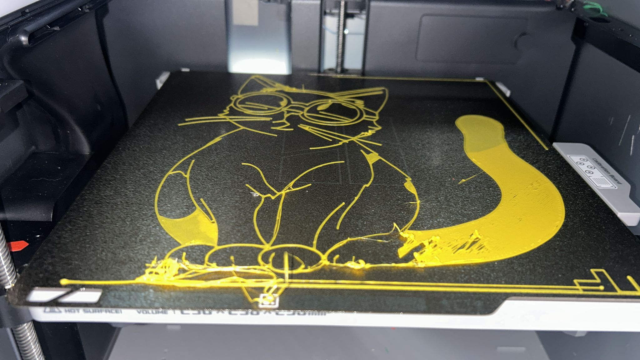

For an example to print failures, especially large ones you can see below after initial layer it is damaged as seen. if any solution you have i am happy to try
That still looks like a dirty plate to me. Give it a good scrub with dish soap and hot water. Be very careful not to touch the build surface once it is cleaned. You can also add 5-10 c on the bed temperature and be sure the door is closed during the first few layers.
Actually it is just cleaned and bed temperature raised to 65, door is closed and I set part fan after 5th layer. on small model such as 3d benchy I have no problem, but for large surfaces is not holding plate. I am not sure may be since material is not cooled down this happens. and an addition machine is almost new not too much used especially for large models
Bambu recommends open door and top for PLA, PETG, and TPU.
The only time I do not follow that recommendation is when my semi-heated shop is below ~24 °C, in which case I preheat the closed chamber to 28 °C with the bed, and then open the door and top if chamber temperature approaches 35 °C.
