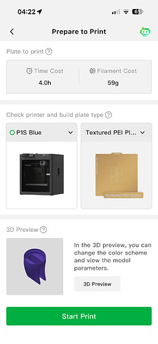

This screenshot does appear to match what I see in iOS Bambu Handy,
Between the time and filament row is a printer & build plate choice followed by the preview thumbnail and button before the start print button which is visually different to that shown in your screenshot.
Are you sure the screenshot you provided is from iOS?
That’s when printing from makerworld
I’m printing from SD Card
