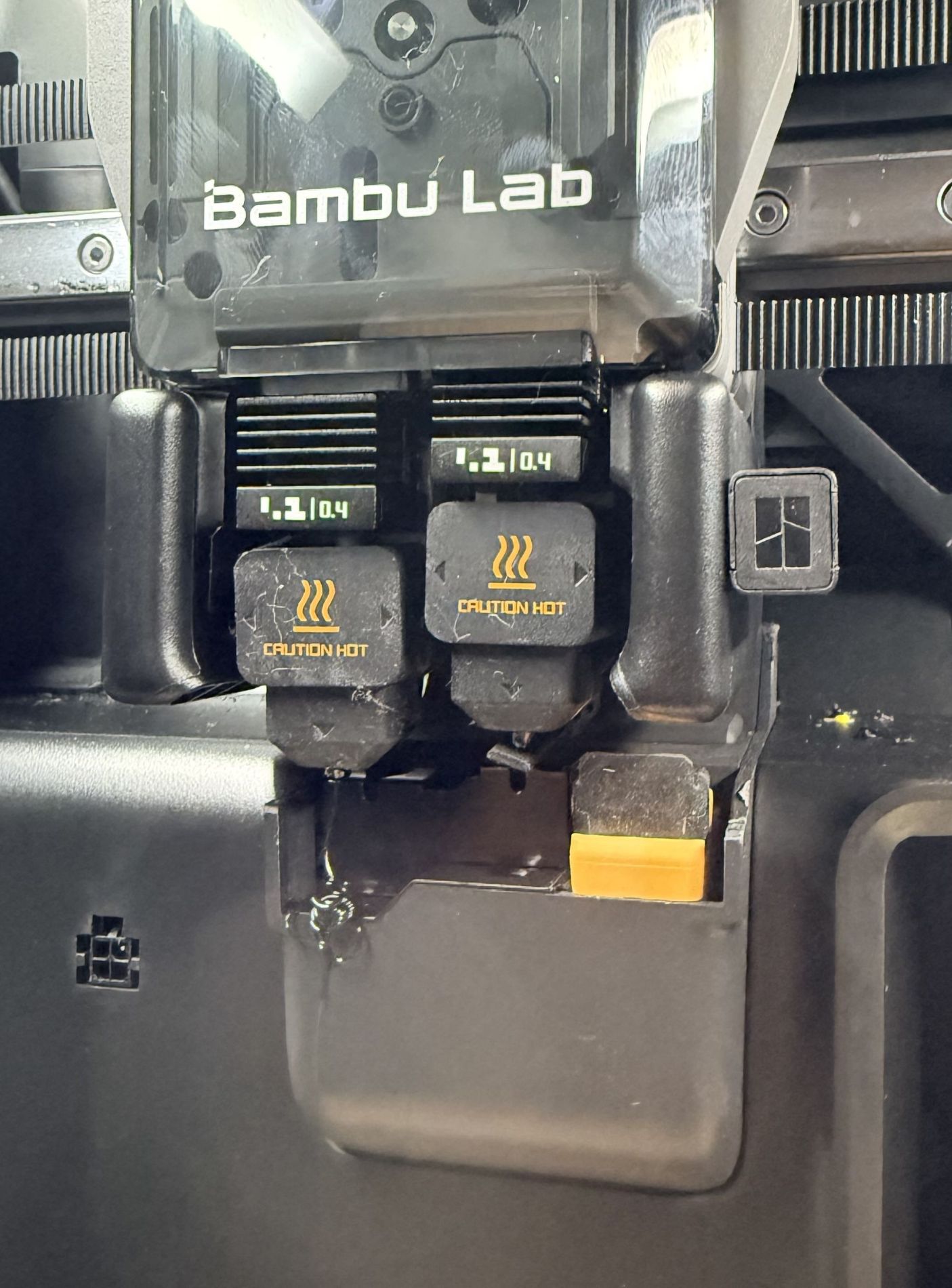

Noticed that the purge wiper wasn’t working; it was always in the position for “closing” the purge chute (picture at end).

Purge wiper stuck in “closed” position

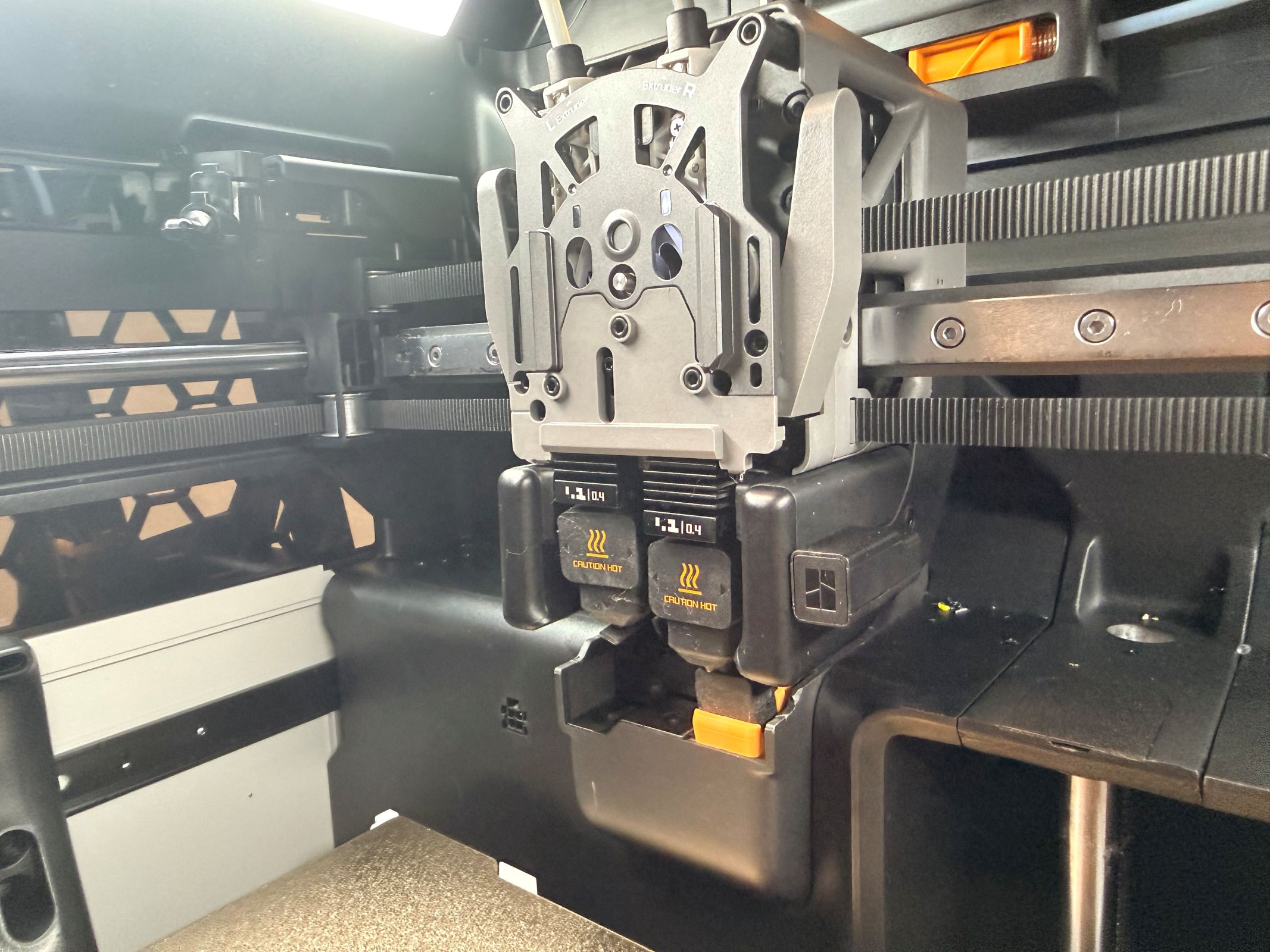

I just noticed that when it tries to wipe, it doesn’t go back deep enough as well, which could explain the purge wiper issue. So something is keeping it from going back far enough, which is also why the cutter isn’t engaging with the side bar to push the cutter lever.
Any ideas on why it’s not going back far enough and how to solve this when I can’t calibrate?
I went around and checked all of the belts etc. for anything out of the ordinary, couldn’t find anything.Tried a nozzle offset calibration and it failed because the nozzles won’t go back far enough.
I manually sent the head back as far as possible and took some pictures; you can see here that it’s not going back far enough to engage the nozzle wiper.
I took a wider picture as well so you can see the state of the belt and the little levers on the sides, if that helps.

The stuck purge wiper seems to be caused by all the poop that is dropped in front of it.
Cleaning that out might get it back to work, but you can check that by manually operating the wiper with the orange levers at the rear.

There isn’t any poop in front of it. It’s not stuck in that sense; it’s just not smooth if I manually push the lever in the back.

Your first image seemed to show some poop in that area. But I think there is more at hand than only a poor nozzle wiper.
You can remove the nozzle wiper for closer inspection. It is a spare part that can de replaced as a unit.

The issue isn’t the nozzle wiper, but that the head is physically not going back far enough. This is the root cause of those two problems plus the calibration issue.
By the way – I just realized what you meant, sorry!
That picture does have poop in front of the wiper, but that’s because I took the picture to illustrate how mis-aligned the print head is. It’s trying to extrude poop and is completely missing the target.

can you push the head all the way to the back manually when the printer is off and the motors are not engaged?
Today I learned you can do this!
This is as far back as I can manually push the head. It lines up with the back of this blocker assembly (not sure about the actual name) though there’s still a bit of rod left behind that.
There is definitely something blocking the Y-axis. Can you determine if the blocking is on the left or right side?

Sadly, all three feel equally rigid. I spent a while feeling around the whole gantry, belt, print head, and the side blocker/triggers, and I can’t feel anything physically blocking the gantry or print head.
It slides freely but less quickly than if I pull the gantry out toward me.
It doesn’t have a chance of hitting the wiper because it’s too high and also too far forward.

The printer head is not contacting anything in the back – there’s about a finger’s width of space between it and the back wall in the pictured state.
