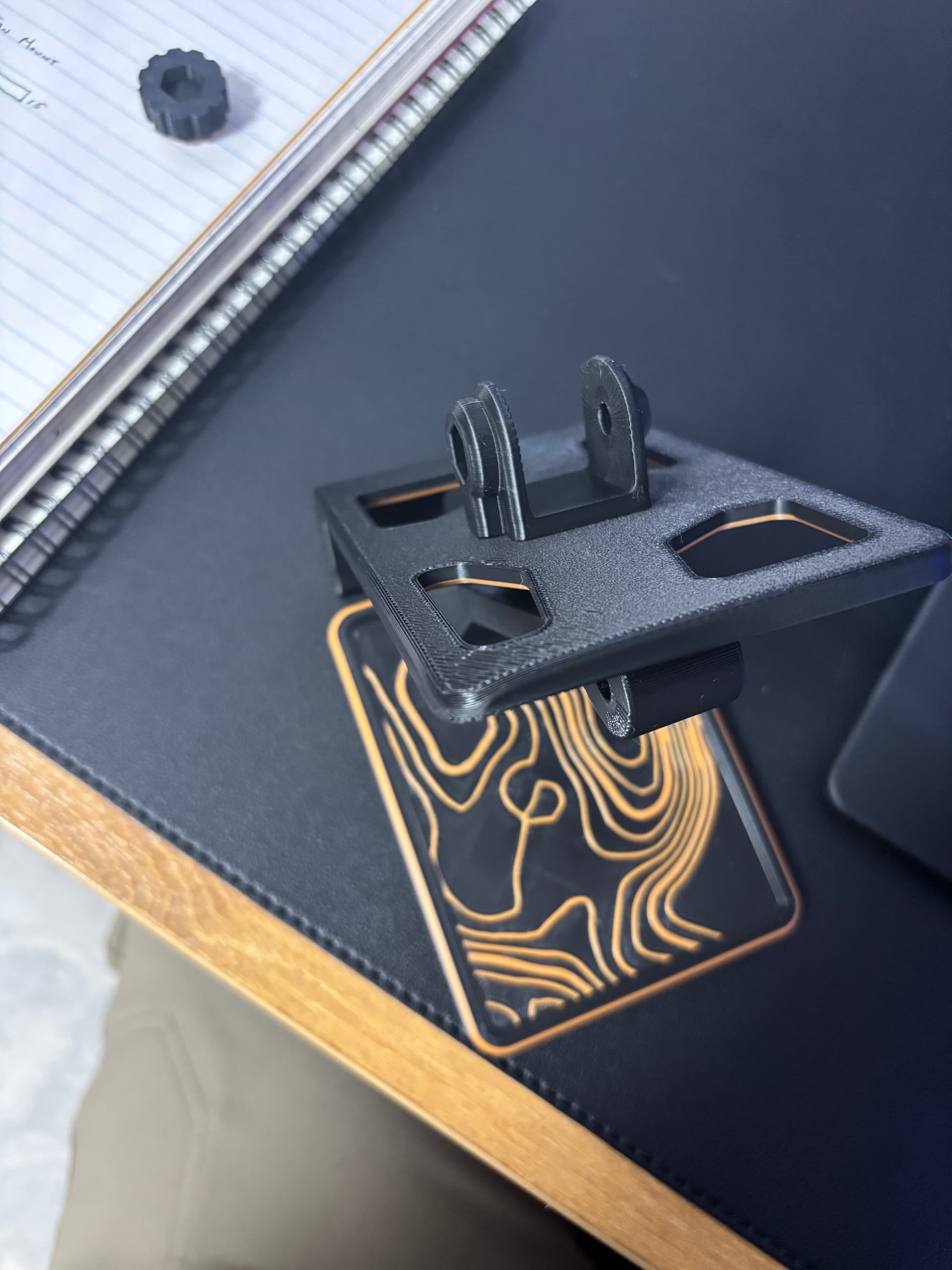

Print issue Elegoo PLA corner deformity

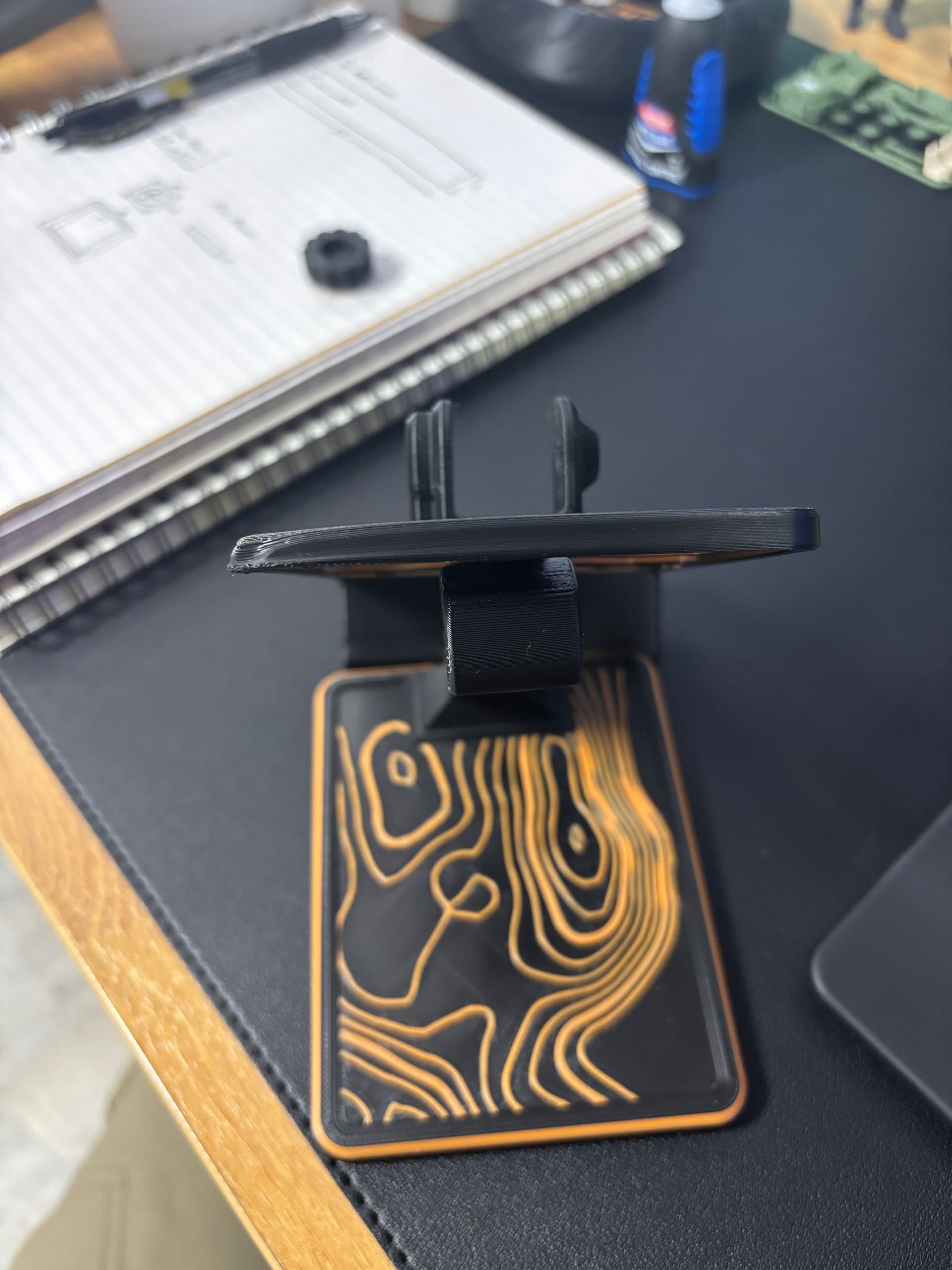

Hi all, I had an issur with my most recent print using Elegoo PLA, which I have always used. I will include a couple photos showing the issue. This particular corner looks a little deformed and I’m not sure what caused it. It almost appears that there was a hot spot on the plate? Not sure.
Plate is dirty in that area. Most common cause is finger prints. How are you cleaning your plate?
Ah! I have been cleaning with Dawn dish soap every few prints.
Another thing to consider is room temp and plate temp. This usually happens due to material cooling to quickly.
A brim can help. Clean plate is also key but what your doing to clean is proper practice.
