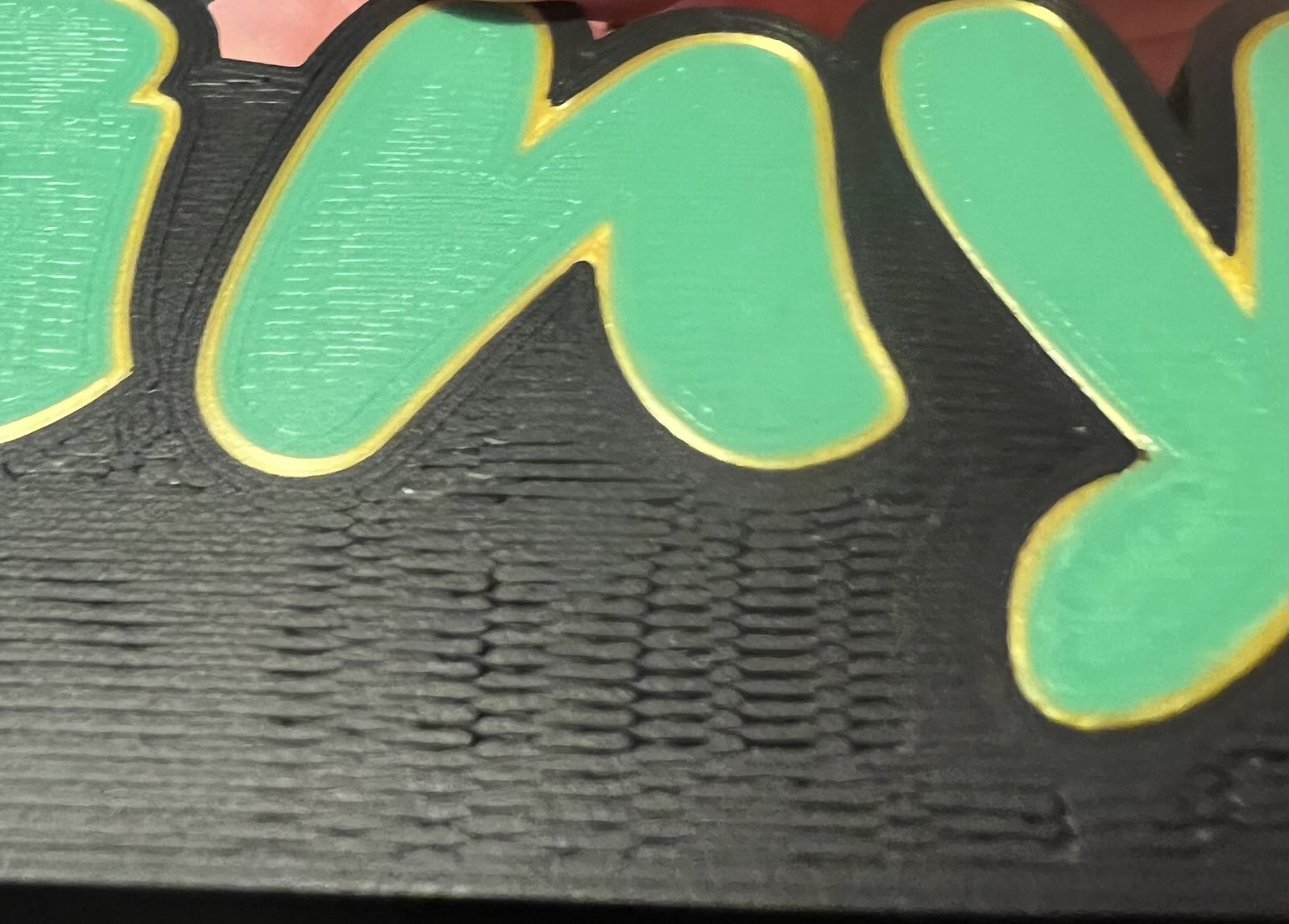

My prints have been going fine. I clean my plate constantly and I cleaned it right before this print so I am not sure why this is happening.
the print was fine except this issue. seems like adhesion maybe but not sure how to solve it since the plate was fully clean and the print stuck as normal I was using a Cool Plate Super Tack.
This doesnt look like a clean problem so much as it does a flow/level problem. Hard to tell on the other colors since there is so little of it, but the black is flowing too much and bulging with nowhere to go.
Try doing a flow RATE calibration on the black. During that test if you see the underside of the chips still having this bulge, then you may need to start addressing auto-level issues (nozzle slightly too close to bed) depending on your machine
It’s the A1 and the issues are mainly happening with the black. I will do a flow rate calibration on the black. Thanks a lot :slight_smile:
