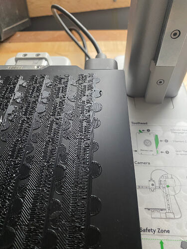

Print issues, Newbie, several attempts. PetHF
I did a single row test print and it worked. Tried printing 2 times with enough to cover the platter. Tried with and without glue stick on two different plates. And slowed the initial pass speed. See pictures for failure. Please advise

Bed adhesion looks fine.
You need to adjust your retraction and z hop settings.

Retraction is probably fine, but still good to look at.
Z hop will need to be increased.

Hi, I tested a single and it printed. Been trying to print several at a time.
I have failed both Mid-print at height separations. And stiction issues,
I have tried both textured and smooth plates and with and without glue stick.
the last pass was my last attempt on smooth. And I spotted that the adhesion
had failed a couple times at the front left, closest to my corner of the plate.
I also had to clean the head from build up a few times.
At this point my guess is moisture in the filament. Although my space only has 20%
or less humidty at any given point. New Mexico high desert.
See pict. Suggestions greatly accepted.
Have you considered slowly building the count upwards? i.e. 1 row, then the next print 2 rows, and the next 3 rows ect…?

I adjusted speed , tried up and down. Didn’t make a difference, tried adding a second layer on the footing. Didn’t spot the Z hop setting.Or the Retraction. And once spotted, which way to make the attempt on the numbers?

I am not really sure what you were doing.
The big thing is that you did not have the parts sitting flat on the build plate. They were at a small angle causing only one edge to be contacting, so you had to have support underneath there. Rafts are also just awful.
I tried it in three different rotations. Including the automatic placement position.
Yes, a couple were horribly wasteful, with very large supports.
This last position was the auto placement.
Your suggestion, please.
My suggestion is the 3mf I uploaded
