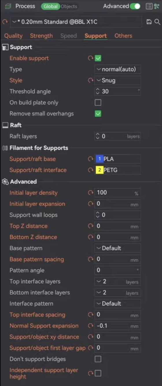

Hi,
I’m trying to stack parts to print separated with a single layer of support material.
I modeled all parts. When I import it, I have 2 issues :
1- If I import it as multi part object, when slicing. It handles it as a single object, So the separator “object” and “stacked object” exterior layer is processed as infill (even though set as different filament). So it ends up having a base layer on the plate and the upper most top layer.
2- If I import it as multiple object, I can’t move them along the Z axis to stack them. It always reset to touching the plate.
Can anyone guide me through it ? i’ve been searching for some info but didn’t find any solution.
Thanks
I know it’s been a while and I’m sure you figured it out but hopefully this helps anyone else who ends up here!
I can’t include links in this post but here is the title of a youtube video that will explain how to do it:
[How to Stack Multiboard Prints in Bambu Slicer PLA with PETG]
This is the video: https://www.youtube.com/watch?v=LCCL4dTaOPQ
That’s extremely helpful. Thank you!
Here’s a screencap of the relevant settings:
