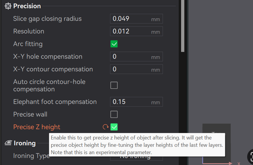

Orca has an option called “Precise Z height”.
I don’t know if Bambu does and I’m not sure if it will help; but it wouldn’t hurt to try a test print.
That said some filaments/materials do “shrink” a bit but nearly 2mm is pretty dramatic…
Bambu Studio entail the option, yet is claimed experimental:
