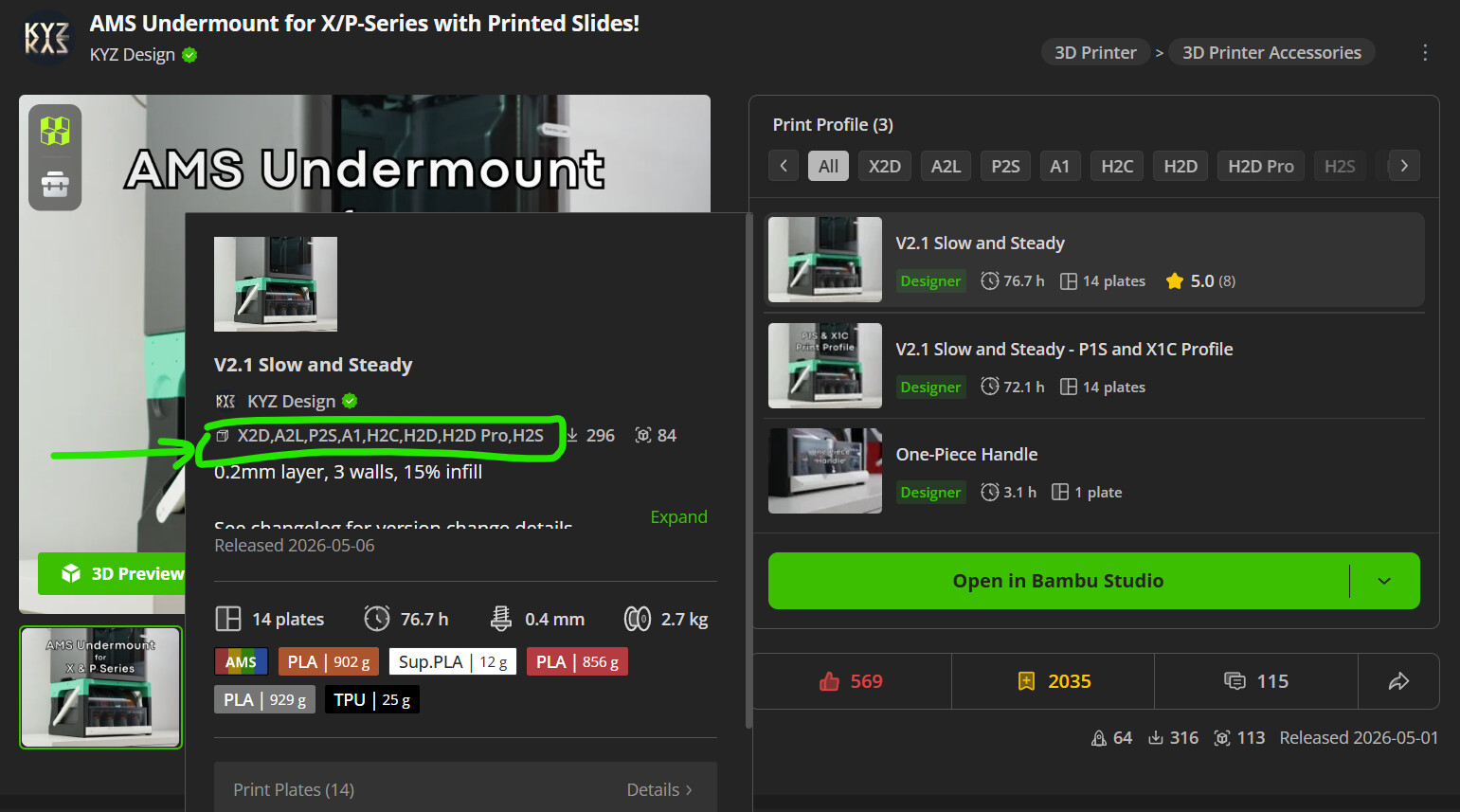

Update: tl;dr: Saving 3MF files from Bambu Studio with A1 printer selected will result in 3MF files that are not compatible with P1S, X1C, P1, X1 and X1E on Makerworld. Workaround is to change printer type to P1S, save the profile and reupload.
I noticed my newly uploaded print profile is not compatible with the P1S and X1C, even though I designed it for my A1 which has always resulted in a broader printer compatibility.

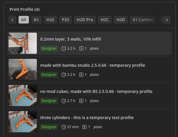

The following did not help:
  • Using latest Bambu Studio 2.5.0.66
  • Removing the modifier cubes
Update

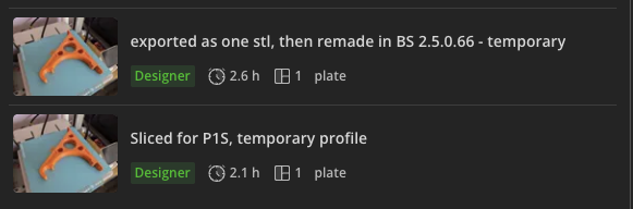

Adding a simple 3MF, three cylinder primatives, unlocked all of the printers, which means it is something with my profile.
Update 2:
If I take the ‘Exported as one stl, then remade in BS 2.5.0.66’ profile, open it, change my printer to P1S, slice, save, then upload the profile again, calling it ‘Sliced for P1S’ the P1S and X1C, X1, P1 and X1E profiles will suddenly appear.
We didn’t have to do this last week, right? Feels like a bug, adding bug-report
I also changed all of the profiles that weren’t compatible with the P1S to private, then loaded the model page in an incognito window and the A1 printer is still valid with the P1S sliced profile.
So until this is resolved, designers should definitely switch their printer selection over to P1S before saving the 3MF and uploading to Makerworld.

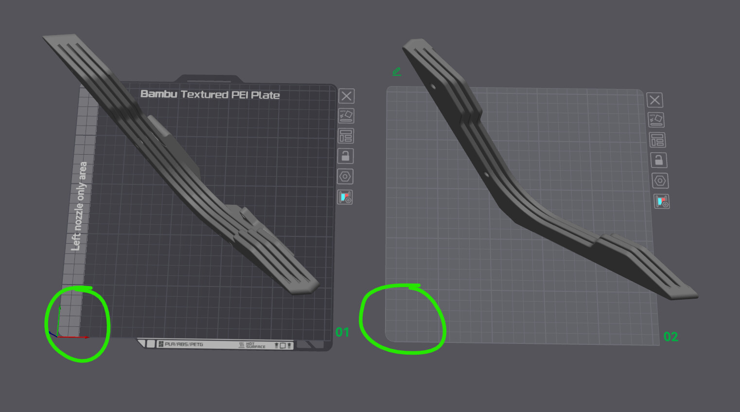

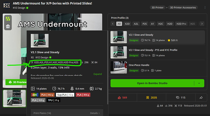

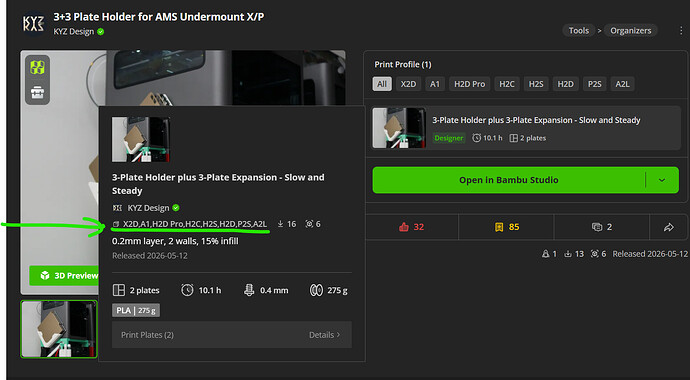

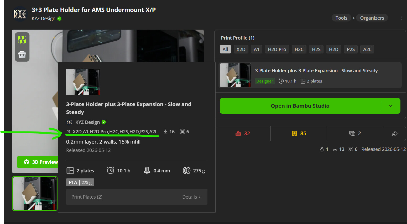

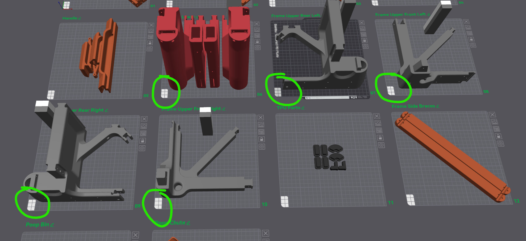

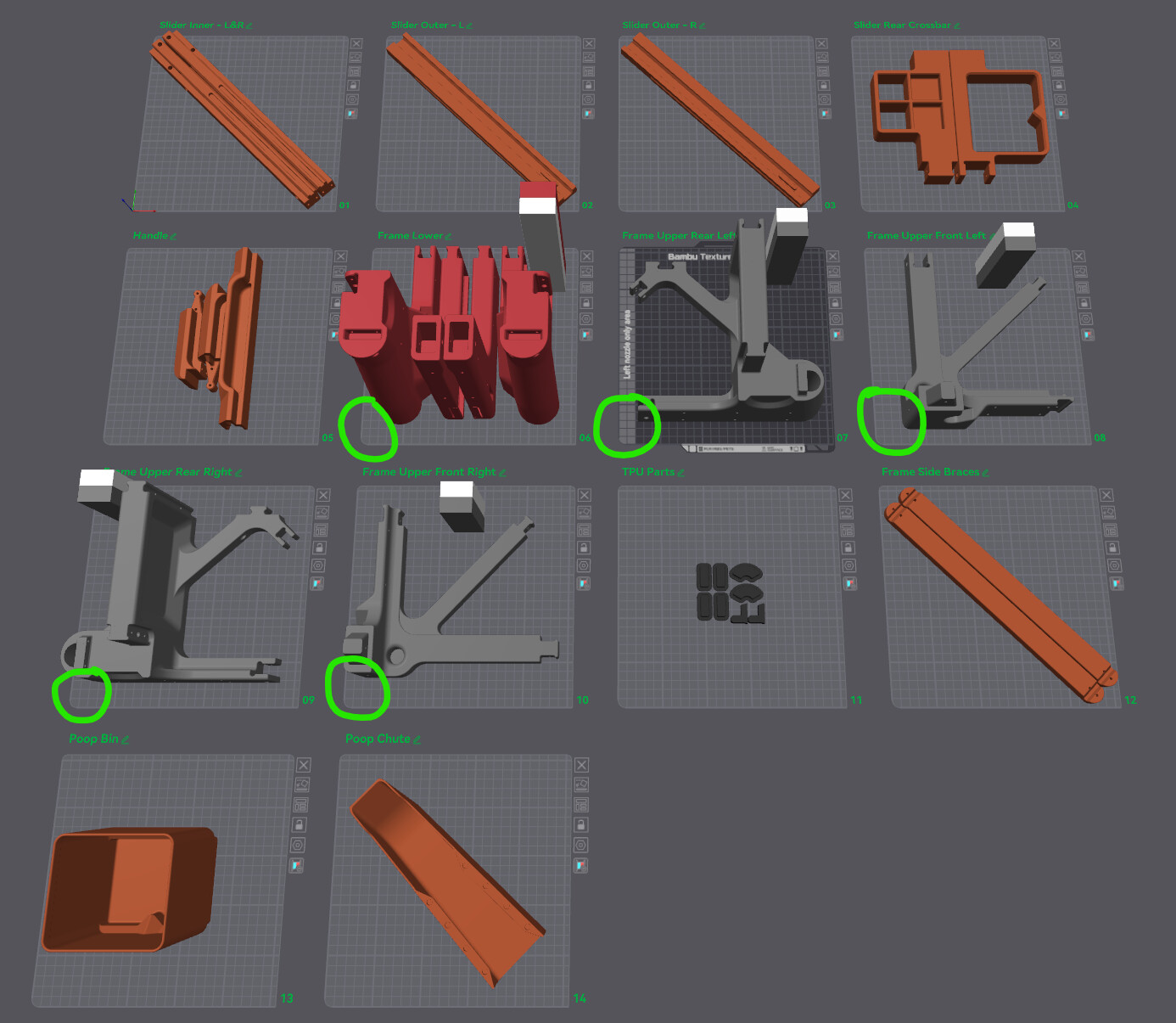

I am having the same issue. I had to make a new profile just for the X1C/P1S. I want to keep the main profile based on the X2D as that’s what I use. This is affecting multiple models sliced for the X2D. Example 1:
None of the parts are in the cutter exclusion zone on the front left:
If I open it and change the printer, there is plenty of clearance:
Example 2 - this is a much simpler model with just one filament…
