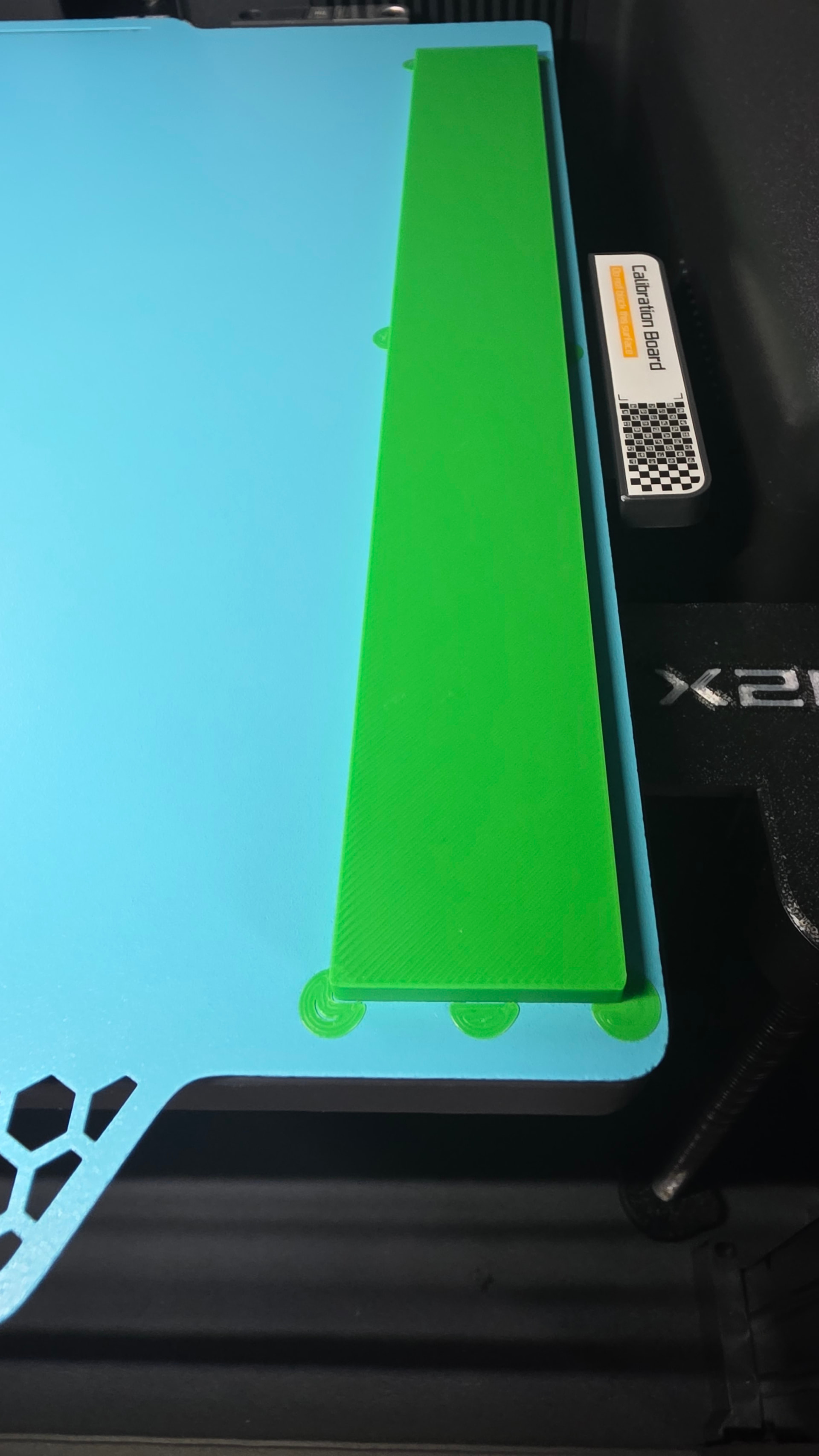

I submitted a ticket with bambu and they gave me a few things to try, some I already had and one thing I hadn’t. The later being to manually adjust the bed level.
I have now done this and after that was complete I done a full calibration on the printer. I then ran another print similar to my previous one but I added mouse ears but unfortunately I got the same results once again, perhaps a worse result I would say. I then ran just a simple 60x60x8mm print in the corner I’m having issues in and it printed fine.

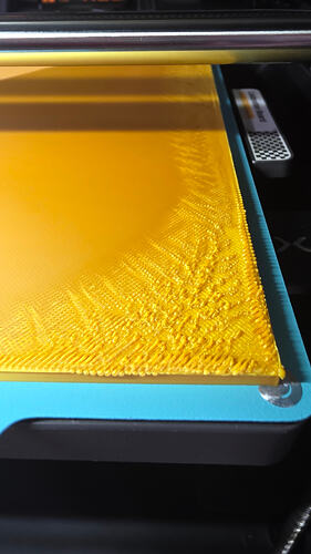

I have attached a couple of images to show the results of the larger print.
It’s still doing what I said earlier.
The difference here is you can really see more of the model since the golden/yellow color.
I’d say you are fighting 2 fronts, one being you need to calibrate your flow rate. It looks like you are pushing so much filament you are almost ironing while laying down your top layers which is pushing all that excessive filament over the edge.
As badly as we all want the top layer to be like glass, 3d printing perfect extrusion is not like glass in the horizontal. (why ironing exists to try to get it there).
You can clearly see it’s got so much extrusion that you can see both layers criss crossing each other in the middle. That is one of the reasons the model is probably shifting. The stress from excessive material.
When you measure the corner with a pair of calipers compared to measuring furthing in where it’s not plowing, how much height difference is there?

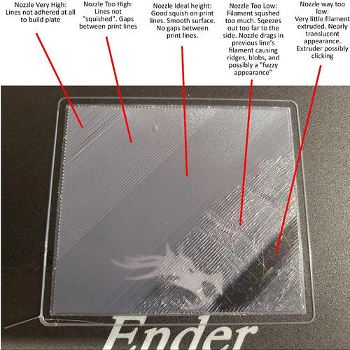

See what a “perfect’ish” extrusion should like like here:
Edit: Just as a quick test to comfirm, you can right click on the build plate and add a cube. Make it something simple like 15x15x15 and print it with your exact settings.
If you are extruding the right amount of filament, you should get all corners of that cube measuring the same (within a few thousandths) with a set of calipers. The edges should also look square and straight. I’m guessing the cube will show that you need to calibrate your filament.
It’s a familiar picture, it was the same. I changed the nozzle to a new one (Perhaps there were remnants of the old filament ABS in it), and changed the PTFE tubes to tubes with a large inner diameter and slightly shortened the tube of the left nozzle to reduce bending (after that, the AMC began to feed the filament without difficulty, perhaps before that it was supplied jerkily). I do not know what exactly helped, but the situation improved. I also performed flow calibrations and all standard printer calibrations, including high temperature calibrations. I also washed the detergent plate very well and did not touch it with my bare hands. After carrying out all these procedures, I corrected the situation. Before that, I tried manual calibration of the platform and adjusting the height of the nozzle, nothing helped.
Also, to test the theory with the material supply and dirty nozzle, try to print only with the right nozzle after washing the plate and calibrations.
Why the problem only appears in front, then there may be 2 options, you always take the plate from the front, and the second, when the head is in these positions, the bending of the tube becomes critical and the filament disappears. Another test option is printing without AMS, feed the filament directly to the extruder

I will give this a check tomorrow but what I will say is I have done the flow calabration a few times now I’ve also done a manual bed leveling as bambu support suggested this which was out so I thought that was the issue, clearly not. I did run a print earlier that was the full length of the bed 50mm wide and 8mm high and it came out perfect, now I know that’s not proving much as it wasn’t as large as before but I wanted to try just that corner and up the edge where the cold air output was.
I will check with calipers tomorrow and let you know. My mind is telling me why just that corner​:man_shrugging:t2: I totally understand what you are saying about it lifting/shifting but I’m wondering why just that corner. I had an idea that I could maybe somehow secure the plate to the bed in that corner but I’m not sure if that would even prove anything

I did capture some pictures of the print I done yesterday which I have added. Having a think about this happening, could my bed temp be to cold? As you see I’m using a cool plate and I have noticed the pre-set temp is lower than usual.
Also I will print the 15x15x15 cube later, is there any particular place you recommend I print this on the plate?
