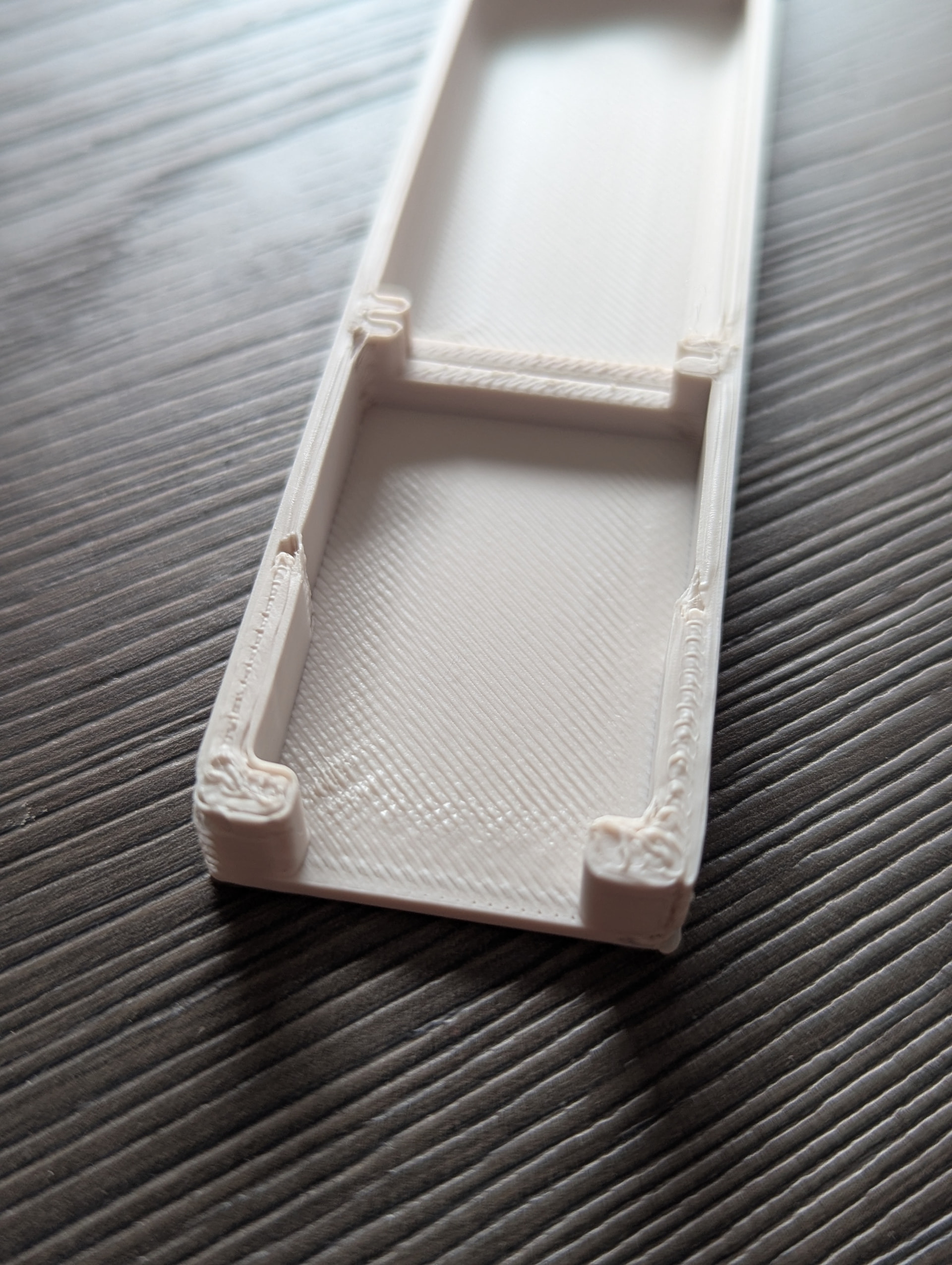

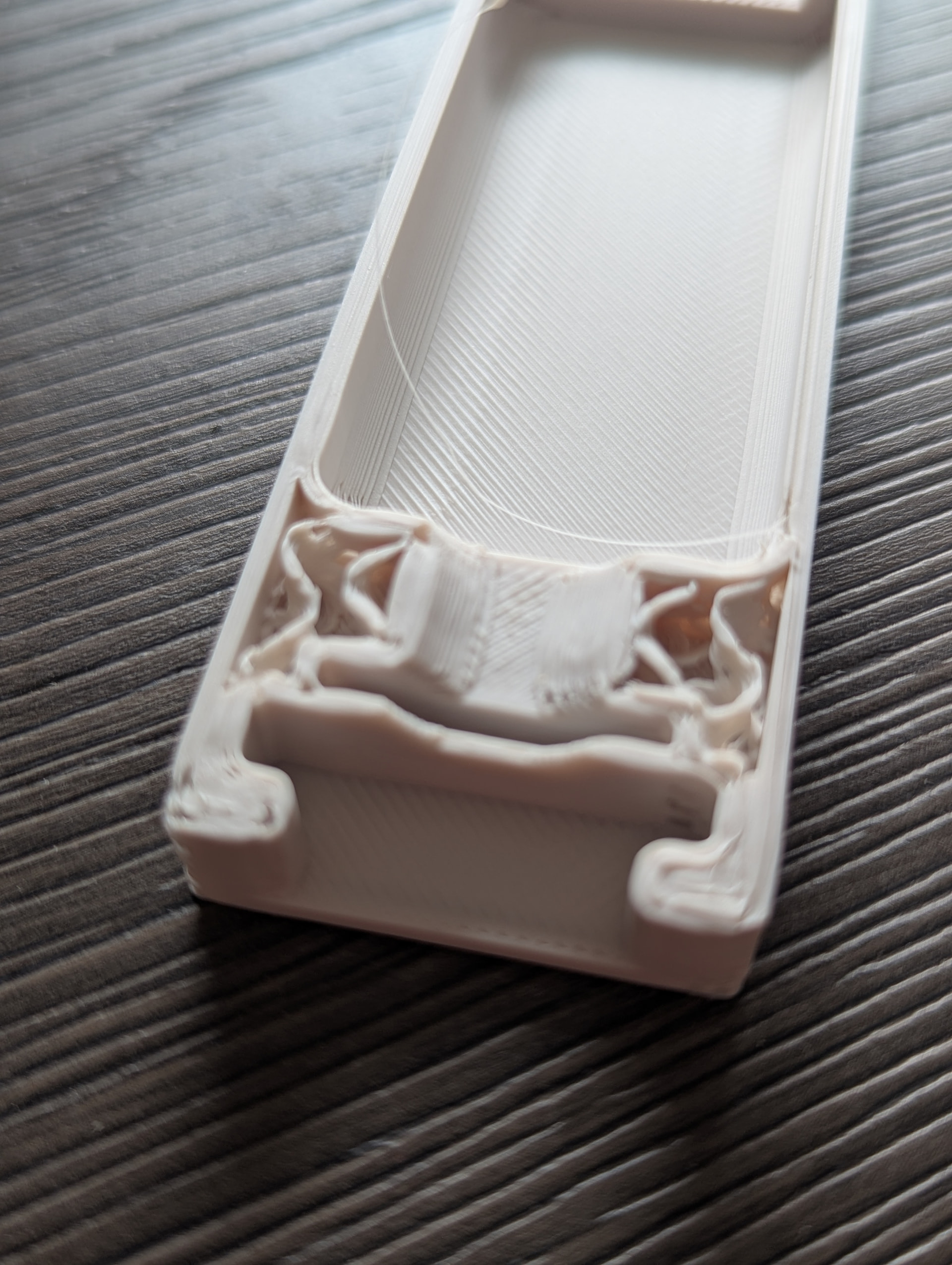

For some time now, I’ve noticed a significant drop in print quality with my X1-Carbon, and I don’t know the cause or how to fix it.
I have performed all the maintenance steps:
  • Cleaning carbon rods
  • Cleaning and greasing Z-axis lead screws
  • Y-axis and Z-axis linear rods
  • Cleaning extruder and hotend
  • Replacing the hotend
  • Belt tensioning
  • Cleaning the case :wink:
I can’t get decent results on simple prints using the default profile with Bambu PLA Matte. I only get normal-quality prints again if I cut the speed roughly in half.
What can I do?
You covered the best practice parts. Just to confirm:
  • Your did dry the Filament (again)? Due to the higher pigmentation, Matte picks up more moisture much quicker and dry storage usually can not keep all moisture out.
  • You did run through the printer and filament calibration routines after the maintenance?

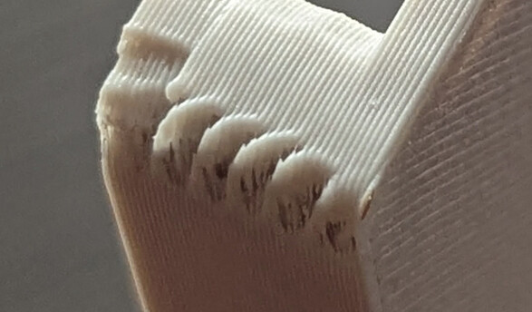

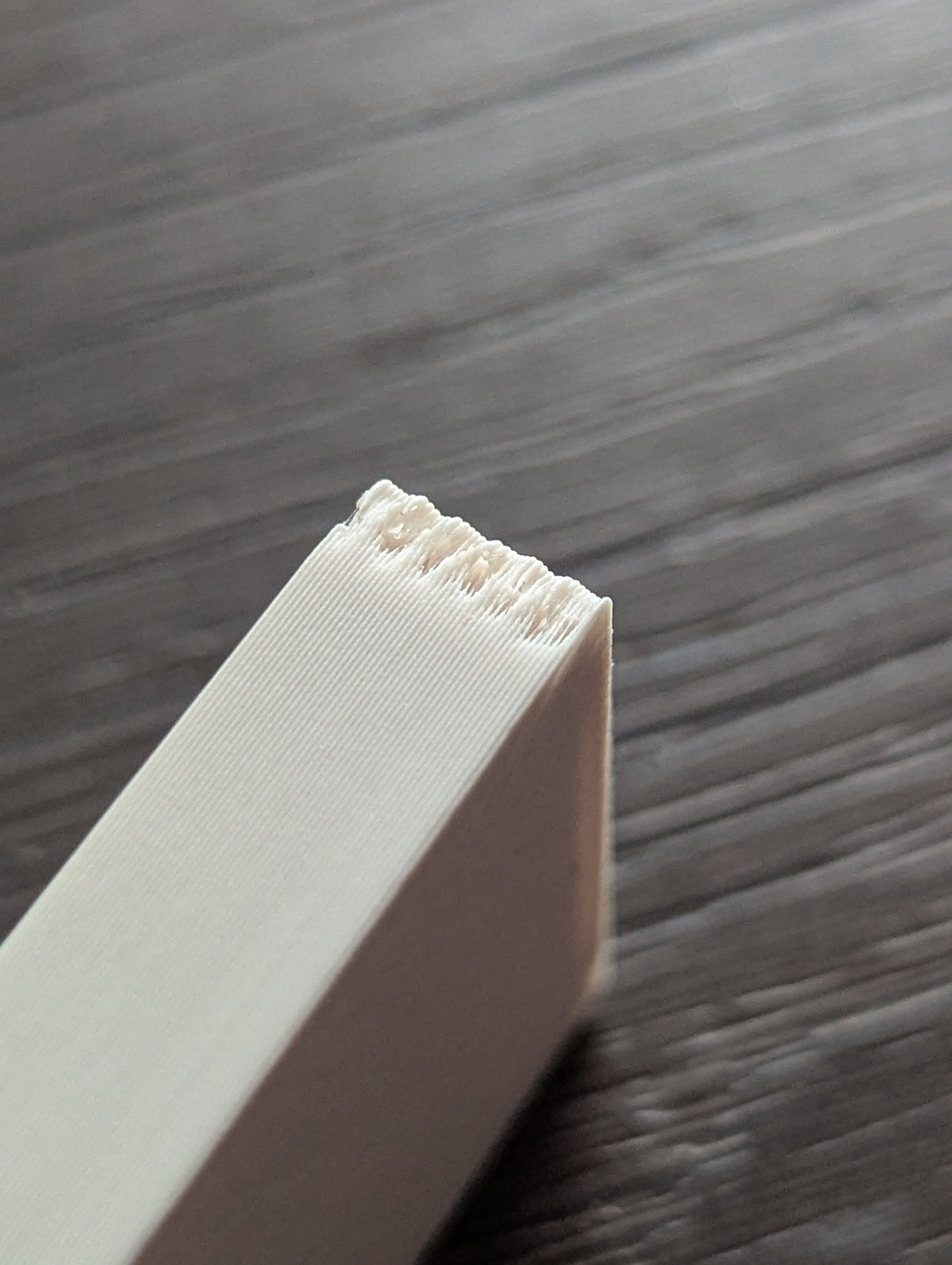

To me, the edge defects hint at edge curling which can happen at high speeds, especially if there’s moisture in the filament (longer cooling times => softer underlying layers enabling “better” edge pull-up).
The messy infill (highest flow) and low layer adhesion (edges and inner circle outer wall pull off) point into that direction, too.

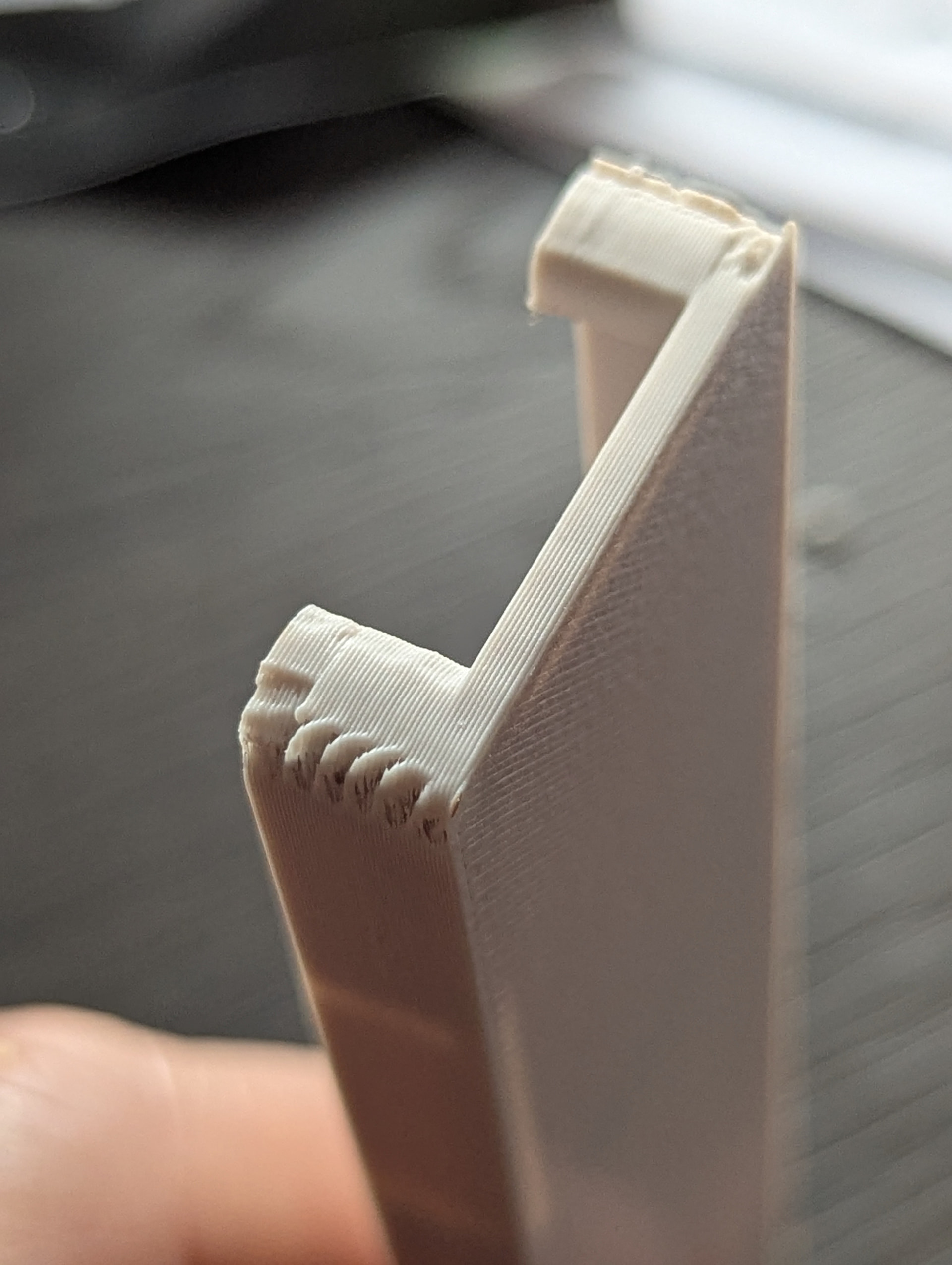

This looks like pressure advance/K factor + speed mismatch IMO
Extrusions are slowing and ramping in that corner [not well] and that is the domain of pressure advance. Unless we’re looking at a gnarly and horrific seam.
I dont have a good eye for matte filament, dont use nor like it; but I’d also listen to the others and dry it anyways, cant hurt.
Ill just throw this out there. It looks like you might need a new nozzle.
I’ve implemented all the changes now.
I’ve done all the calibrations—flow and dynamics—and dried the filament.
I also installed a new nozzle.
I’ve reduced the speed now; unfortunately, there’s no other way.
