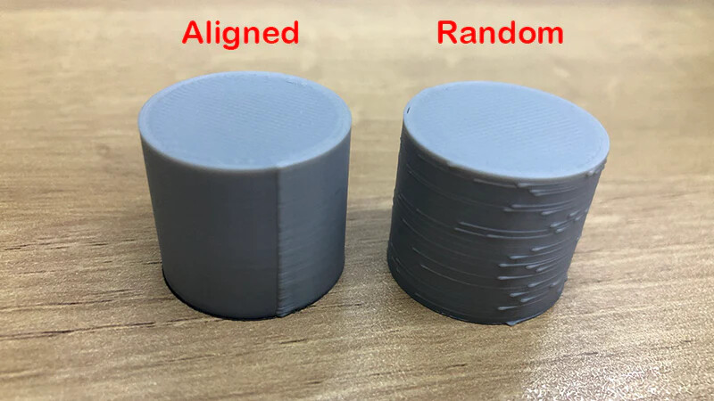

does Random Seam cause this? I may have turned that on for this print :(. Might have solved it before I had to do anything. Thank you if that’s the case. I didn’t want a uniform seam - but didn’t know that caused it to go wonky. I’m letting the print finish, so I haven’t taken anything apart yet to check. There are so many variables that changed, that in my mind I thought left nozzle first. Didn’t occur to me the seam may have done it.
I need to google Automatic Flow calibration - is that a setting from studio when you send a print? or something else?
lol if it’s on then this makes perfect sense
yeah it’s a toggle when you’re sending the print. it calibrates pressure advance (instead of flow rate)
Absolute hero if that’s the case. Thank you - seriously. Why does it do that? I thought all it did was not have a uniform seam. WOW - guess I should have read about it first. That setting shouldn’t be there if it can do that.
random seam improves the structural strength by not having an aligned seam somewhere that is prone to break. Seams are usually weaker.
The problem is that it also causes ununiform extrusion across the surface (seam itself is a sort of ununiform extrusion, so randomizing it = having bad surface), making it uglier.
Usually there would be some corners for a part to hide the seam, but if there’s a round object like the image above, then there’s no way to really hide it except from using scarf seam. However, scarf seam has its own challenges as well, for example it works very bad on overhangs.

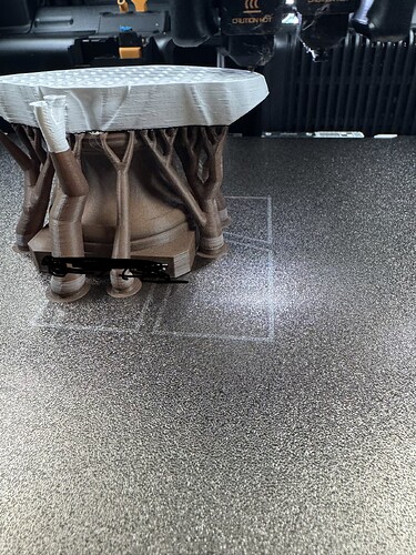

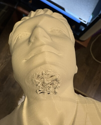

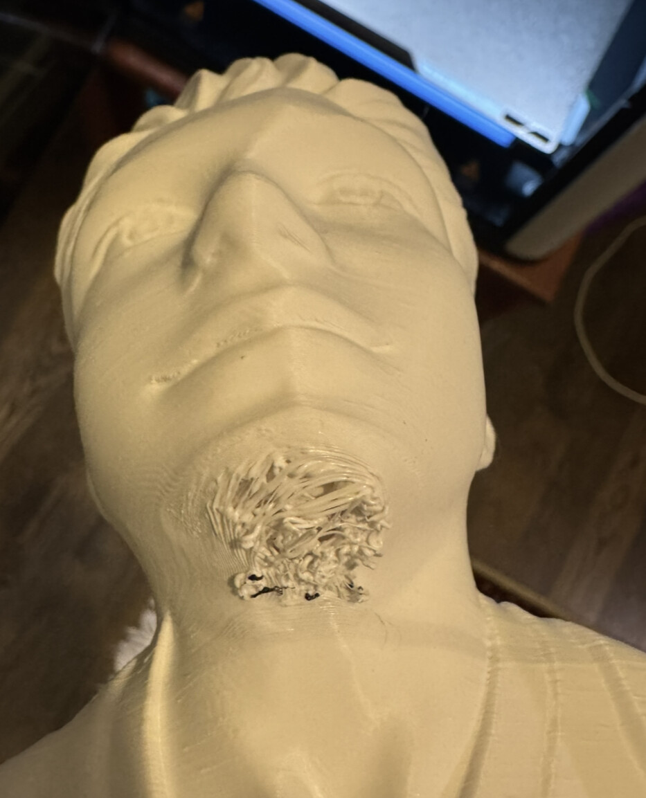

Speaking of failing - something is off on the supports. I feared scarring, but didn’t see this happening. Any setting I should look at?
I had a large gap from support to model with petg. Maybe I should have done 0 offset.
Or do a gap and PLA support. But don’t do gap and petg?
it’s very tricky to print these features. you can try use tree suport with Support for PLA as Support Interface with 0 gap.
Don’t bother with PETG as support interface, it’s not worth it.

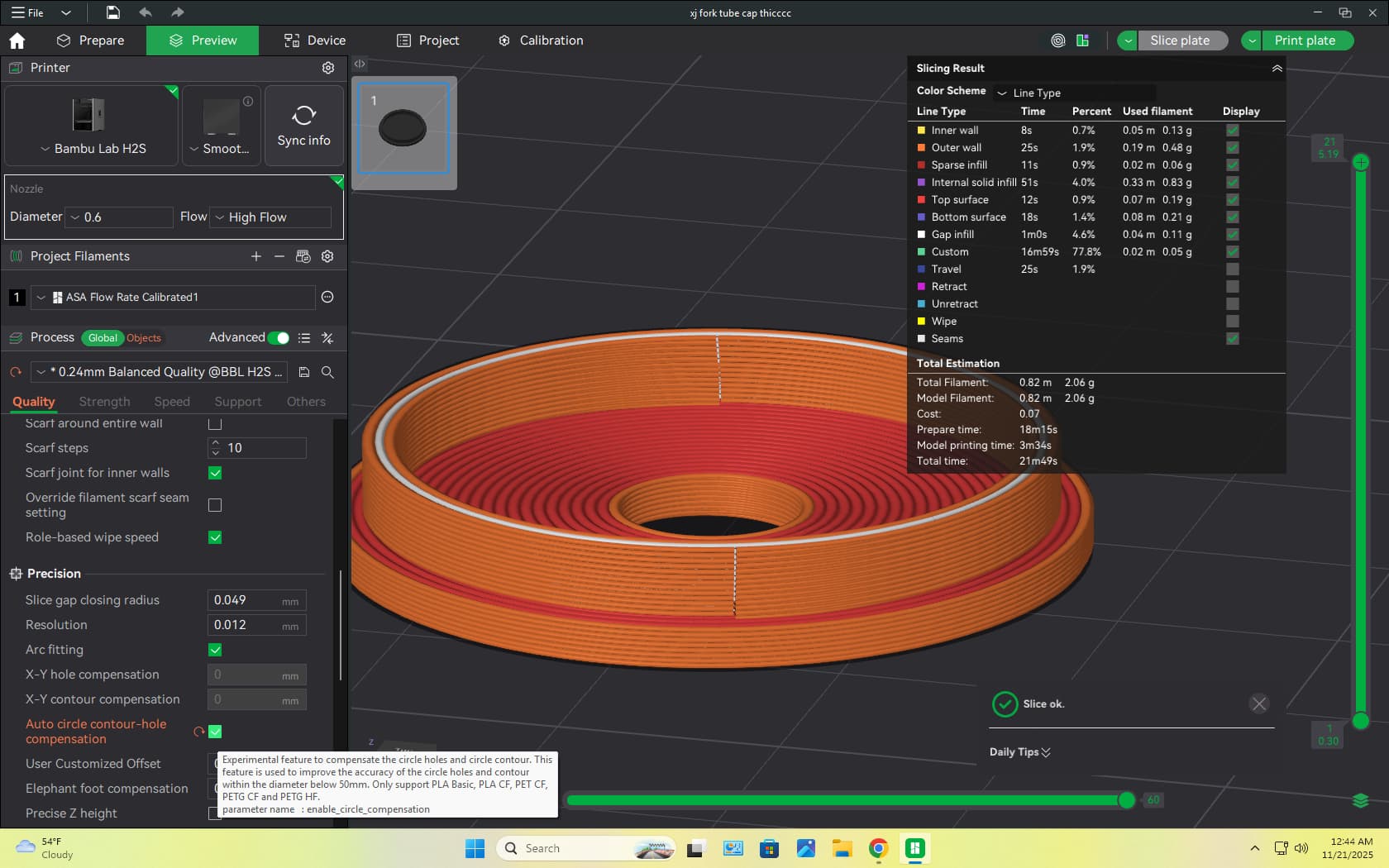

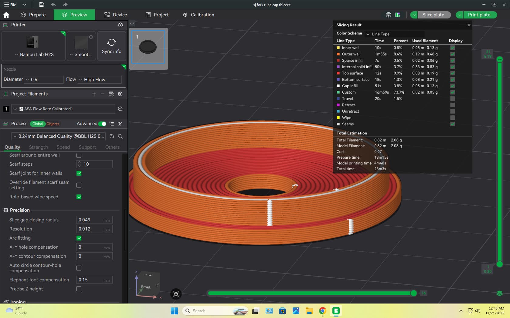

Might try going back to default aligned, then select auto circle contour hole compensation it cleans up seams pretty nicely for my models despite being in Quality>precision and not being in seam settings. I’ve been having a ton of problems with tree supports since my most recent roll of ASA but also started after the most recent Bambu Studio update also.
