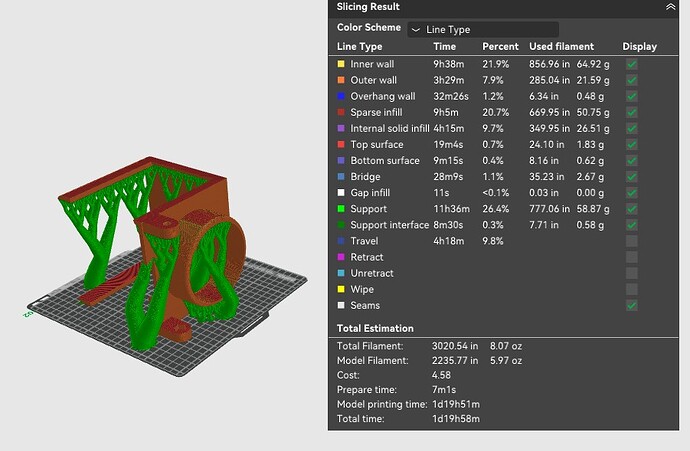

I’m very new, but the print time seems crazy long on this. Am I missing something, or is that just the reality?

eSun PLA. I created it in fusion and then transferred it over to bambu.
I have never seen someone have their filament estimations set to imperial units. I couldnt tell you how many oz are in a kg off the top of my head.(not a criticism, it just threw me off for a sec)
The easiest thing to do is share the print profile
What sized nozzle are you running and what layer height are you printing at? I’ve had 36 hour prints when using my 0.2 nozzle to do 0.08 layer height. So this print time isn’t out of the realm of possibility. Also because of the supports, it’s add a lot of extra time.
I’d suggest turning off the supports and reslicing just to see how much of a time difference it makes.
Adding to what’s already been said here: Saving time starts with the actual 3D object itself. This doesn’t look very optimized to me - it’s downright 3D printer-unfriendly.
In your case, the biggest way to save time is to avoid support. That alone is eleven hours you could potentially save.
Try different orientations, and if you can edit the object itself, experiment with curves, rounded edges, slopes, etc. Of course, I don’t know what purpose that object serves, but there’s certainly enormous potential for savings.

This appears to be a functional part rather than a decorative item. Thicker layer lines will print quicker and be stronger if appearance is not the main concern.
Over nineteen hours are spent printing supports, so reducing those will save some time. Try reslicing with different faces of the model on the plate.
The top part appears to have a flat solid plane on the right rear; put that on the bed. That eliminates the supports on at least two edges, though both of the ears might then need support or a different design. @RetroSharky’s suggestion would also make those features stronger.
Try putting the second part’s rectangular frame flat on the bed with the two angled legs in the air. The two arms might then print without support; that could save 7.5 hours. But consider the forces on the parts; this orientation could lead to breakage along the layer lines.

It is a 0.4 nozzle. That is just what the machine came with. I have not tried any others.
It’s a dust collection shroud for my table saw. I’ve done woodworking for years and only know imperial.

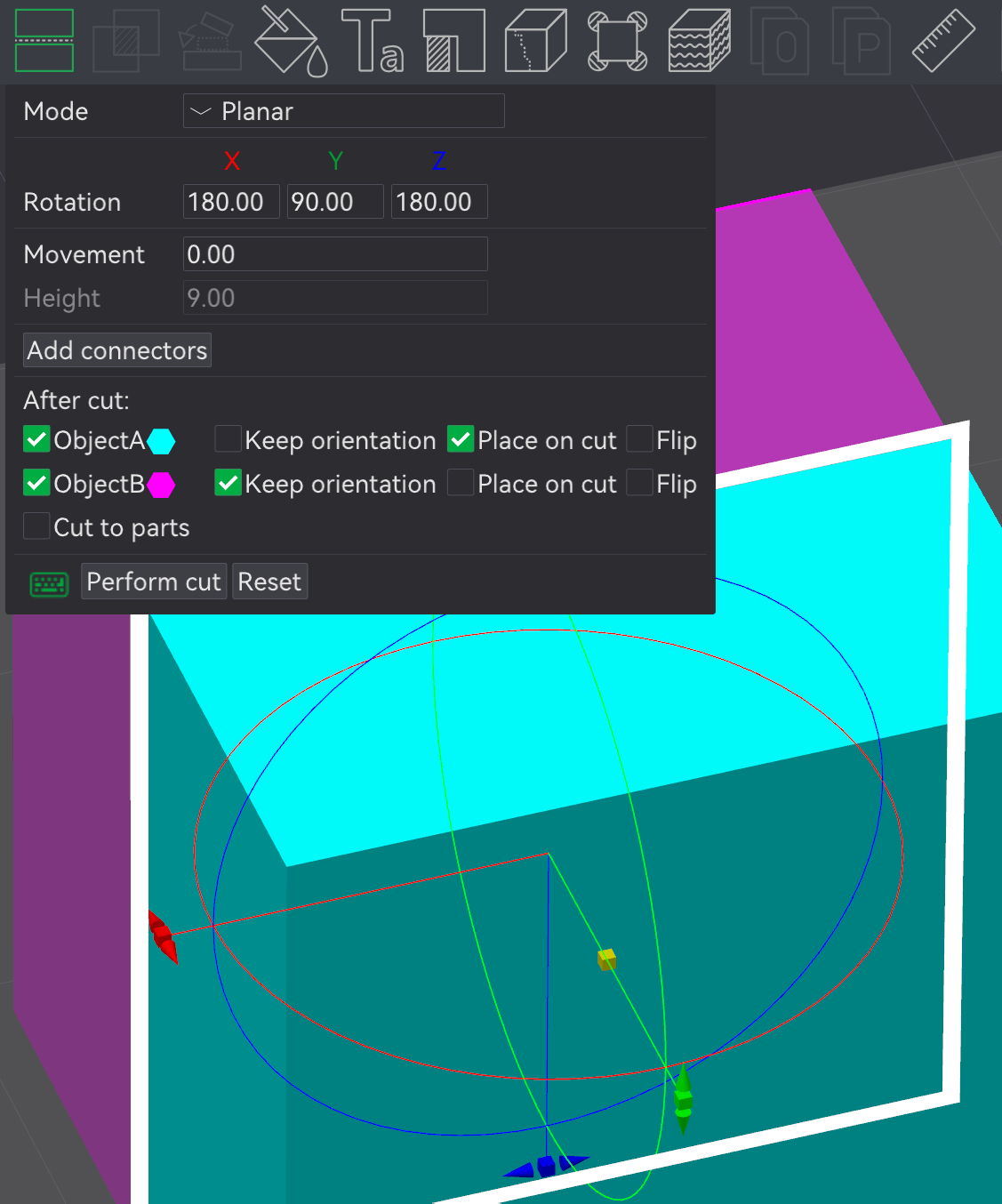

Maybe I should just make several parts and piece them together rather than one big part?
Bambu Studio has a nice feature for beginners that lets you split an object and insert joints. Once you have more experience, it’s better to do it in CAD, but for beginners? It’s great! Just add a little superglue, and you’re done.
If you want to do it properly, you can also use nuts and bolts. There are also special threads that you can insert with a soldering iron. They don’t cost much and are super handy.
