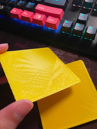

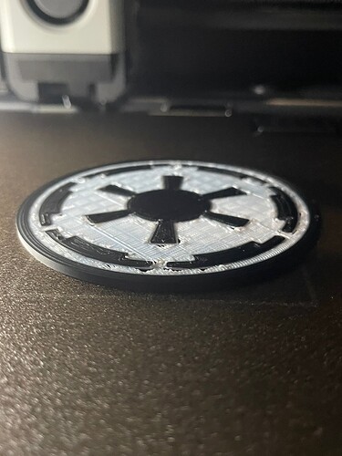

just recently go this printer and am a complete beginner in this area. want to know why my prints have been failing recently and the layers are looking scuffed and wavy

Overextrusion, or the printer extrudes more plastic and the excess just curls up
Change flow ratio down a bit, like 0.95 to 0.90 and see what happens.
You can follow instructions from the internet to “calibrate” flow rate and generally give you good result.
You have to do the flow rate calibration (people just says calibrate) for every new filament. Even the same filament brand and type, the figment or dye inside the plastic makes it print slightly different.
The yellow rectangle points me to bed leveling issue. I have seen more of these here in this forum.
Some would also say you need to dry your filament.
