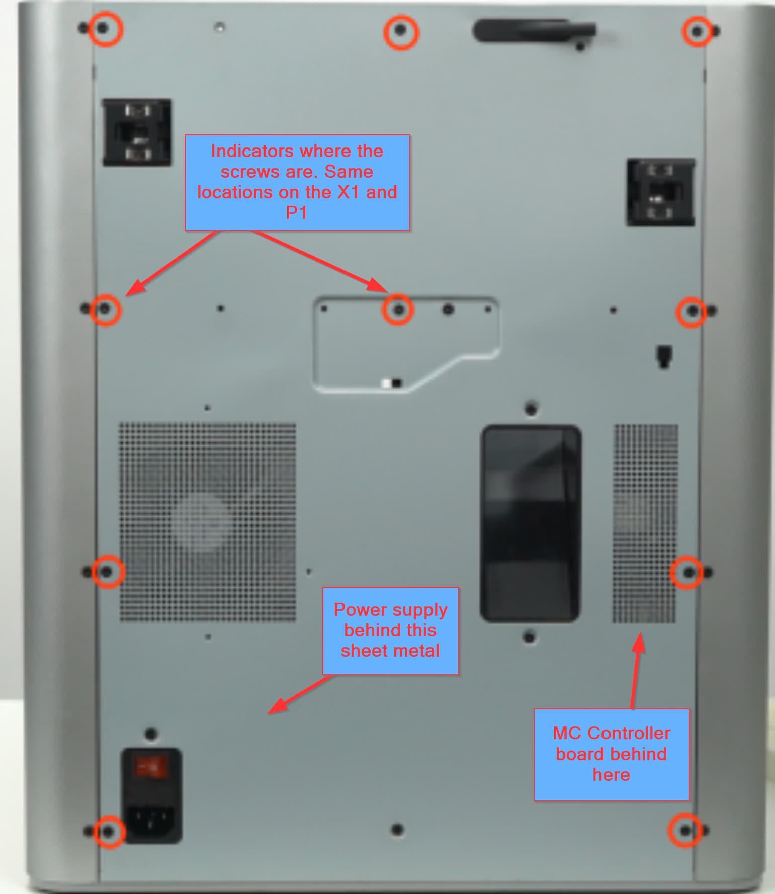

On the other hand, does the clicking sound seem more like the sound an electrical spark might make? The kind of sound that one might hear if one was using a lighter with a piezo arc? If that is the case, it could be something worth investigating, more specifically, see if you can smell something like an ozone-like smell which could indicate arcing of a component such as a capacitor. This is hard to track down as it may be to small to see or hidden. In that case, remove the rear cover, run the printer and then turn off the lights in the room and wait for your eyes to adjust to total darkness. Then turn off the printer and see if you can view any sparks from the electronics. I’d be looking first at the power supply which has the high voltage capacitors and then look at the MC board.
Here’s the wiki page for the X1 on replacing the power supply but it’s the same procedure on the P1. It will show you how to remove the back panel so you can inspect it.

Anyway, I took another look and I believe I was wrong about the location. It seems to be coming from the heatbed.
I haven’t tracked down the exact issue but I’m getting closer.
