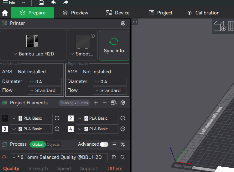

Prepare Tab
Here you are deciding which print will be used to print this set of build plates and the models placed on them.
You do this so you know where you can and can’t place things. The A1 mini has far less printable area than any other printer. The A1 can print more than the P or X series. Knowing this and getting it right helps you print successfully and if you share these profiles with others, they will have things ready to print on their printer.
You can select a printer you do not have to see how it might work on that.
You are preparing the models ready for printing.

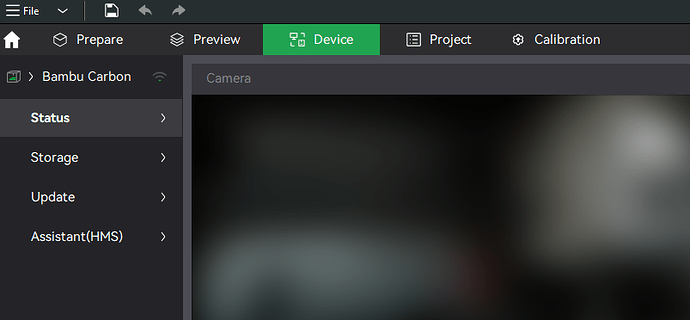

Device Tab
Here you are controlling the printer or multiple printers you have connected. It has nothing to do with the job you are preparing.
You are setting filaments and more if you do it here rather than the directly on the printer.
You can set value for temp and other factors related to where the print head is. You choose if this printer, the one you are talking to having set it, has optional settings like AMS auto refill, these are performed by printer, if you have more than one, you need to set if for each.

What you do in the Prepare tab is all about setting up the things you wish to print.
What you do in the Device tab is all about configuring and monitoring your print.
These are two different things for two different purposes.

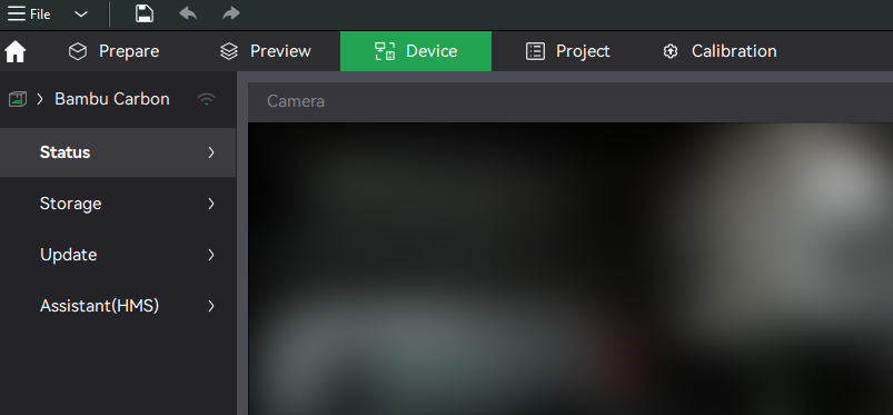

But now I have X1C and H2D, and half of the time BS opens with the wrong printer active.
I change often change filaments in the AMS between prints, also nozzle sizes, and it makes sense to sync the printer before setting everything (in Prepare), but first I have to check the active printer (in Device).
Even if I get the correct printer, I don’t see it in Prepare and have to go to Device to check it.

A it is, I can’t setup the model in Prepare without going to Device.
Or can I? Maybe I will just change my workflow… now I see that syncing the printer before setting up the model is just a shortcut, setting filament type, nozzle size etc. by hand won’t be that cumbersome :thinking:

The Sync button is ONLY there to save you the time of manually setting up the pool of filament choices in the Prepare Tab. Once synced, there is no association between the device and the Prepare Tab.
It takes a snapshot of the AMS contents for the currently selected printer from Device Tab, you could then swap one spool for another and the Prepare Tab would have no idea, as you have not synced (snapshot of the AMS) it afterwards.
There is no connection between the filaments in an single printer you have connected and the pool of filaments you have shown in the Prepare Tab.

Actually, in my opinion it goes against what you say - Device tab is for monitoring the active print, not for preparing the print, right?
I just want to stay in Prepare/Preview up to the print start - and it is not possible just now. Well, maybe sometimes. In my case there is 50% chance that I have the wrong printer active.

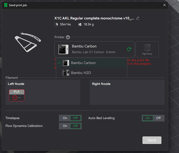

  • lets assume that BS is started with printer 1
  • you setup the print for printer 2, just as you suggest, bells and whistles, nozzle set, filaments sorted, checked everything in preview, ready for print
  • click Print, and the warning pops up - alas, wrong printer

This assumes you have decided to ignore the printer drop-down in the print window, as I stated earlier.
I have to assume that you “setup the print for printer 2” that you intend to use printer 2. When the print window appears, showing a printer choice dropdown as a choice:
  • Printer 1
  • Printer 2
You select printer 2.
You are off to the races, you are printing, no wasted time, and you used the software as intended.

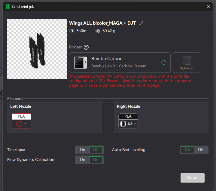

New instance of BS, last saved project was for X1C
Print prepared for H2D
Slice plate, Print plate
oops…
haven’t checked active printer in Device tab… again…

You said you set it for printer 2, yet you are now complaining you didn’t set it for printer 2.
Using your printer names:
  • You setup a print for the H2D
  • You slice
  • You go to print
  • The drop-down shows the X series
  • You get confused
  • A little angry

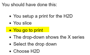

You should have done this:
  • You slice
  • You go to print
  • Select the drop down
  • Choose H2D
Why are you not doing that?
Unless you are telling me despite setting the printer in the Prepare Tab to H2D, you wanted it to be the X series.
If so, why didn’t you set the printer in the
Prepare Tab to the X series in the first place?
Remember, the prepare is all about choosing the build plate size rather than a printer, it only uses the printer name to simplify the meaning.

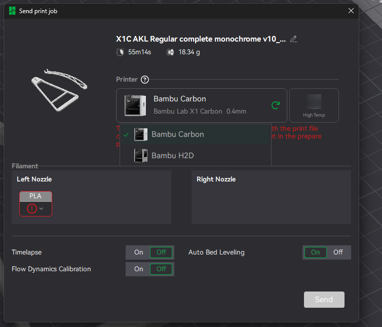

you mean, “you go to Device”
and after choosing H2D go back to Preview and start the print
This is exactly my point.
I know how to do it.
I just wish for an alternative (for me quicker) way to do it.

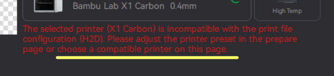

Why are you refusing to select the printer name in the PRINTER window after pressing Print?
You do not, I repeat, do not, need to go to the Device Tab.
For the avoidance of doubt, I have not suggested you go near the Device Tab. In fact, I have repeatedly said not to, so don’t.
Read what I say, do that, don’t pretend I said something else and learn the thing I am desperately trying to yea h you for your benefit and clearly not my health.

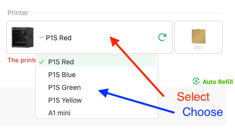

As I said earlier, when you click the printer name, assuming it is wrong, you are presented with a list of all your printers.
  • Select
  • Choose
What part of this message do you not understand?
You can select the printer in the Prepare tab, or you can select it after you choose Print but before you hit Send.
oh, now I get it!
you cropped it so close I did not get… well… the full picture
ok, I can live with it
no buts this time :+1:
:person_facepalming:
I didn’t read the red part through…
Now i feel plain stupid…
It is not obvious from the first look of that window that there is a drop down menu, and not just the picture of active printer.
