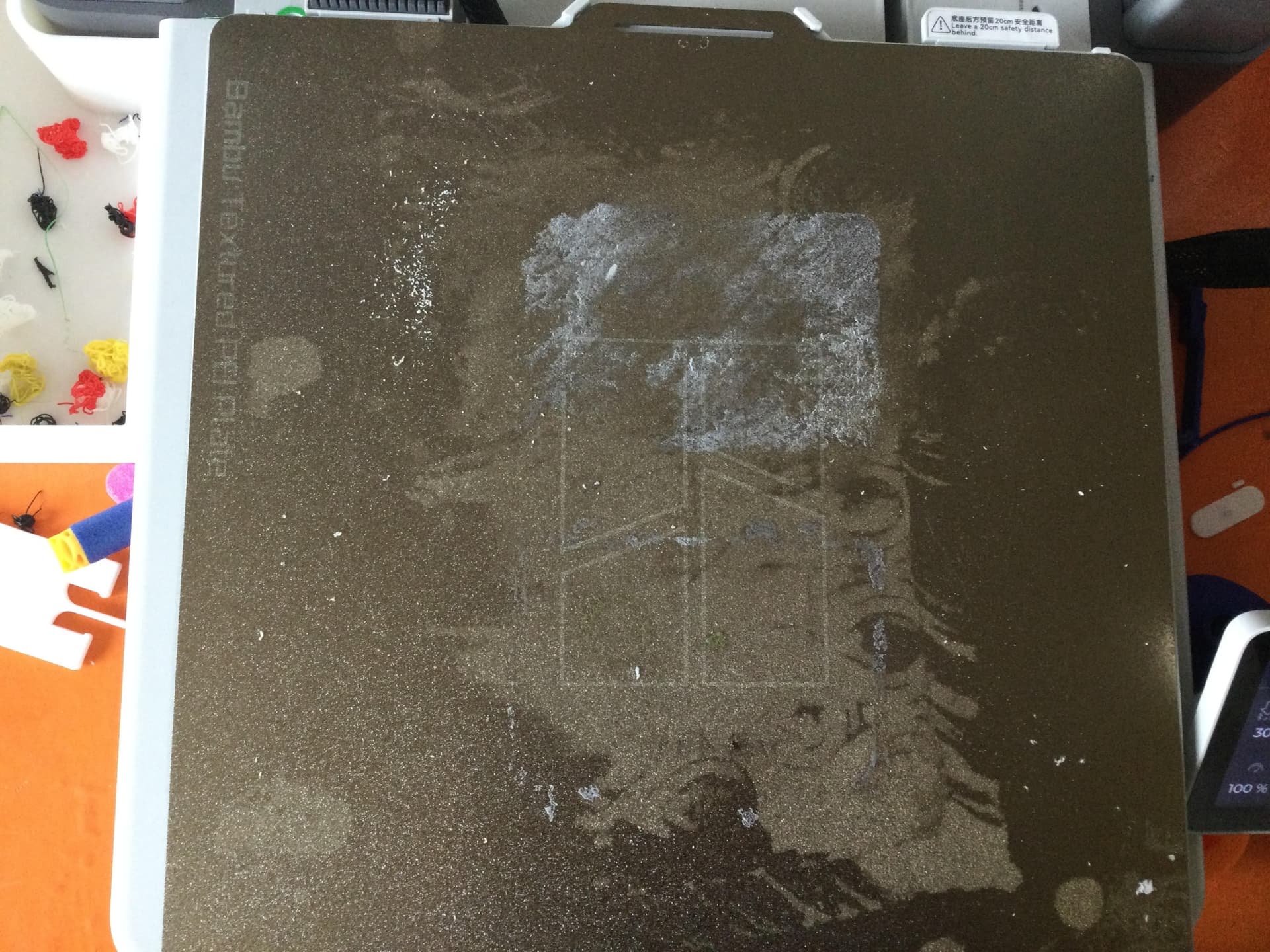

after scraping it over and over again for around ten min in total it still looks like this. I noticed that when I put the plate on the bed and put it on full temperature(100°C) it is way easier but still very hard. let me know if you have ideas to easily clean it other than buying a new plate
That does look pretty ingrained. One trick successfully used in the past is to print another one to two layer flat surface over the residue using the same material.
Once fully cooled (do not be afraid to put the plate in a freezer), there’s a chance to pull some of the residue out with the flat printed sheet.
It does neccessitate the resolution of the wrong nozzle distance problem first though. Hopefully the bed tramming resolved that but should of course be carefully verified.
Furthermore, there are limits as to what can be achieved even with multiple attempts.
It may be prudent to increase the nozzle temp by 5 to 10° for that flat sheet print.

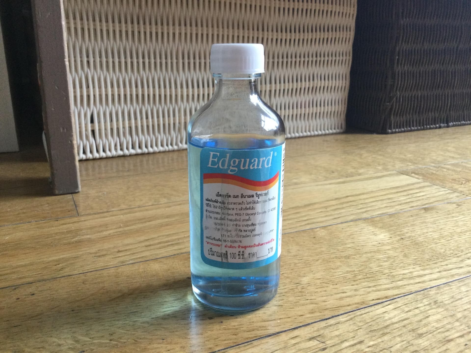

I went and bought acetone but then found out it wasn’t pure
according to GPT real textured PEI doesn’t get damaged from acetone
at first I used this nail remover I found. It turned out to be acetone free.

Be very careful using acetone on your textured build plate. It will remove the painted markings also.
I had to reprint the marker on one of my build plates after using acetone that I thought was IPA.
Now I usually just toss the plate in the freezer then the plastic just flakes off easily.
