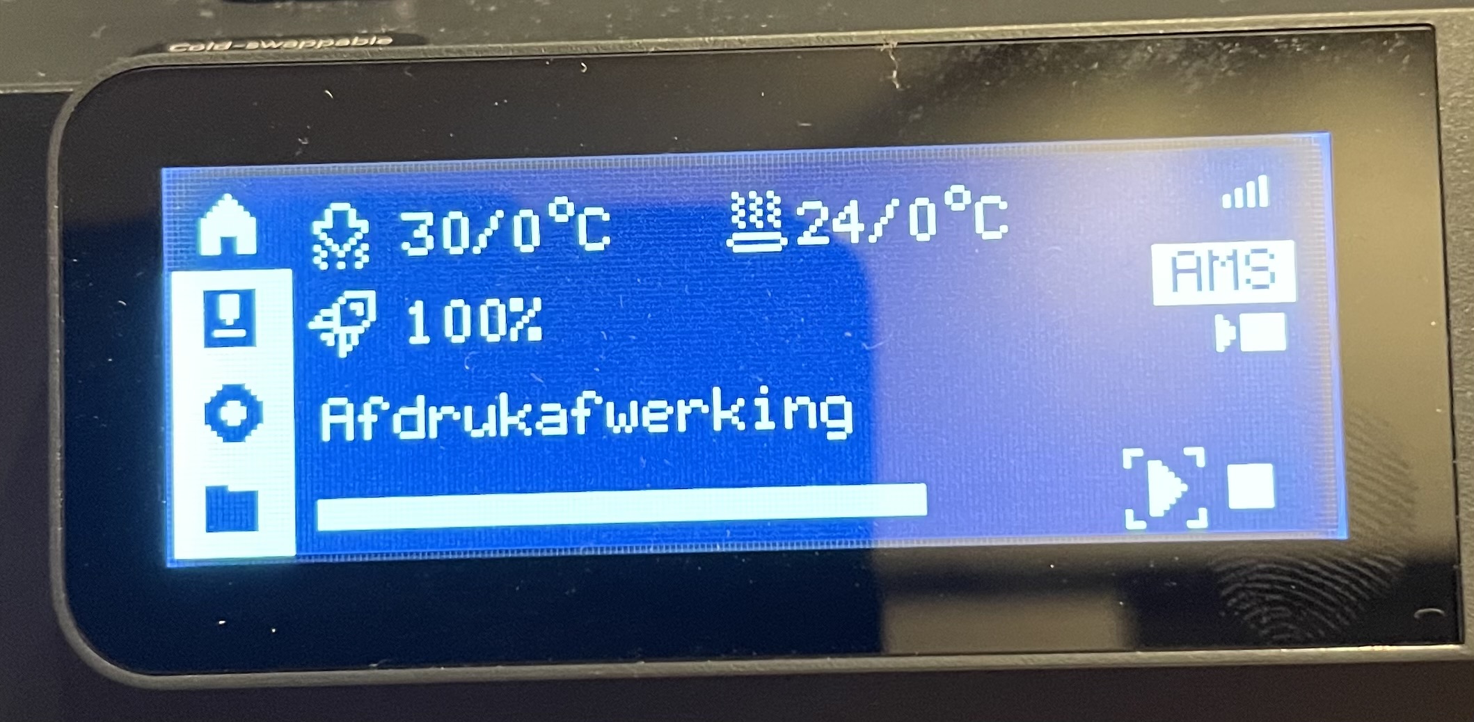

Printer stuck after succesvol printjob
as After I’ve submitted a print job and the printer prints it correctly, it remains in print finishing mode.
I can no longer send a print job.
Bambu Studio indicates that the printer is still working on another job.
After restarting, I can send a job again.
I tried restarting with a new SD card, but unfortunately, that didn’t solve the problem either.
Hello,
Last night I thoroughly checked my Wi-Fi network.
I have a set of Wi-Fi extenders from Deco (M9).
There was an update available.
I installed it.
Then, using the printer’s MAC address, I checked the settings for my P1S.
I changed the network setting from auto to 2.4 GHz so it never has to use 5 GHz.
This seems to be the solution so far.
