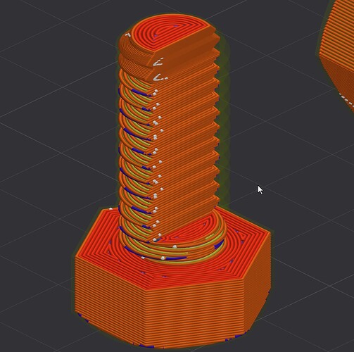

But in that case the head of the bold isn’t anymore a hexagon and that may be problematic.
Apart that, I am rather satisfied by my vertical printed bold and the thread is strong enough for my purpose, i.e. pushing down a spring.
If it is to be hand tightened, you can make the head in a T shape which is perfect for horizontal printing.
If the application only requires low torque to push a spring, you will be fine printing vertical. When too much torque is applied to these vertical bolts, they break just underneath the head.

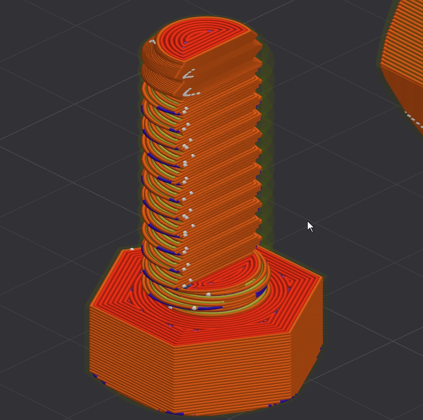

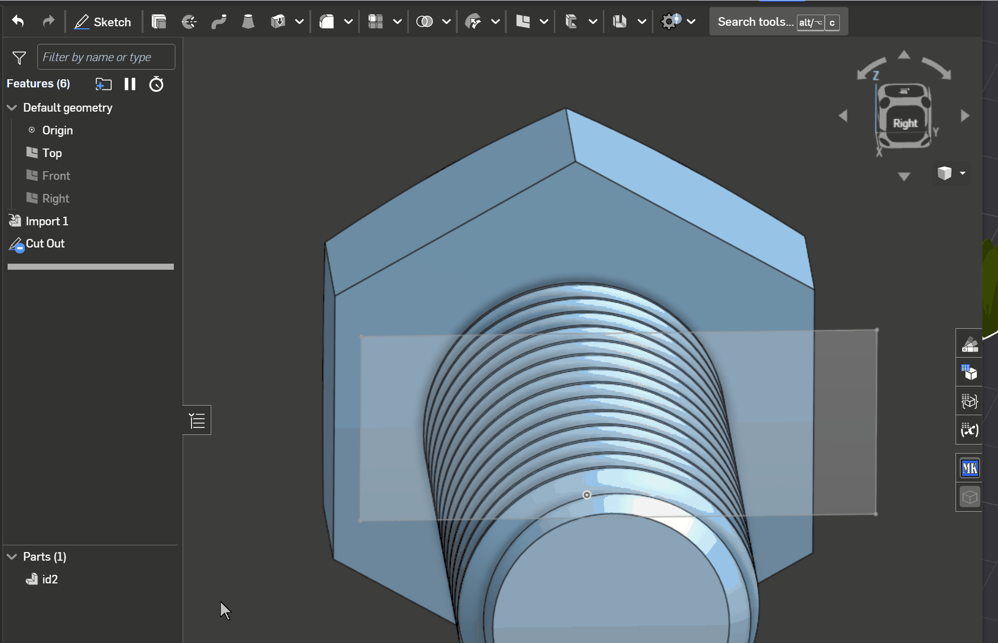

In all fairness, that’s a very simple fix. You can other use a negative rectangle shape or you could use a cube and then boolean union in the slicer or simply cut it in CAD.
Here’s using a negative cube in the slicer:
Flat bolt 2 cut in slicer
And here it is in OnShape:
Flat bolt 2 cut
