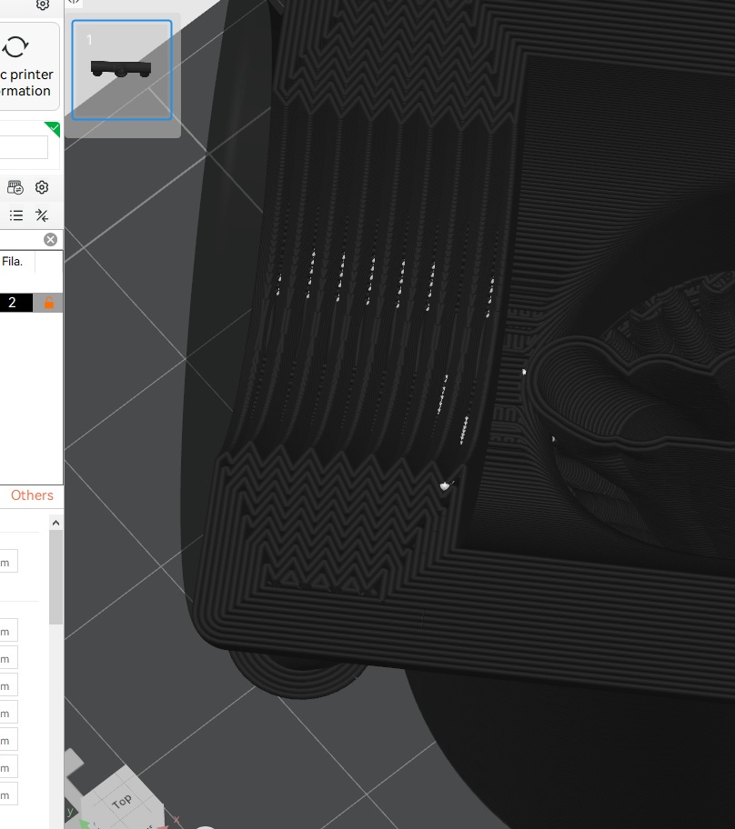

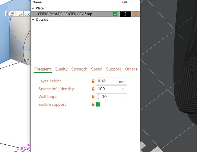

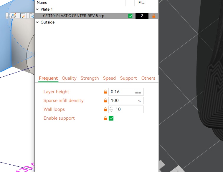

Hey all …I am using a PS1 and tried the density trick…unfortunately the part failed miserably as the video actually didn’t go any further then changing from 15% to 100% …I am hoping someone can share their settings so that I can make this item actually solid all the way through…I am using Black PLA if that helps

Even if you print something with 100% infill (which is all that should be required to print something “solid”, and which is what I’m assuming you’re referencing with “15-100%”), it won’t be waterproof. 3D prints are porous. Not very porous, but they will leak over time. You need to seal them if you want them to be truly watertight.

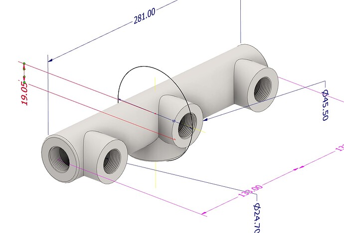

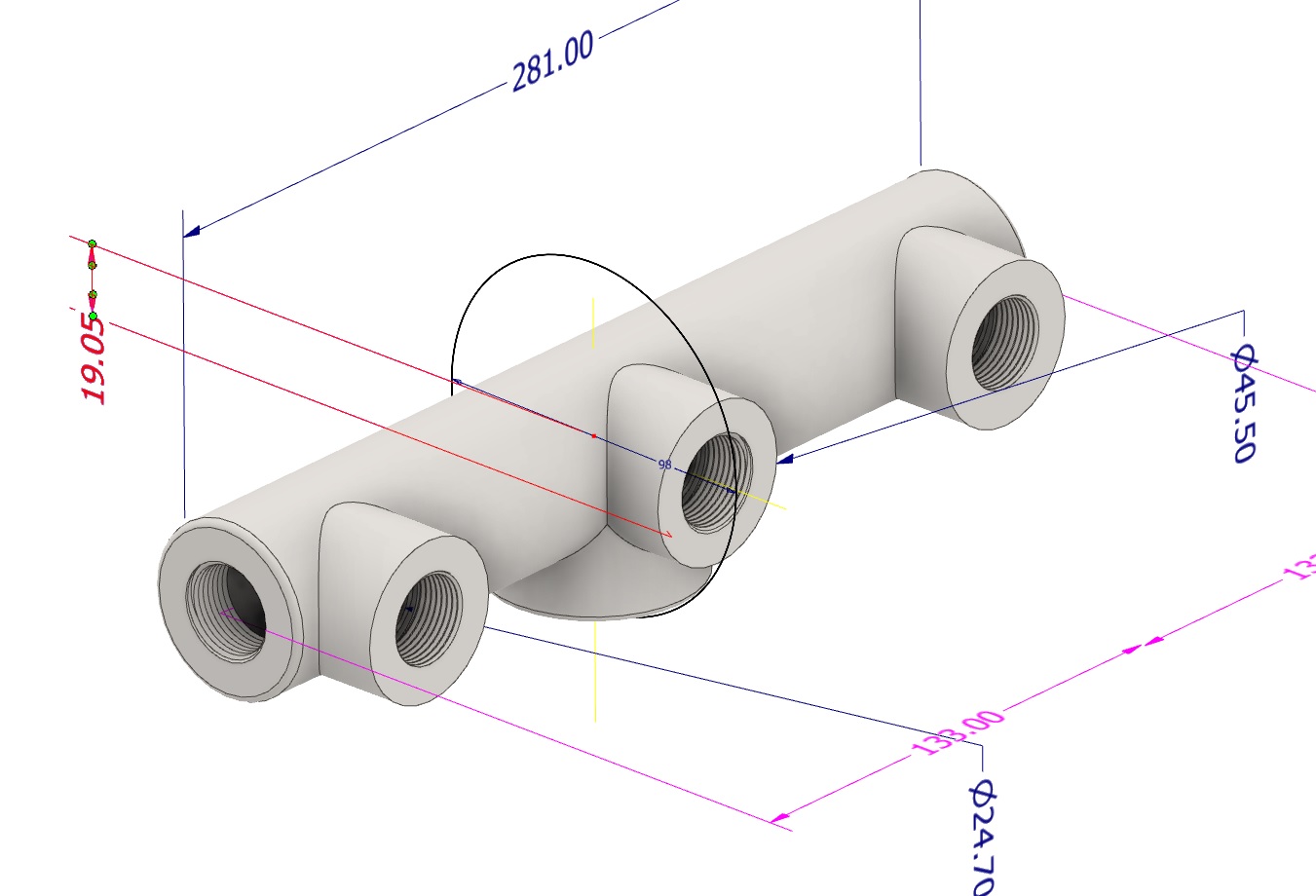

This is the item I wish to make and it does fit on the table on the diagonal
Unfortunately my first attempt had the items leaking air at the necks of this spigots you see in the first picture…The density trick is a setting that was briefly put up as a video that I found on Youtube…my own fault for not coming here to the forum to ask real printers what I should do.
I attempting to make this either water tight at 40 to 65 psi and changing to something that is stronger if necessary.
You had mentioned a sealer …is this something that Bambu supplies or would I need to source another supplier for this?
This is going to be quite an adventure!
Try to design such that an o-ring or gasket will provide your sealing surface, 3d printed threads [especially printed vertically] are likely going to let you down. There may not be enough teflon tape in the world to make that work.
If you print with 6 walls, 6 tops, 6 bottoms, it will give the interior part a good chance of being waterproof. pressureproof? hmm

Due to the process, FDM leads to parts with quite a significant porosity. Last years summer, I determined a 20% difference between CAD weight and actual weight => porosity. In those prints, I used a wall count of 999 to force a solid infill. A deliberate pressure increase by choosing line widths much higher than the nozzle diameter helped a little, but not as much as I had hoped.

Bullocks - I can add an O-Ring surface to the threads on the bottomof them with a few clicks of a mouse to extrude internally and I had actually one internally on the bottom thread underneath(not shown)…I had sealed the entire thing with plugs and o-rings outside initially but was surprised when I immersed it in water to find bubbles coming out at the junctions of the joints like a hot tub jet. Teflon Tape is not an option and sadly gasket sealer will not take ahold either…I will try with more than 6 walls -tops and bottoms as the material in it’s thinnest form is 7mm thick.

The metal part I am replacing is 1.6mm thick and it is tested with air at 85psi to make sure it will not leak, then the air is substituted with Glycol that is around 60 psi and brought down -2 C so that we can cool internal lines that are going to be put through it. Surprisingly enough the threads are 3/4 bsp-14 TPI and the large bore underneath is 11 TPI-these threaded holes are cleaned out with a tap that takes out any material that might be hindering the thread.
