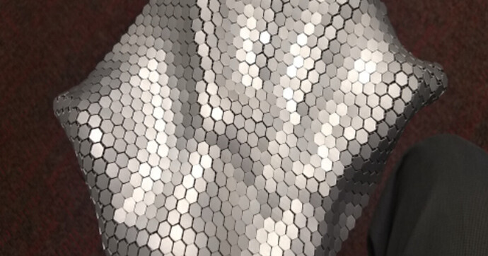

I would look at two different design approaches:
  1. NASA-style printed chainmail / space-fabric geometry
    This uses many small interlinked elements printed in place so the part behaves more like a mechanical fabric than a thin flexible sheet.
https://www.jpl.nasa.gov/news/space-fabric-links-fashion-and-engineering/

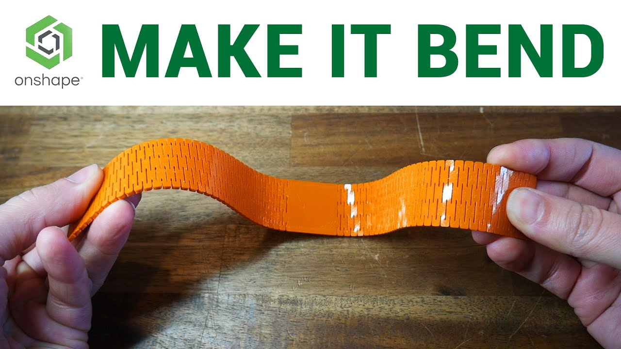

  1. Slot-pattern / kerf-style flexible prints
    Teaching Tech has a good example of using a repeating slot pattern to make otherwise rigid flat prints bend. This is not the same as woven fabric, but it is another useful way to get controlled flexibility from geometry rather than relying only on material softness.
So I would not start by asking, “How thin can I make this wall?” I would start by asking, “What kind of motion am I trying to mimic?” If the goal is fabric-like drape, then print-in-place links, chainmail geometry, or flexible lattice/slot patterns are much better places to experiment.
