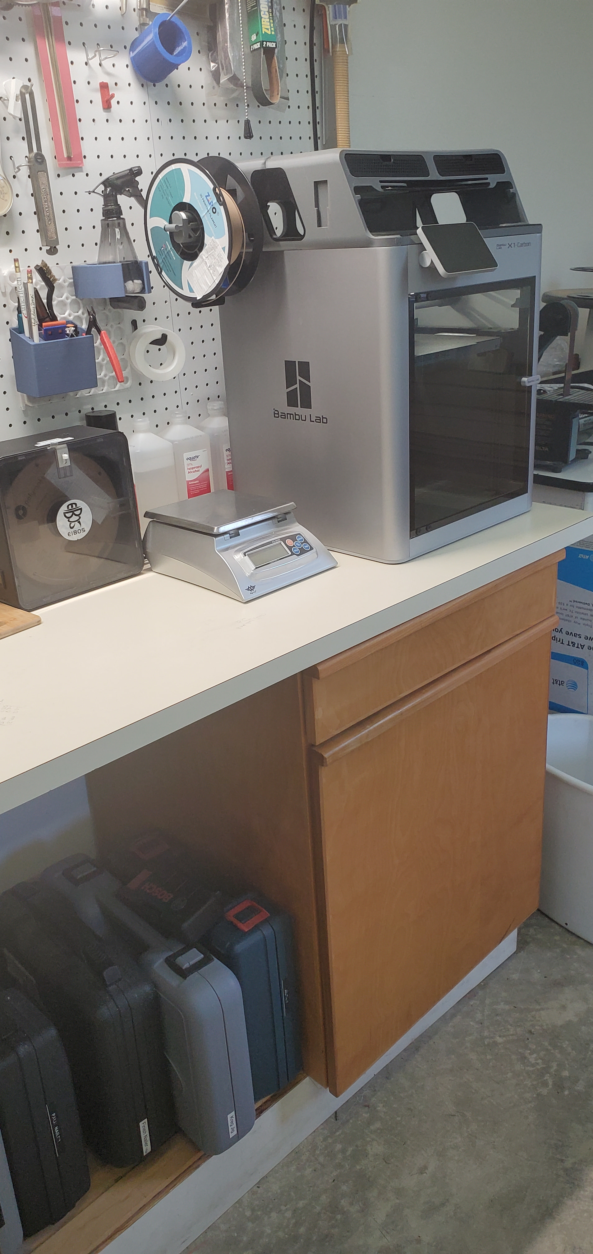

Unless I plan to spend an entire day in the shop, I keep it at 10°C in the winter, and I use my X1C heat bed to preheat the chamber to about 25°C before starting a print. I had a concern that the filament on the external spool might be too cold, but that has not been a problem. The chamber temp may continue to rise during the print, but unless it is a very long print I do not need to open the door for PLA, PETG, or TPU as I do in warmer months.

My X1C sits on a counter top at 36”, leaving the rest of the 8 ft counter for work space at a convenient height. I’m about 6 ft tall, and can easily look through the top glass to view the print, or bend my neck slightly to view the back of the plate through the door. If the printer was at 42”, I would not be able to see into the drawers of my riser.
