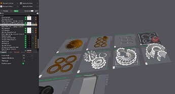

Most of the plates are printing without issue, but I’m having trouble with the Fan stage 1, 2 & 3. The first few layers seem to print ok, then one or two of the blades will detach from the print bed (Textured PEI plate). I have tried them multiple times, moved them to different spots on the bed, etc., but nothing seems to be working. I’m using Bambu Labs Matte PLA and using the profile settings downloaded with the model. Any ideas on what else I can try to get these to print correctly?

Can you be more specific regarding the name? I opened the print file and did not find any Fan stage:
Additionally, some photos are helpful.

See the picture for the exact name and parts I’m having issue with.

Regarding naming, your model differs from the ones (updated and older versions) in MW. I wonder if there isn’t something else different.
Updated model:
Older model:
You stated that the blades lift from the sheet, but, e.g. the “Fan” blades in bed plate 1 don’t touch the bed.
and so require support:
Are you using V2 (updated version)
