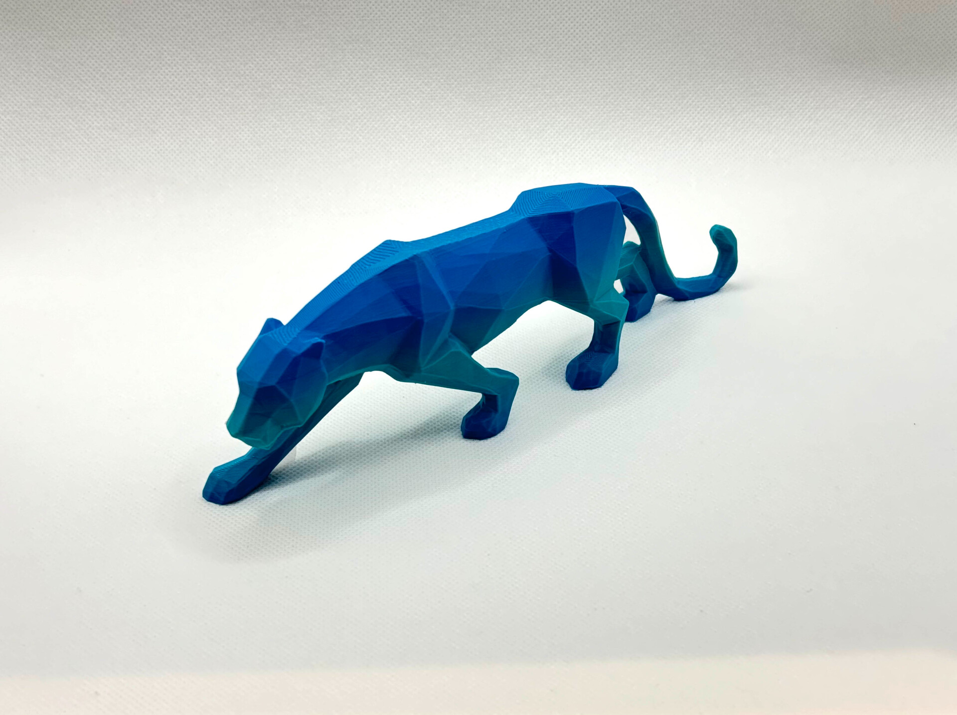

Gotcha, that’s a nice model. What part is failing?
Additional: Looking at the image the creator posted, I never expected, that I have to scale like 700% to get a useful size. ^^

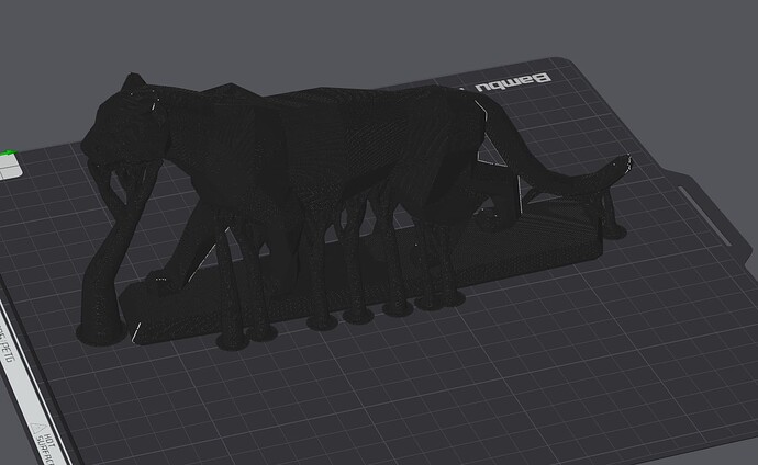

supports are missing. I used auto tree supports with 60 degree angle. Line width was 0,42mm and I decreased it to 0,3mm…
was that maybe my mistake?

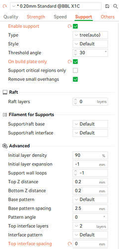

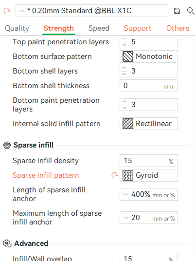

Here’s a suggestion to try. There are several very similar models on MakerWorld. Open one of them in Bambu Studio, right click and delete the model and add your model with the settings from the MW model. Try this one:
Use the 0.20mm standard profile and make these changes:

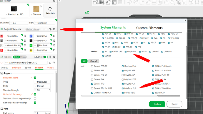

I´m going to start. Nozzle temp and bed heat recommendation? I was going with 210 degrees pla and 55 degrees bed temp. Or should I go with 220 degrees nozzle temp?
There’s actually a PolyTerra PLA setting built in to Bambu Studio. It uses 220 for the nozzle and 55 for the bed. If you don’t see it you might have to add it:
I already chose it. But read that 210 is good for matte effect. I´ll leave it at 220 this time.
