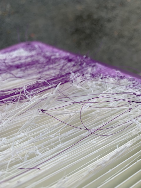

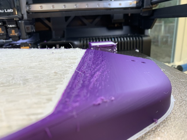

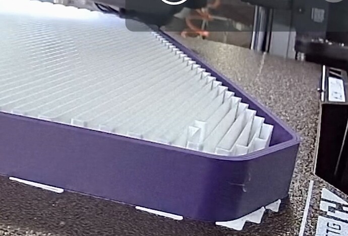

I’m tyring to print a part that fills much of the print bed and has overhangs.
I have been having trouble trying to print with support. The support keeps getting knocked off, causing the me to stop the print.
I tried a couple ways to print- but nothing has worked.
I did wash the plate pretty darn well (I thought) and dried both build and support fillament. This part takes quite some time to print (a couple days) and annoying when it fails after many hours.
I have a very short video of the file so show the problem,
Ideas?

No, it’s not the shake, it’s just the tree was generated too thin and it curls upwards with the improved chamber cooling causing more shrinkage.
Solution includes printing slower on suports, disable chamber cooling, strengthen the tree

Personally, what I would do is go back to normal supports. Tree supports aren’t great for boxy geometries. They can work fine and save filament, but they can also create problems too. I’d go back to a standard support and ditch the trees.
Also make sure your nozzle blocker isn’t bent (just to ensure it not grabbing the structure and causing the fail).

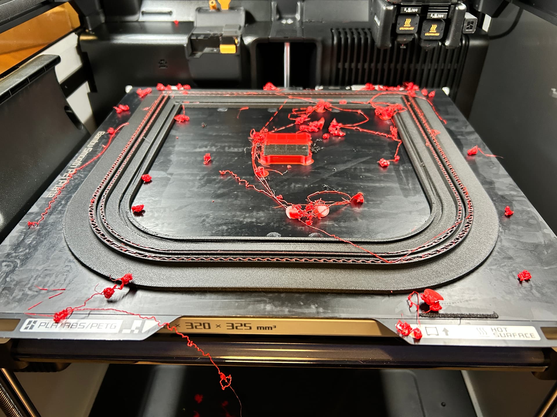

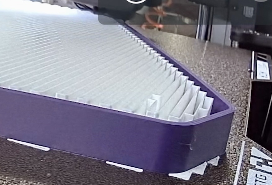

I did some modifications, printed it with the ‘outside’ up, which means a hollow to fill with support.
I used ‘normal’ support this time.

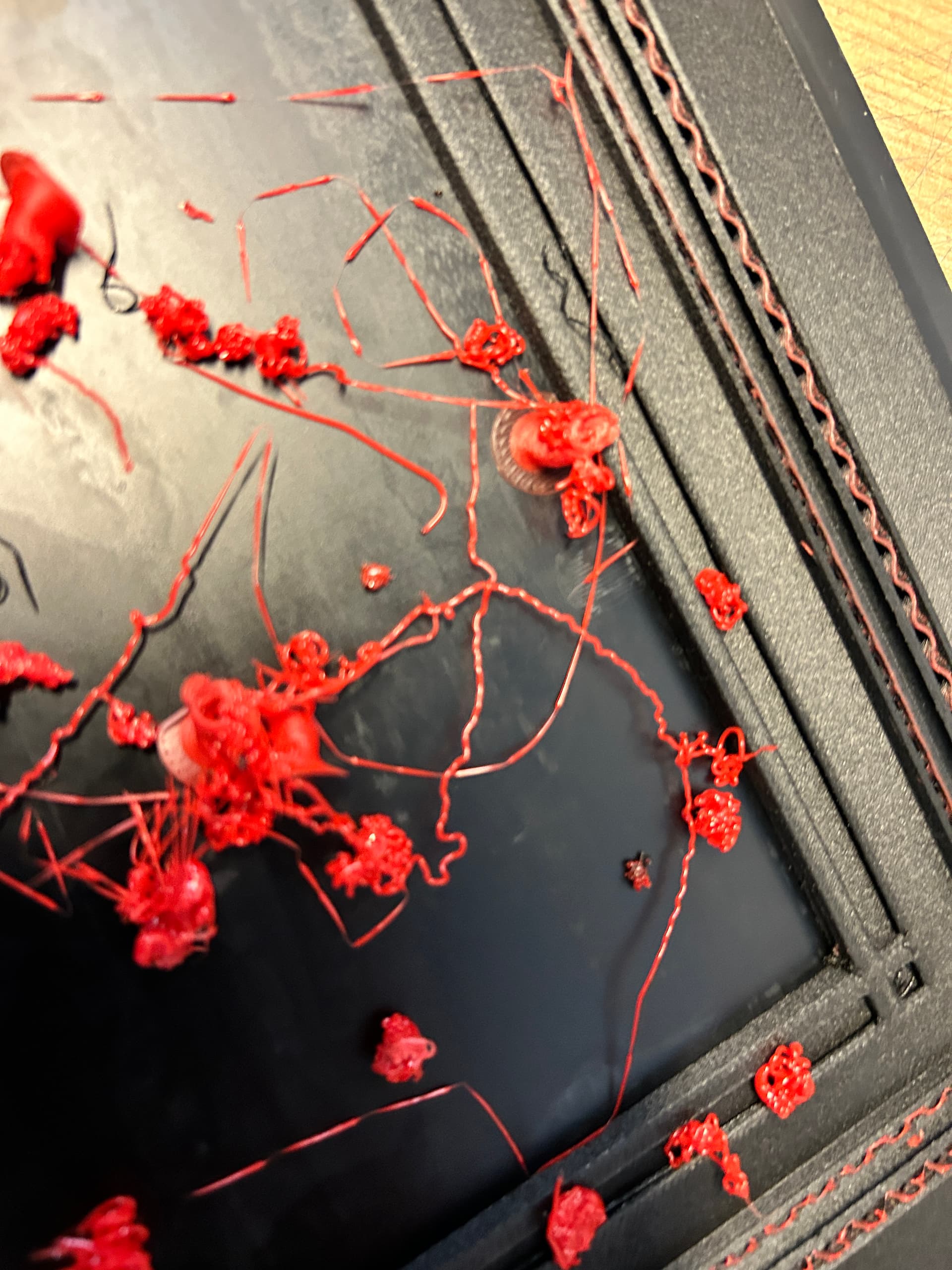

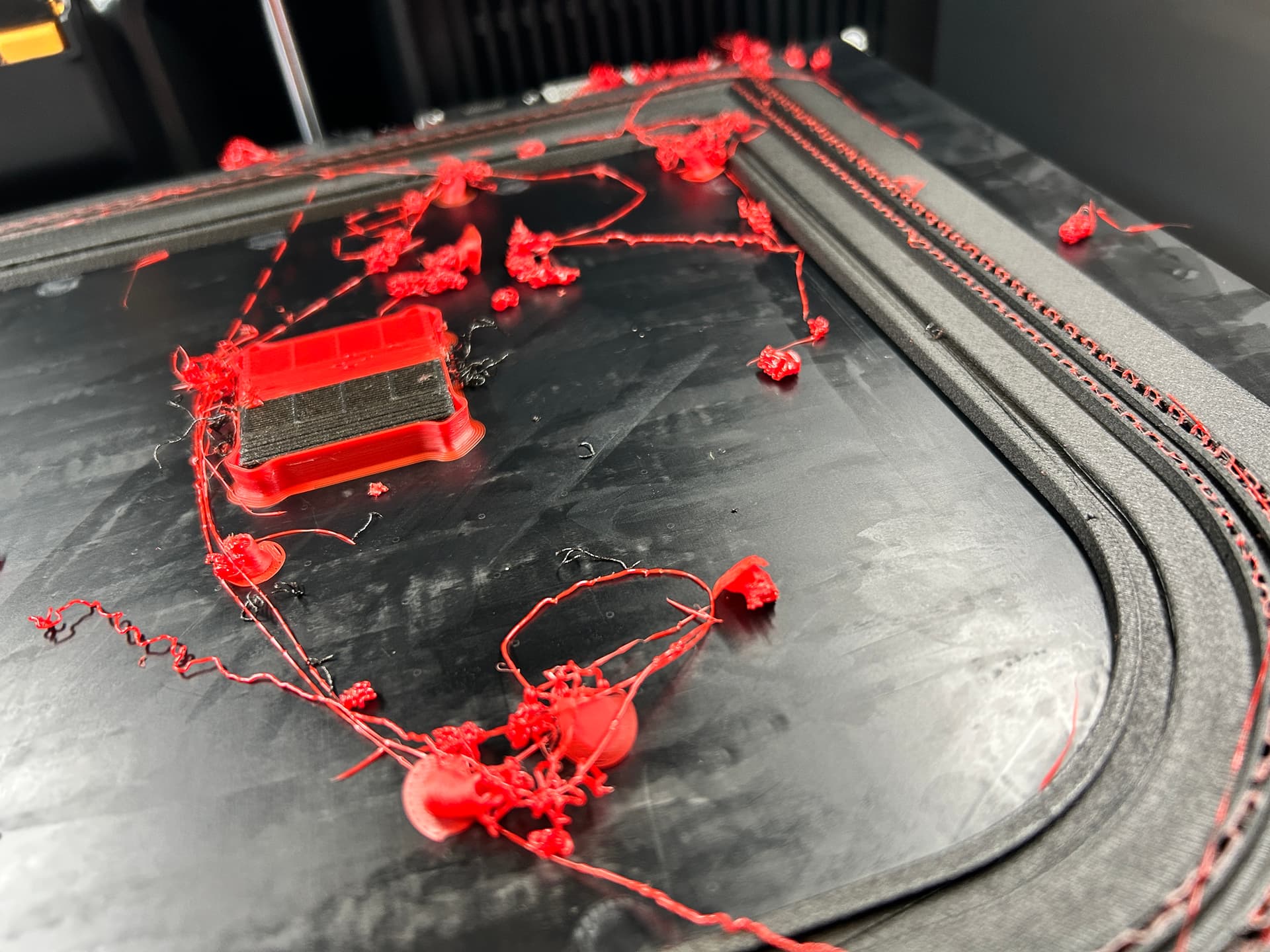

It looked great for about 22+ hours, then started getting mini-spagetti pieces. Later it was just a mess and I finally cancelled it and gave up.
I’ve wasted a lot of $$ in filament and no luck.
I have some video too, but I think this show it.
This is what it looked like before it flaked out. (Sure made a mess inside the printer too).

IMO: Hang up that second nozzle and just send that with regular-ass grid support with a single filament. Reliable++

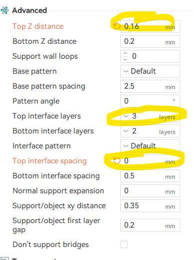

If I may suggest some settings to give a lovely bottom…
If you set 3 interface layers, you are gonna end up with 4 . Check in slice preview. You are getting a support interface transition layer which is probably to be used with dedicated support material, but you can’t turn that off, and I’m pretty sure that’s what is ruing all our supports
I said the same thing, but oddly noone says anything about that

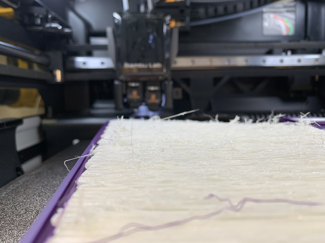

Only use the support material for the interface. This is part of why its taking so long. Also, I only use tree support when normal supports cant be used. Like when the supported area has a non supported area directly below it, the tree support can grow around the lower area. Tree supports are always the ones being knocked loose. Ive also found that adding a brim to the part that is big enough to also connect with the support brim, will help stop tree supports from being knocked loose. Basically anchoring the support bottom to the part bottom
If it grows and isn’t uprooted for some vague reason which happens in about 7 out of 10 of my prints using TREE supports then maybe it survives. But more often than not trees just get destroyed. Normal supports aren’t much better: either they shag or the supported layer simply won’t adhere.
I’m not using a dedicated support material; I’m printing supports in the same ABS as the part itself. At this point I’m strongly convinced the issue isn’t my printer but the slicer. Specifically I believe it was designed and coded with the assumption that you’d be using a dedicated support material.
I came to that conclusion after watching how the slicer generates supports especially that uncontrollable and always present “support interface transition layer.” Why would we even need a transition layer if not to “save time and purge leftover pure material” while switching to a dedicated support material?
