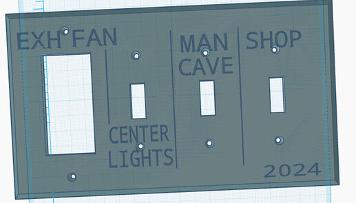

I have used wood PLA for a few of my projects and still have some in the back of my cabinet. What I can tell you is that a LARGER nozzle is a must. Two things happen with that type of filament: 1) it clogs quite easily with smaller than large nozzles. 2) The filament will burn at high nozzle temps, which will add to the clog issue. What I have found is that wood filament doesn’t hold it’s shape very well. I printed some wall switch plates with it, and after about a year, they all cup outward. I thought it was just being overtightened, but additional trials proved that to be wrong. It does have a cool odor, as a wood working hobbiest it fills that bill nicely.
I’ve seen store bought flexible covers do that as well and drives me crazy. I know they crack easily but I still prefer the hard ones and don’t get me started on screws not being vertical.
Thats an OCD track that I refuse to go to!, Even as OCD as I am.
Here’s a snapshot of how I have done many of the special wall plates in the wood shop I built. This is where I wanted to make use of the wood filament - kind of special in a woodshop, don’t ya think?
