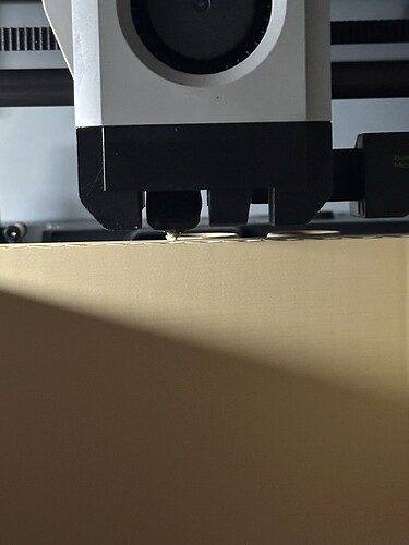

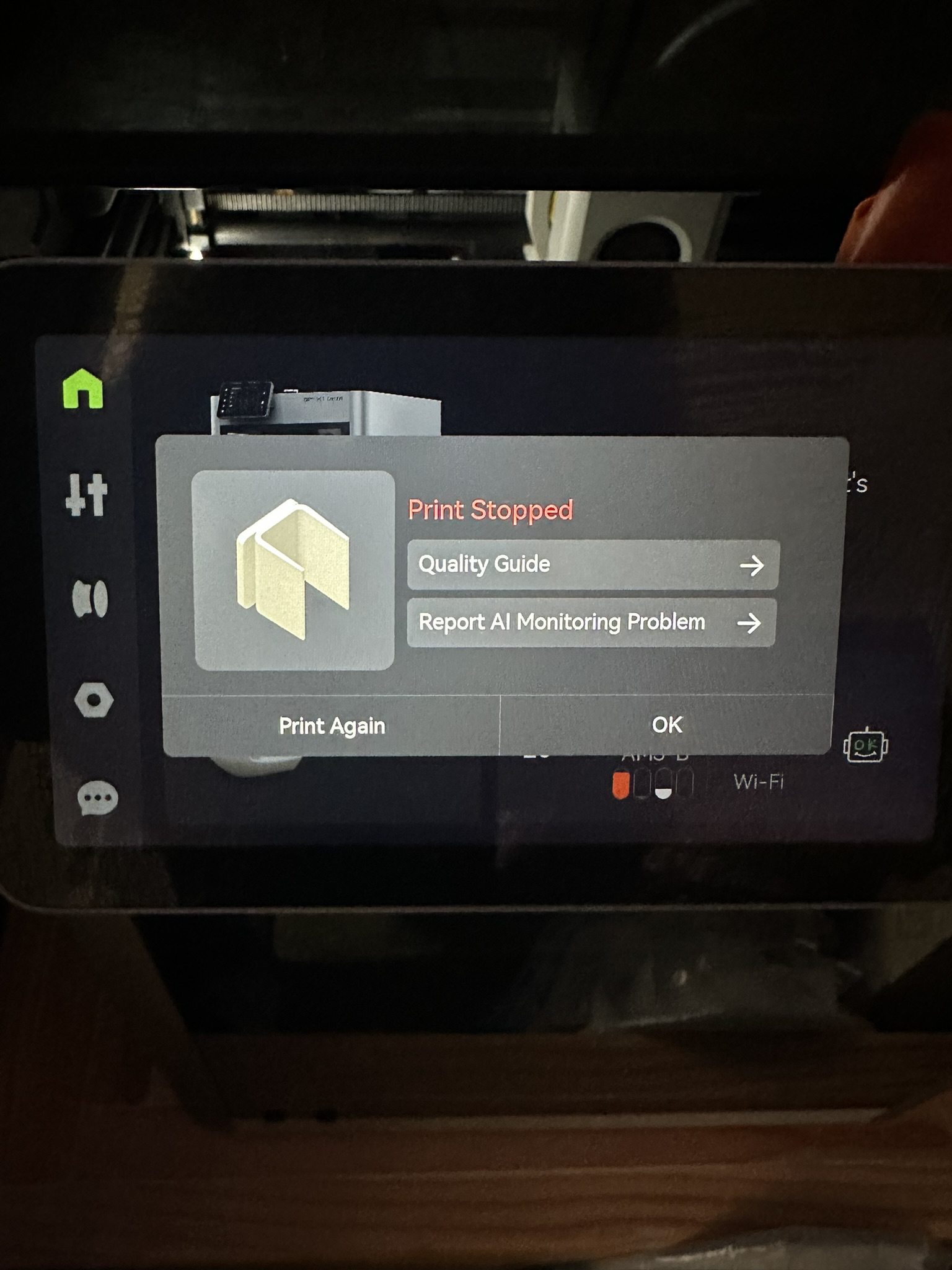

After 10+ hours (in 16h print) the printing stopped suddenly with a message “Printing Stopped”. No fans running, the chamber light turned on. No way to resume the print. Did print this model 4+ times without any issues (with older firmware). It does not seem there is any extrusion issue looking at the nozzle… The Bambu Matte PLS filament was free, not tangled. Fed from AMS.
Ran the 1.10 Firmware update right before this print. Ran full calibration after and rebooted the printer.
Never happened in the past 1,500 hours of printing.
Ideas, please?

Did you just leave the printer in that state or have you since printed? It looks like the printer threw an error of some sort, without more info, hard to tell what is happening.

Looking back through the thread, I don’t see that you have tried Restore Factory Settings.
(Settings > General > Restore Factory Settings on the printer’s touch screen).
That has been known to correct weird problems, especially after a firmware change. It will also erase any calibration values stored on the printer, so record those first if you can.

This is what I tried -
  1. Roll back to 1.09.
  2. Reset defaults
  3. Offline upgrade to 1.10
  4. Reset defaults (stay offline only)
  5. Run full calibration
  6. Test print a tower with 1250 layers
So far so good. I have now started the print again I’ll update you all on (1) how the print went and (2) once I hear from Bambu Support on what specific issue stopped my print (they have the logs) and which version of the firmware will fix the “stopped without a reason” dialog.
