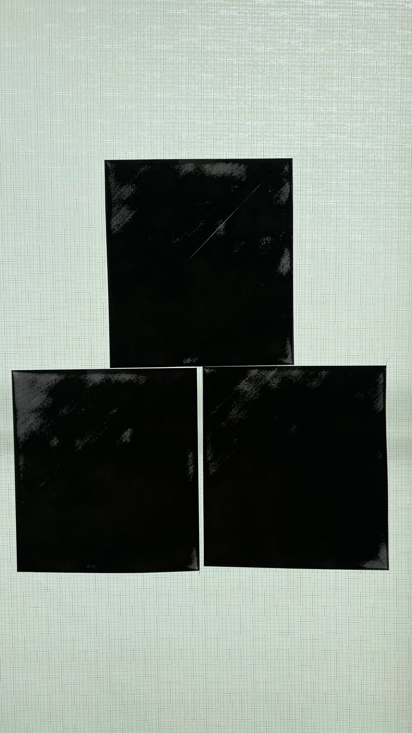

Hello! I’m having a printing issue. Photo shows a print with the same PETG plastic, after a factory reset and with all calibrations. Flow dynamics: automatic, k=0.026, k=0.055. I dried the plastic for about 6 hours. I thoroughly cleaned the plate with cleaning solution. I’m printing with the main nozzle. What’s causing the print quality?
get another roll from bambulabs and test again, you cant base your diagnostics on only 1 roll.
Try manual bed trim, then full calibration again. Use another spool of filament, PLA on example. Regarding cleaning solutions, for me simpliest methods is giving me best results with first layer - liquid soap and a good scrub with kitchen brush. Looking at picture, it’s almost purley bed calibration issue or plate not perfectly cleaned in problematic spots.
Changing the plastic and cleaning the plate didn’t help. Apparently, the table or plate is crooked. I don’t understand why calibrating the table doesn’t help.
Did you do a manual bed leveling? It’s worth a try.
Thanks for the tip. I adjusted three screws as instructed, calibrated the bed, printed, and the result was better (photo). I decided to try again, turned on automatic alignment before printing, and the print turned out just like before. Maybe the issue is with maintaining the bed height?
Yes, this can be the issue. To be honest, it’s hard to print first layer without any errors, one after the other. I’ve had mixed successes with this on all my Bambu printers. If there’s no visible warping on edges, it shoudn’t affect the outcome.
looks like a pattern, most likely your bed, check to see if the screws are evenly tightened on the 3 screw rods.
The screws are tight. They’re actually difficult to turn. It takes a lot of force, not like the video shows.
Try to drop the flow rate to 0,94-0,95. It helps in my case.

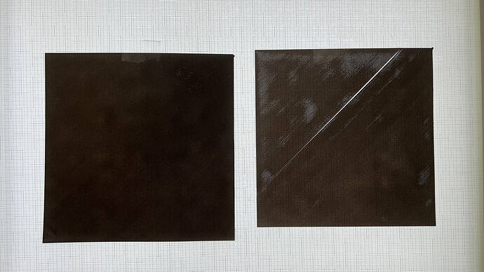

I adjusted three manual calibration screws, and the result is on the left (excellent). I saved the settings. Then I printed and enabled automatic table alignment, and the result is on the right. Apparently, the problem is in the firmware.
Попробуй настройках принтера опустить сопло ниже
How will this help if the settings are reset after automatic table calibration? Each time, the upper left corner is overprinted.
The nozzle height setting is not reset with table calibration. The calibration of the table reveals deviations in the plane of the table, and the height of the nozzle affects the quality of the first layer, if the nozzle is out, then an effect like yours may be observed. Here you can find more details in the section on adjusting the gap. X2D First-Layer Printing Optimization Guide | Bambu Lab Wiki
I did a manual calibration and immediately printed a square of excellent quality. Then I did an automatic calibration and returned to the original version. The photo with two squares is above.
Do you mean manual calibration with screws on the panel?
Yes. I’ll study this now: X2D First-Layer Printing Optimization Guide | Bambu Lab Wiki . Thanks for the link!
