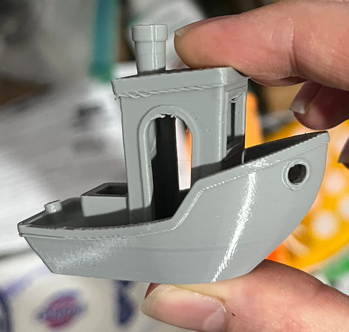

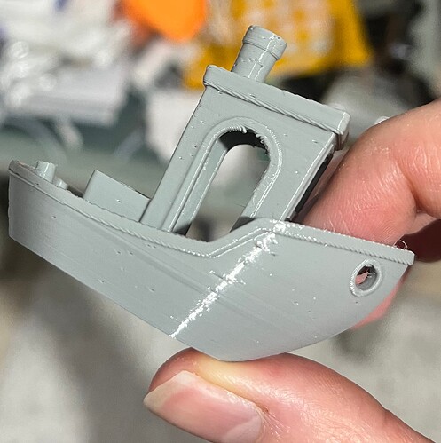

Hi, I used the generic TPU profile to print a benchy and after that reduced the nozzle temp from 240° to 230° and now the prnt has less holes and zits. I was wondering if I should try to keep lowering the temp and also how to do a temp calibration for TPU using Bambu Studio. Also if anyone knows how to do a retraction calibration I would like to know that as well.
Holes like this:
There was many more of them when printing at 240°.

Yeah printing at 220° gave a much better result (except for the overhangs but i won’t print it without supports anyway):

Success!
I was able to get a good print at 230C. Turns out you shouldn’t turn on Flow Dynamics calibration with flexible filament. I was printing with Auto, which means On if you never calibrated before. Only found out after trying to do a manual calibration lol.
