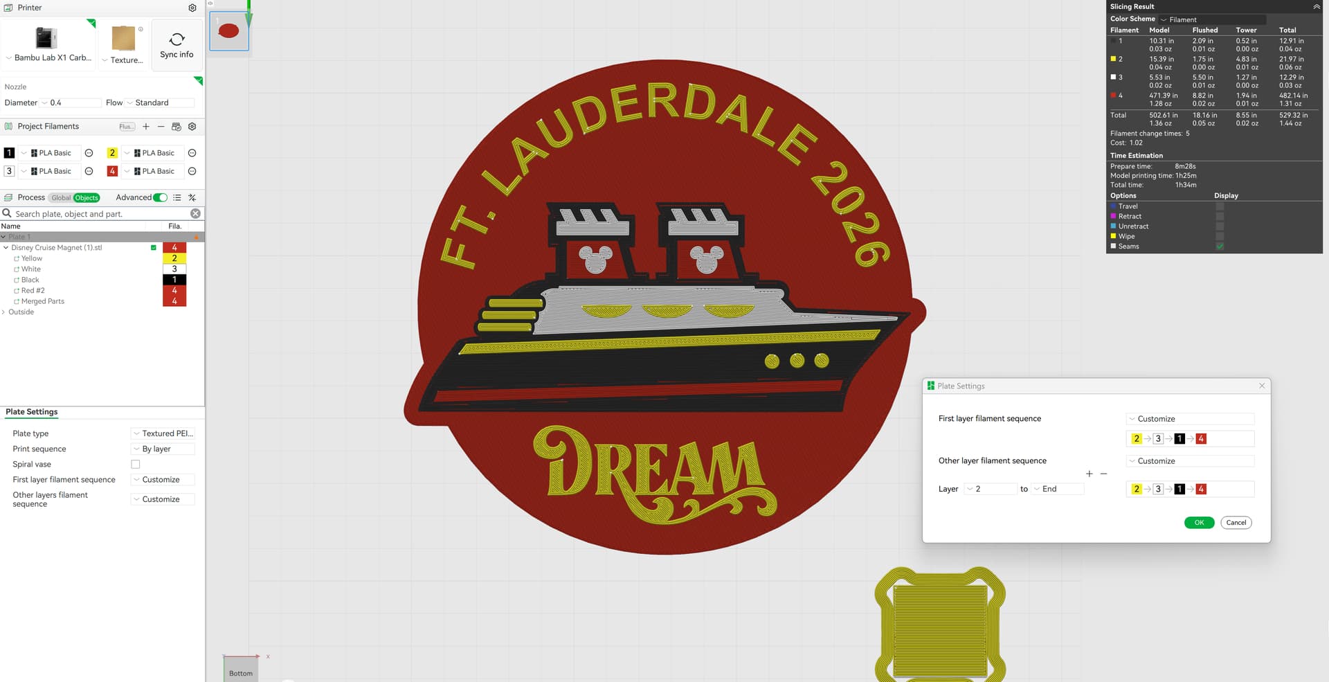

I am trying to make a cruise ship door magnet. It consists of just a few parts and 4 colors. I “think” I have it setup to print yellow first, white, black and red last. When I start printing, it prints white first every time. I have checked and synced my AMS and all the colors are in their appropriate slots. Any ideas what I am doing incorrectly?
Try swapping slots three aand two around on the left hand side panel ,see if its any better ,
Thank you for your reply. I tried that and it’s still printing white first, even though my preview shows it to print yellow first. I’ve synced the AMS as well. I must be doing something wrong somewhere. :frowning:
Have you updated to the latest studio ?
Can you reload the model with its original colour order in the left hand panel ?
Weirdly enough - I was able to get it to print, BUT I had to trick it by swapping the yellow and white filament manually. The machine thought it was printing white but was actually printing yellow. I know this isn’t right or the proper fix and I don’t know what is incorrect in the design. idk
I plan on trying to do several of these, maybe I can get it figured out. Just seems strange.
